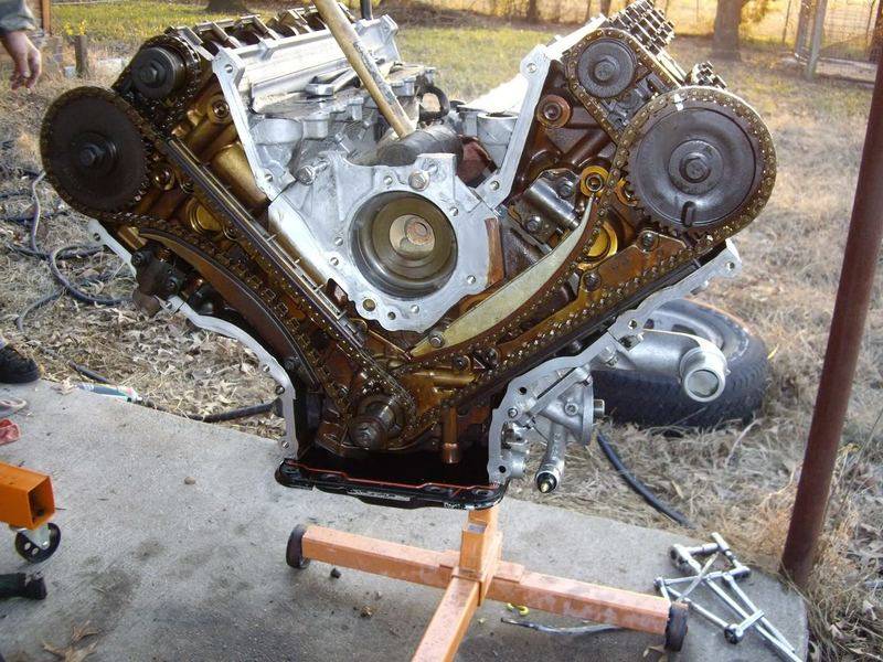

4v heads are notoriously hard to time. If you know the timing is good then you can lock the cams, mark the primary chain and pull it apart to replace gaskets. But if you have no idea what the timing is at then you need special tools and knowledge I dont have to do it.
Cant reuse the old setup even if I could re-time the cams. These motors can only tolerate a few degrees change in the cams before the valves hit. I can see that the passenger intake cam is off about 45* and the exhaust cam can move 20* retarded or advanced cause of the broken/missing key. There HAS to be valve dammage.

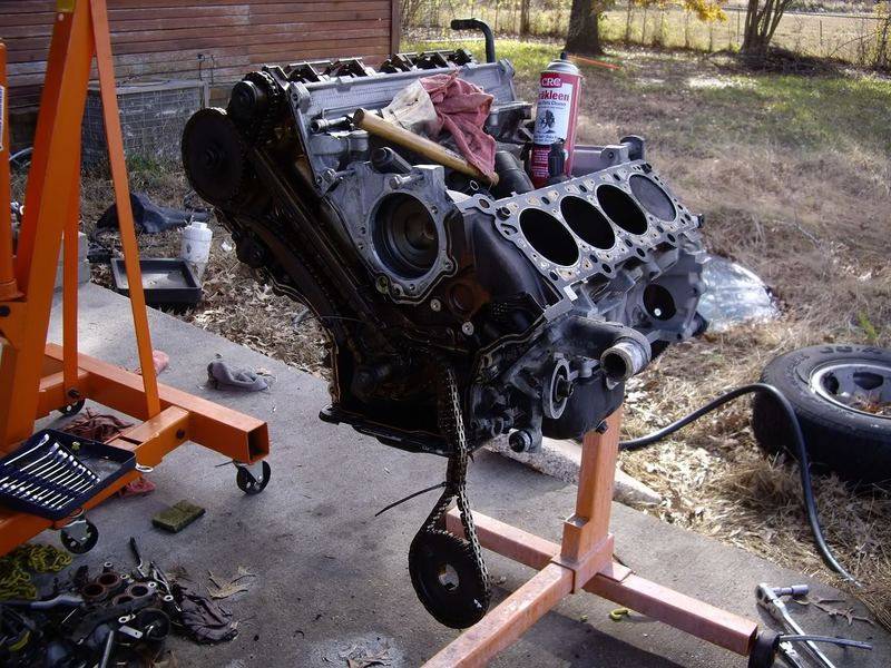

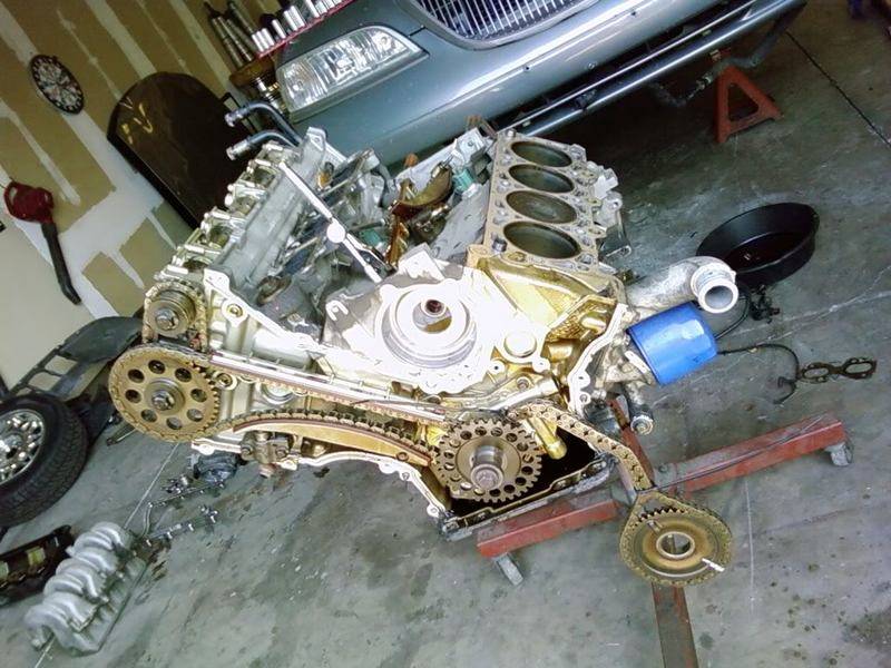

Ugh. Yes I am replacing the head gasket in his old motor. I have talked to you about this Jamie and said I was gonna do it. I would have done them today but he got the wrong cam tool. I was kinda thinking of just using a pair of large zip ties and running it through the secondary chains next to the sprockets. That should hold them still and i can swap them out.
Not gonna do the secondary tensioners as I had planned. The sprockets on the drivers side head have to be removed to get the tensioners bolts off and the chance of hurting the cam or moving the timing is too great and we need this car back running again.
Pretty sure its just his primary tensioners that are the problem. May have a stretched chain but I now have two nice spares.

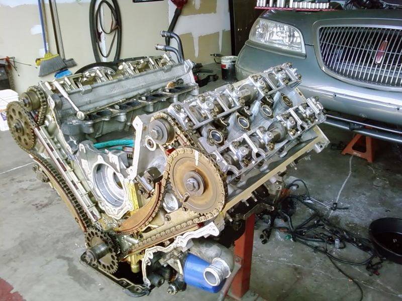

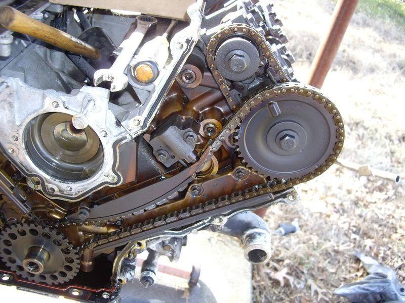

bill you dont need any cam tools if you are only taking off one head, you are not taking the cams out, and you wont be taking the cam chain off, so you dont need the cam tools. i can show you how i did derek's, all you need is someone to hold the wrench on the cam bolt and when you go to put the big cam sprocket back on you can turn the cams to the correct positiong and bolt the sprocket back on with the chain on it already going to the crank, its hard to type what i mean i can tell you on the phone and show you pictures if you want just let me know.
I see what you are saying. Pics would still be cool though.

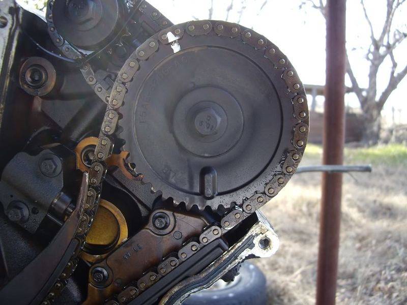

all i did bill was take out the tensioners so the chain was loose, i then zip tied the chain tight around the cam sprocket and the crank, then i turned the cams with a wrench until the two notches in the cams were dead level with the top of the cam girdle then marked the cam sprocket where it was with a paint pen on the sprocket and matched the line up on the head inline with my mark on the sprocket. then i removed the bolt from the cam sprocket and took it off and let it dangle like this...
and after i got it back together...
then removed the head, and put the new gasket and refurbed head on, bolted it back down, then when i went to put the timing chain back on, i swung the sprocket back up to the cam but before i put it back on the cam, i had my buddy matt put a wrench on the other cam and he turned them until them notches were back where they were when i took the sprocket off the cam, when i say turned them, he litterally only had to turn them about an 1/8 inch because when we took the timing chain off the cams sprung back a little from the force of the springs, but we knew this was gonna happen thats why we lined the cam shaft notches up with a refference point first, then marked the cam sprocket for the timing chain, so we could put it back exactly where i took it off. it was very easy, he helped me, but my butthole was puckered up because i never did that before, and i know what can happen when the timing is off, but it went without a hitch, perfect!

So that's pretty much what I was planning except I was also gonna mark the crank sprocket so I could pull the chain. I knew about ythe spring thing moving the cams and thought that's why I needed the cam locks. Didn't wanna tq the head with a valve making contact.
Thanks for the pics.

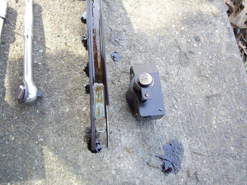

Also found the rattle at startup. The driver side tensioner and rail were worn through and close to failing. Fortunatly I have spares.

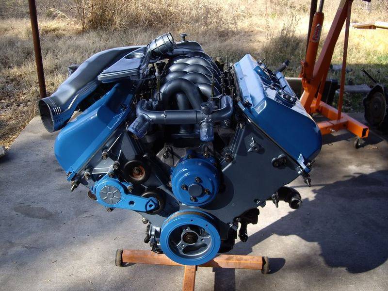

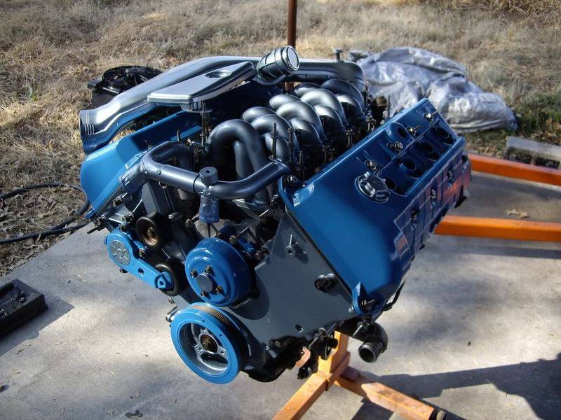

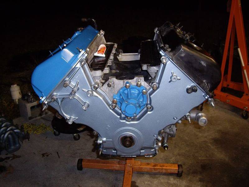

Tried some different stuff with the pulleys and the intake tube. What ya'll think?
Thanks. Would be nice if the bolts got here so I could slap that bish in there! :lol:
