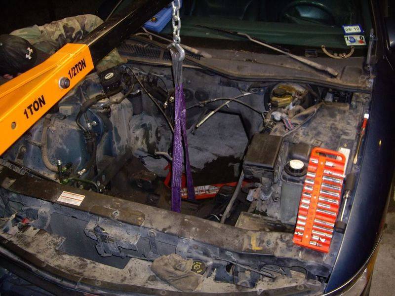

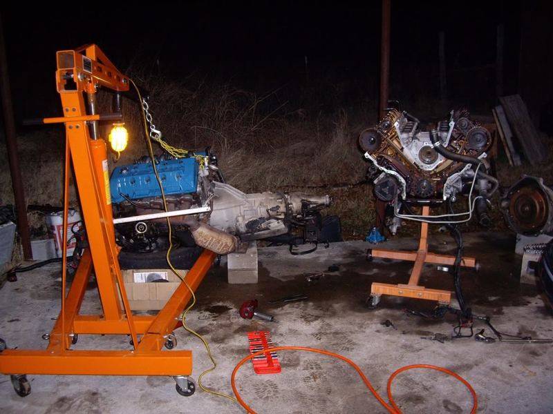

Here are some pics. We are not quite done but tomorrow should be easy. Its taking so long due to how we had to do it. We had to pull the new motor then seperate it from the k-member, re-install the k-member, push the car out, push the new old car in, drop its motor, seperate it from the trans, mount it to the stand, pull all its covers and lines, put them on the new motor then mount it to the old k-member..... ugh.
So here is the new car devoid of its go power:
And the pair of..... messes. The one on the left is the new motor with the old motors stuff on it:

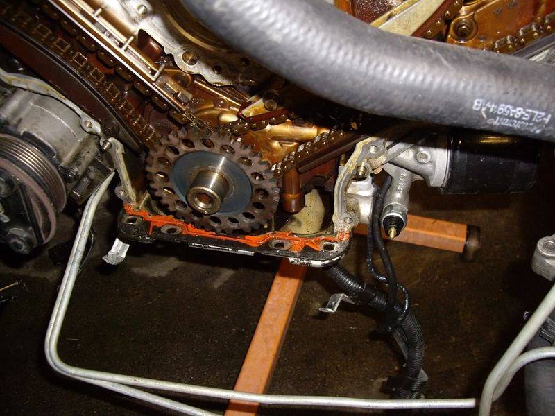

Here you can see the milk shake in the pan. I havent looked in the bottom end yet to see what the dammage is but both valve covers had water/oil where they cover the timing chains. It looks like the passenger side head gasket went. Glad I just replaced the drivers side one. :mad:

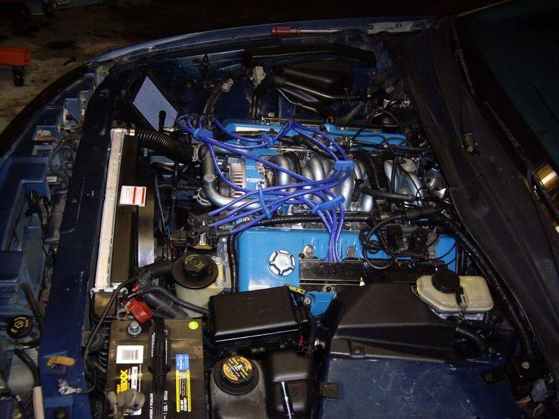

Other than a slight VC leak, shes back to wonderful, idles perfect and feels great.. It's so nice having a nice running car again.. Thanks again to everyone that helped me out!
I'll get some pics up tomorrow
