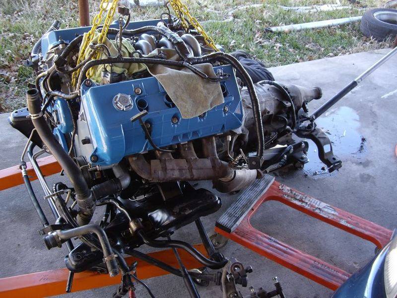

it looks great, but will it run???????????????????????????????????? if not, you can always put a piece of glass on top of it, would make a pretty coffee table lol!!!
Yeah it will run just fine. Just swapped a head gasket.
He plans on a billet cap but the OEM one was broken and the Stant was all that was available and affordable. Was black which looked much worse but meh....... if anyone wants to send Sapperfire a billet cap for x-mas then I am sure he wouoldnt mind. :lol: :p :shifty:
I only ask because I don't know enough about the innards of the DOHC timing setup, but if you went through all the trouble to take the timing cover off shouldn't the chains be changed at the same time? Or do they not stretch like a typical timing chain?

Didn't want to mess with the timing, this is not the final engine...I'll have to get another in a few months...
I just need the car running long enough to allow me time to get another car, so I'm not stuck without a vehicle
under better circumstances, like not being broke, the chains and tensioners would have been changed out, but as it be, someone else was nice enough to buy the TTY bolts that I couldn't afford and was not going to replace
there are many many things this car needs, none of which I can buy yet...along with registration,inspection and a set of tires, getting the abs fixed, still NEEDS at least a left head light...ect ect
Bolts should be there tomorrow fellas. Sorry about the long wait if I knew it was gonna take so long I would have got express shipping lol
Dude thanks again for the help. Waiting is all just part of the game.
the chains in that engine are fine, its just a bandaid repair doing the head gasket, jeremy would be a moron to go throwing new parts into that motor, like he said, all it has to do is get by for now. its rare the chains fail in these cars unless you are running it at the track every weekend and beating the piss out of it. no need to start replacing all kinds of internals on the thing, just get it running and drive it. i dont think you are doing it wrong jeremy i know your situation and you can only do so much!

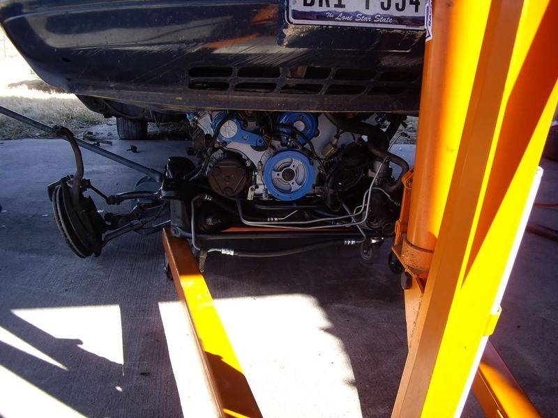

Back to work. All slid in pretty fast and easy..... guess doing it so many times helped.
There was an issue with valve timing, somehow the intake cam moved. So I retimed it and aligned it all back up. Nice knowing how to do that now. Just hope she fires up. :D
I really hate his fuggin car now. It was in the teens all day today with heavy winds so we both had frost on our bodies and it required many breaks. I touch ice on the mufflers and it dont feel cold, that tells me its time to take a break.
Anyway the fugger wouldnt fire up cause his battery was shot. So we throw my new Motorcraft one in there and the engine tries to catch but wont fire. Of course its flooded now and as I pull out the wet spark plugs I notice they dont stink of fuel. I was worried when I had that heavy rain last week that his gas tank was exposed to it. So there was heavily watered down gas. :mad: So we drain the system and try again. Finnaly! There was life! Idled great, reved smooth and is pretty quiet!
Tested everything and it all seemed fine. Had my smart charger try to pulse charge his battery and then we swapped the batteries back around. Fired his car up fine so that was that.
Then....... he gets ready to leave at 4am and as we shuffle the cars around his car stalls every time he hits the gas...... WTF? After a few retries to start it the car goes dead. I tested the battery and it was at 6 volts with a steady climb. Dead battery. So we swap batteries again but the car is flooded and some is still water so no chance of it starting for a couple hours. I ended up sending him home in my car with his dead battery in the trunk.
