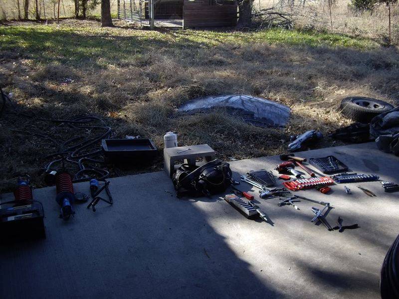

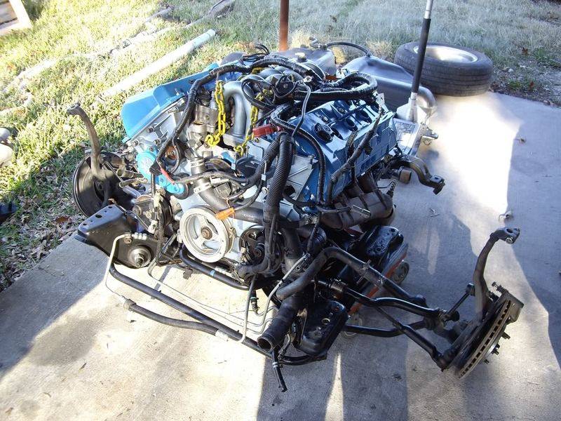

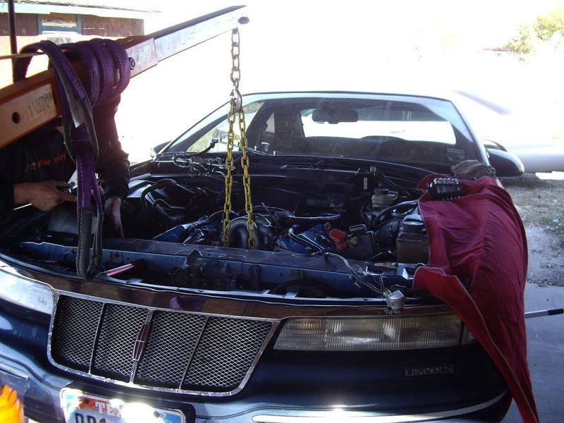

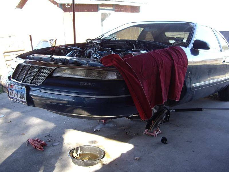

Yeah, disassemble part two. :mad:
So we got it out and apart.
Started to tear her apart:

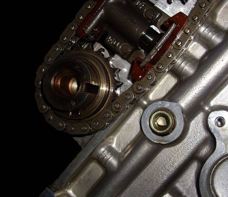

And found out why she didnt work:
Whoever replaced the head neglected to put the key back into the keyway for the exhaust cam. :mad:
So are you guys just going to replace the key and throw it back in?
oh shyt! fail
hope not, too risky. have to pull the head to be sure and thats where they would be with the other eng anyway
I do know that Laser has a set of good heads on his old engine.

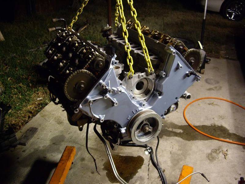

Hope your not going to try and use that motor, 32V is a zero clearance engine and more then likely it sheared the key, if the motor rotated with the exhaust cam stationary you most likely kissed a exhaust valve into a piston. At best a bent valve at worst multiple bent valves and damaged pistons.
That motor is gone today, we will be doing a head gasket on my old motor, cleaning it up and tossing all the painted stuff on it
and FFS!!! Laser no longer has his old motor..that thing has been gone for months..
Anyway, the key was not sheared off, it's simply NOT THERE, checked oil pan, looked in all the little nooks and crannies, no key... Some egg head didn't put it in, I have no idea who did the timing on that block, but it doesn't matter now
