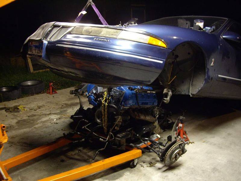

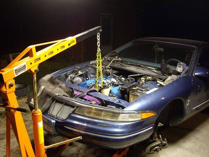

Got her under and then stabbed in. With any luck we will have it fired in a few hours. :)

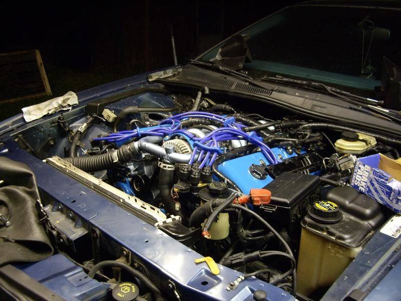

Well its in!!
To focking bad it dont run. Its 5:17 local time and Sapperfire has to be at work in under 2 hours. He lives over an hour away so I loaned him my Mark VIII........... I trust him more then anyone I know but thats my baby and still will be worried about it.
Anyway we got it started but it was running for chit. I couldnt tell if it was a fuel or spark problem cause it sounded like both. I got under the car and we fired it again and I could see there was not much of anything happening on the passenger bank. I know we have fuel and spark. The plugs were saturated on the passenger side though so we swapped in new ones. Still no go. The engine can start onts own and idle but its rough. Real rough.
When the engine was brought home I knew someone had been in the passenger head and am pretty sure it was replaced. Too domn clean compared with the rest of the motor. I know the passenger side head does run a little cleaner but this head looks almost new inside. No oil staining at all, zero.
My guess is that the timing was not set right and that the intake cam is a couple degreea retarded. It gets an occasional fire but not much. I am gonna pressure test it after I get up to see if I can verify this thought. I will keep you all posted.
