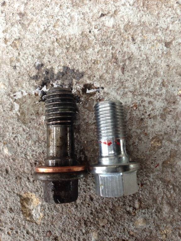

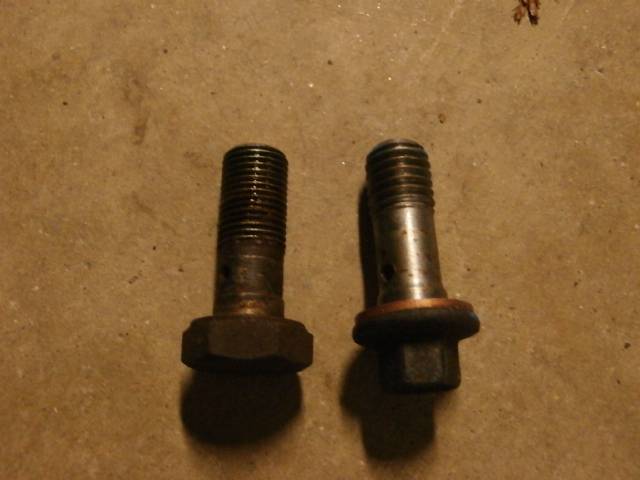

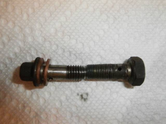

I seem to be having a problem with my banjo bolt tightning onto the caliper. When I put the washers on both side and start to thread the bolt, it doesn't bet tight. It loosens up again. I took the hose off and tried just threading the bolt, it goes in fine, but not with the hose. Whats happening?
I bought M10X1.0. That's the size they should be. Right? The Cobra calipers have a 1.0 thread pitch. The Mark has a 1.5. I will have to tap the whole to us the other bolt. Also, the 1.0 bolt its shorter.
my Cobra (PBR) BB thread per inch > the Mark BB, the shaft girth is also greater than the Mark bolt, but not by 6mm like the bolt head is
Mark on the left, Cobra (PBR) on the right
PBR left, Mark right
I have both sitting downstairs...my used Cobra front calps cam with the BB...cobra bolt socket is 16mm, Mark socket is 10mm
