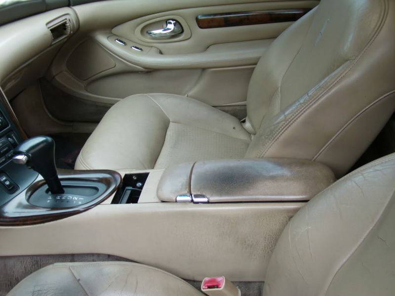

Here's what the interior looks like. Driver's seat is pretty messed up, the seat trim is broken. So if anyone has a seat trim, please help a guy out. :shifty:
A lot of work needs to be done here too. I am planning some type of black/tan combo.
i have that same color interior in my car, and that passenger vent thats broke, is broke in mine too, i cant find one ANYWHERE! :( but other than air bags and what not, if you do get rid of that interior, let me know! might have to work something out! lol
