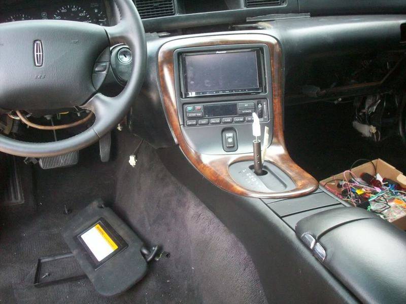

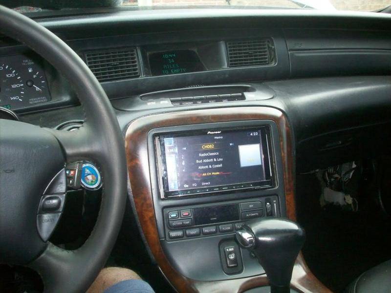

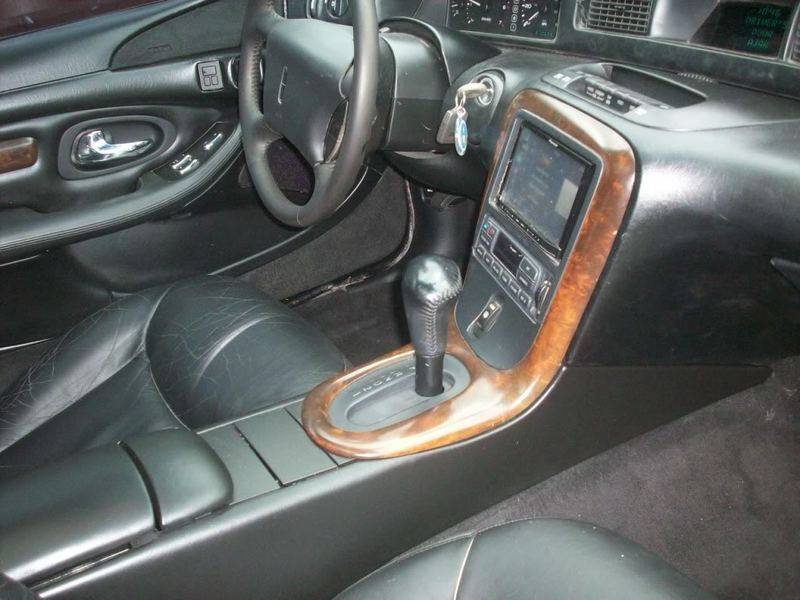

It's been a while since I updated, but I've been steady working. Doing the stereo now. I always go with double din stereos. This question always comes up from time to time whether a double din will fit in a gen 2. It will with a bit of modification.

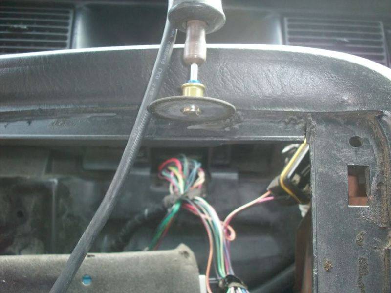

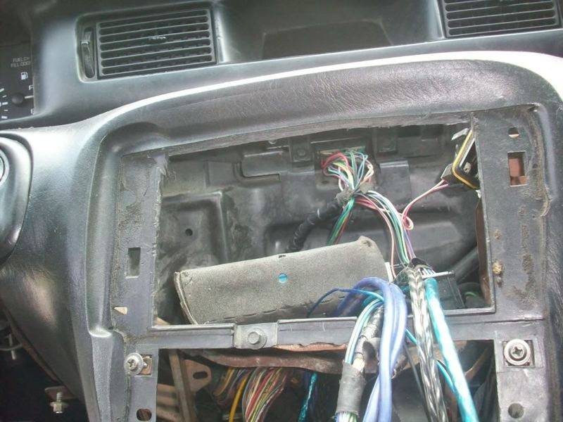

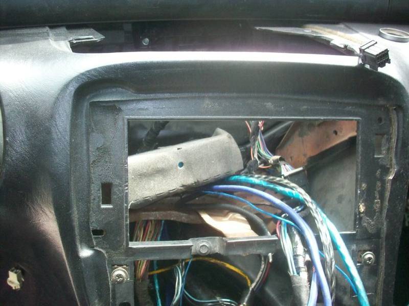

While the dash was out, this was the perfect time to run all my wires for my system. So once the dash was back in, everything is in it's place. As you can see, a double din will not fit.

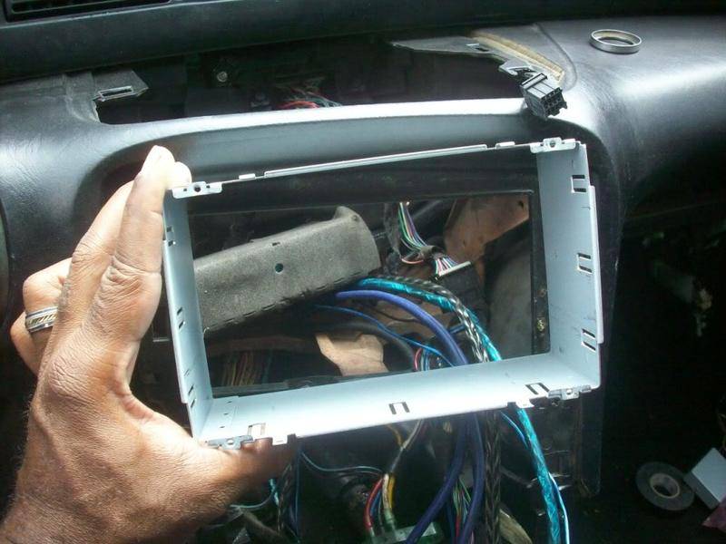

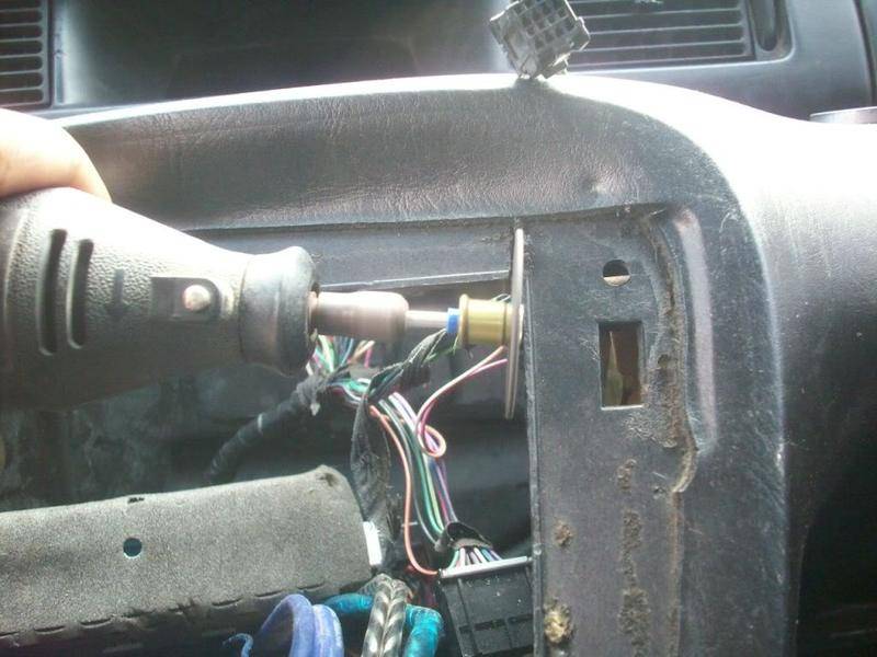

When I do double din installs in Marks, I use a double din cage. I am particular to Pioneer, so I always use Pioneer ADT-VA133. Here's the cage before the modification. I clearly does not fit. :cool:

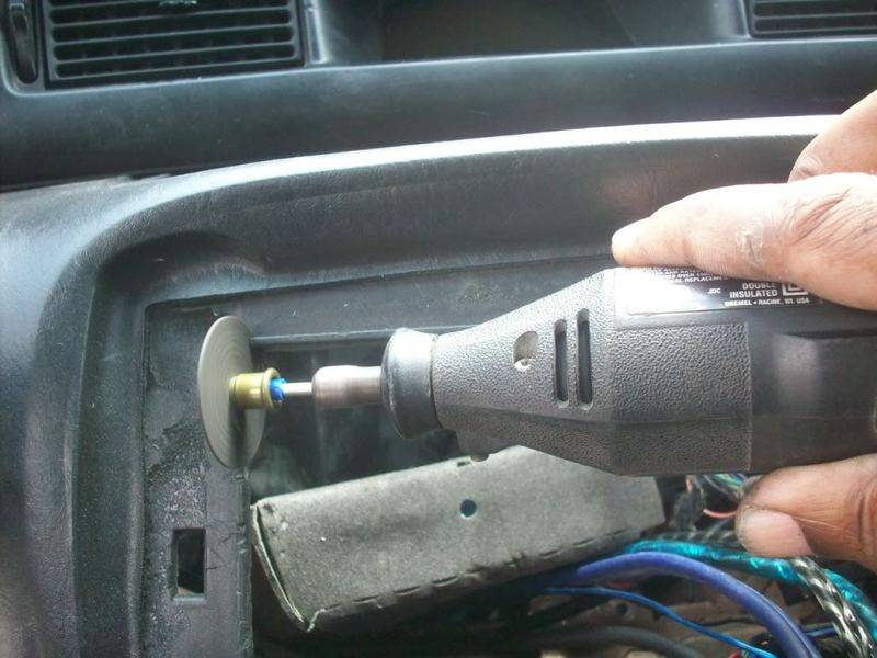

Next is to cut up to the bottom of where I have the marker. This will give the cage enough room to fit.

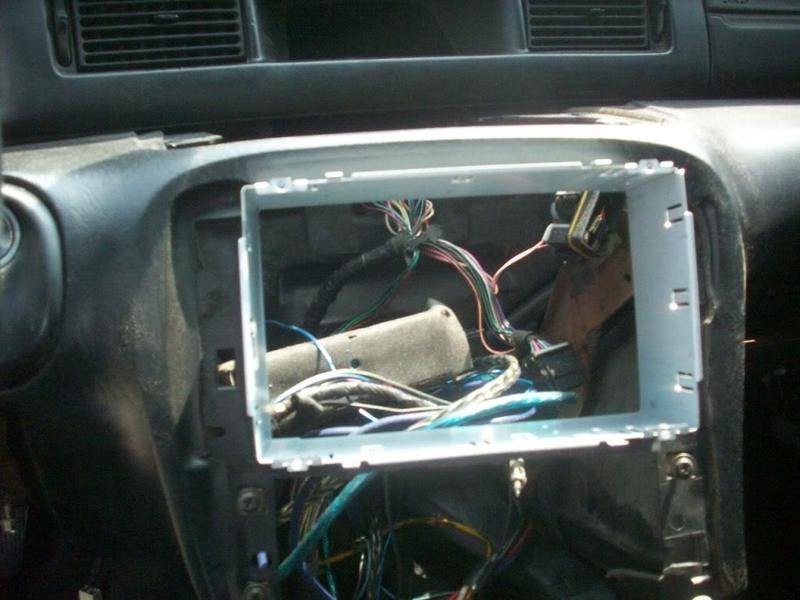

Next, start making your cuts with the dremel.
Once the cuts are made, this is what it will look like, and the cage will slide in and fit pretty snug.

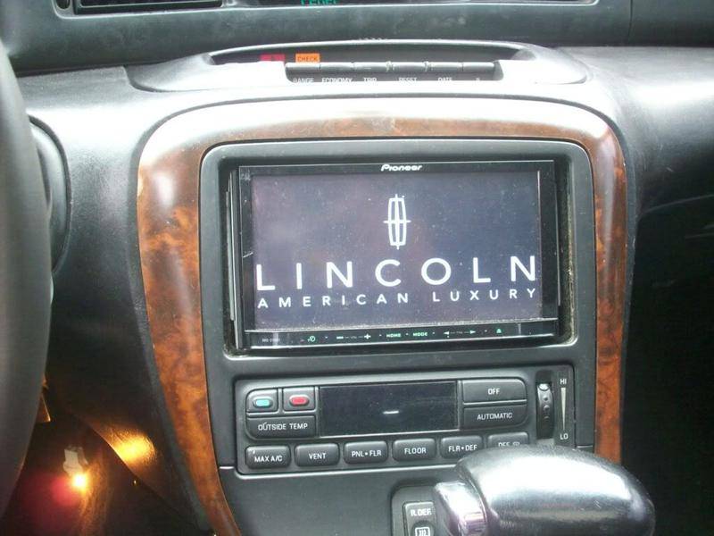

I wont go into connections or anything like that, because if you are undertaking this mod, you should already know what you're doing. :rolleyes:

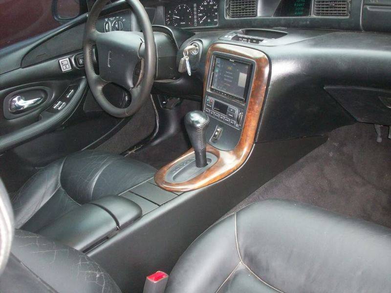

So anyway, when it's all said and done, this is what you'll have. a nicely fitted screen. Mine is Pioneer Z130BT.
Nice write up looks very clean, wish I had a head unit like that.

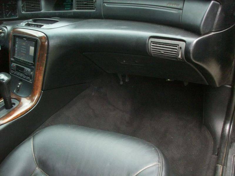

Here are a few more interior pics. The interior is pretty much done now.

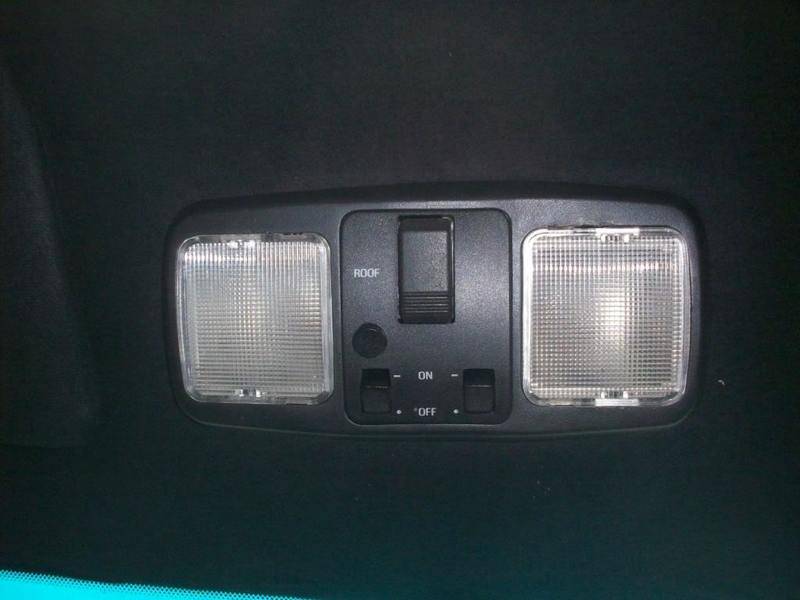

Notice my sunroof switch. I put the microphone for my Bluetooth up there.

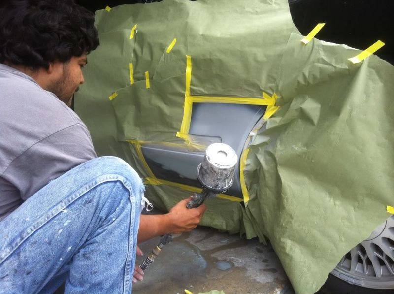

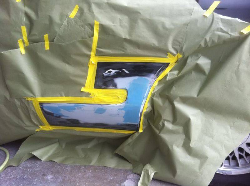

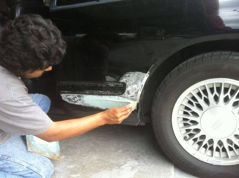

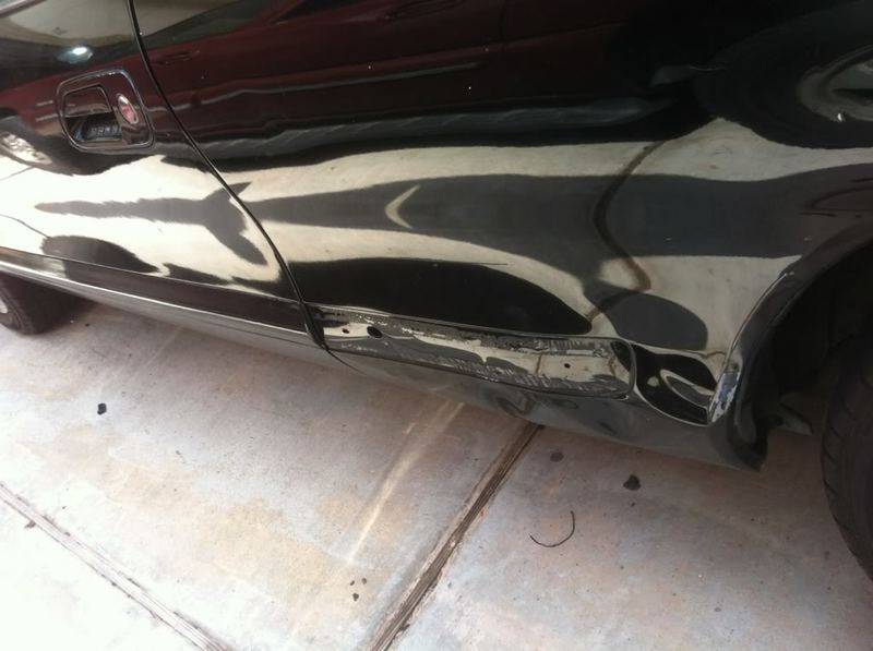

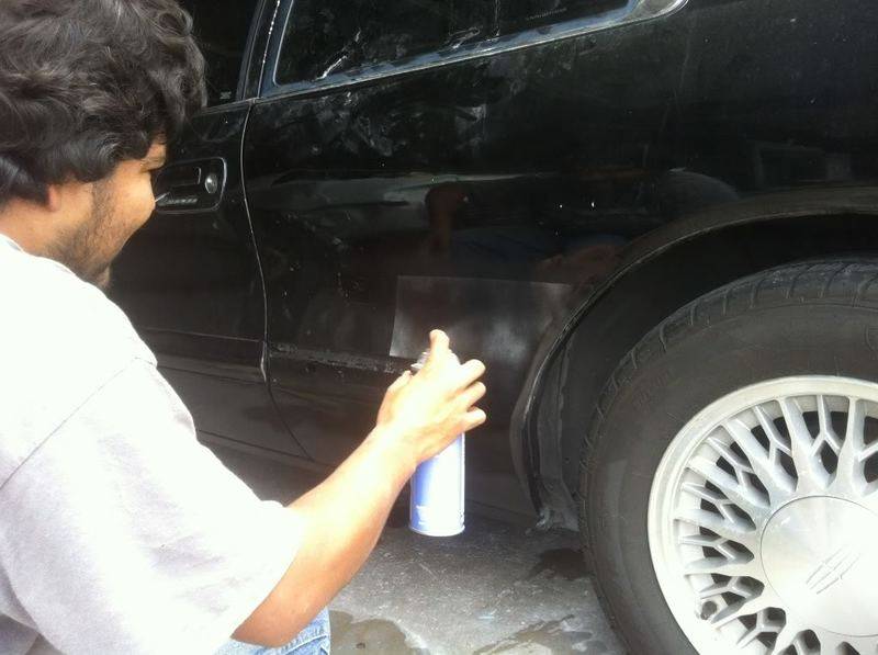

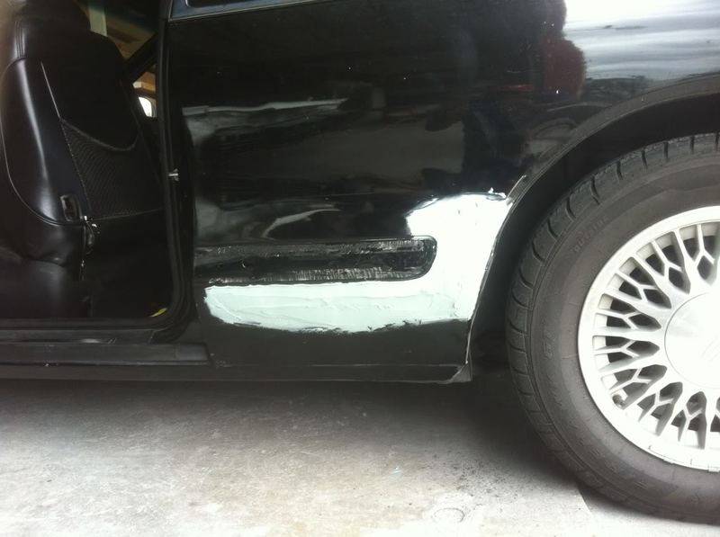

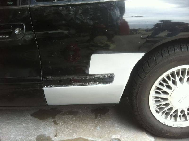

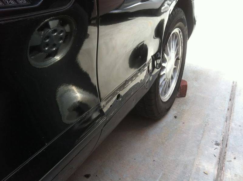

It's been a while since I updated. Figured I'd post some more pics of what I've been up to. The car is back together, she's looking like she should. Today I had a little bit of body work done. The left quarter panel on the had a nasty dent on it.

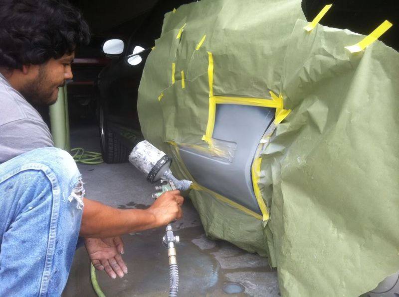

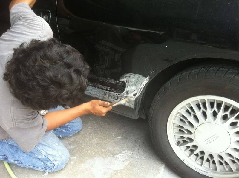

I wanted to get this fixed before I put the seats and side panels in. Now I prided myself on doing a lot of the work on my car, but some things had to be left to the professionals. This is one of those jobs. This is the first step in preparation of a full respray.
Hmm, taping it up like that would have created a hard line. Are there tape marks on it? Should have scuffed the whole quarter up, and then painted.
Dude, whole car will be painted in three months. I'm not worried about a line. I am more happy the dent was fixed. In two hours at that. :shifty:

Oh well, to each his own. Just trying to help, didn't know it was getting painted in 3 months.

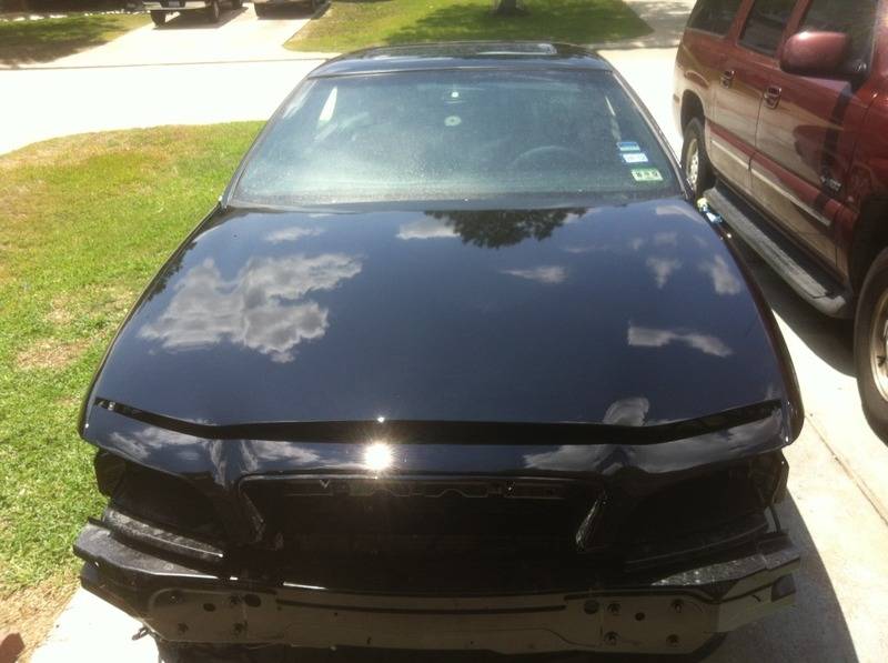

That thing is going to look Sharp! I like that you removed the bumpers and trim to get a good paint job.
Thanks Dan. I've been working on this for a while. I took every trim piece off because I wanted an excellent job. Now I have to find a new back glass.
