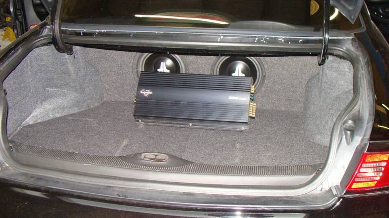

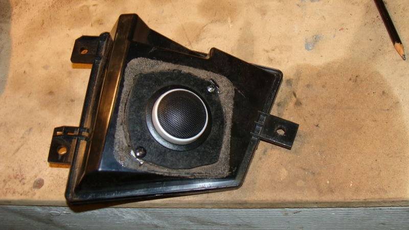

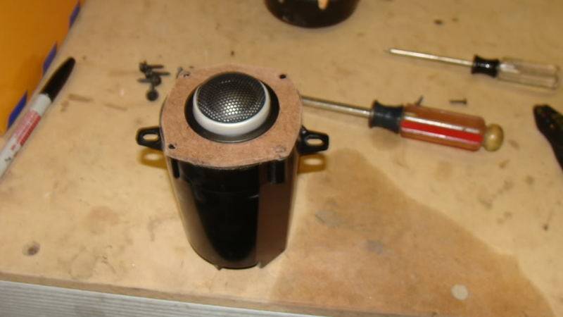

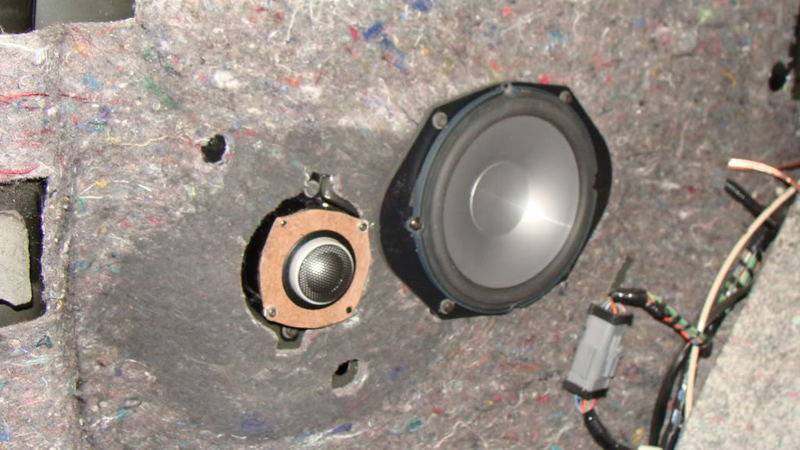

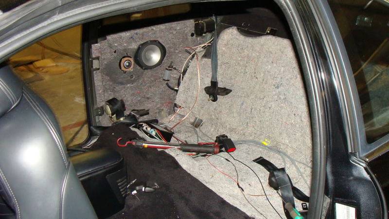

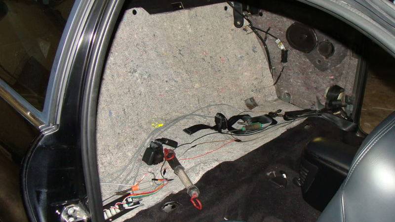

i'll get a few pics up after dinner but its the same as terry's. i can say that my set up has some of the most crisp sound i have ever heard in a car, if i put the volume around 20-22 my ears want to bleed and my compass module falls off the rear view everytime. i just had the thing cranked on the way home from my shop and i have such a ring right now lol. the only thing i want to do to mine is update my subs to something a little harder hitting i currently run two 10 inch JL 10W0's i got from terry. my interior speakers are all infinity refference components in factory locations including the tweeters.
here are some as i was installing it. the amp is actually hidden behind the box though i made an amp rack for it and was gonna mount it in front of the box like in the pics but i decided to hide it.
i have the same set up in my front doors as i do in the rear quarters apparently i never took pics of the doos lol.

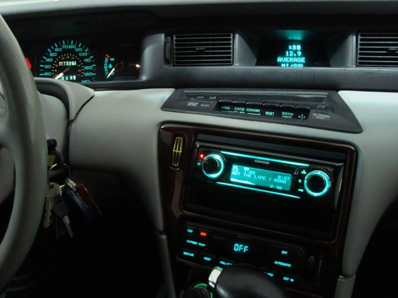

Has the mic with it and then no need in messing with a 16 year old mic and all the wiring mess involved. I think I might have 2" of mic wire showing but you really have to be looking for it and I'm able to flip my visor down and move it in any direction. You'll have plenty of wire to play with and put it where you want it. I'm assuming anyway. I don't know what Pioneer offers. I'm strictly a Kenwood eXcelon person. Seeing how I don't travel, I don't have any need for navigation. I have one for the window if the time came up and I did need it.

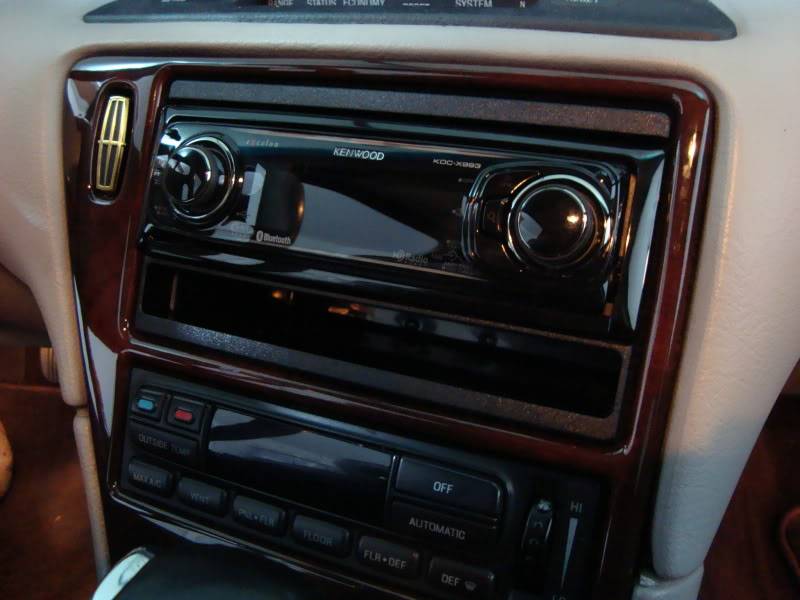

DVD would be nice if waiting in the car on someone but as for me, I wouldn't get any use out of it. That's why I went with the KDC-X993 and a Metra insert for the double din sized opening. It's all about the brand you like and the options that you really think you'll make use of and the money you want to spend.
the only thing is that i hate double dins. they just look after marker. (agreeing with laser) i just love the look that the huge screen gives it.
I agree, I like the screen look better. I just know I would never really use any of it. That was the reason I went with the style of Kenwood eXcelon single din that I did because it doesn't really stand out with silver colors and off sided knobs. It's all black with an even look on both sides and able to be set to match dash light colors.

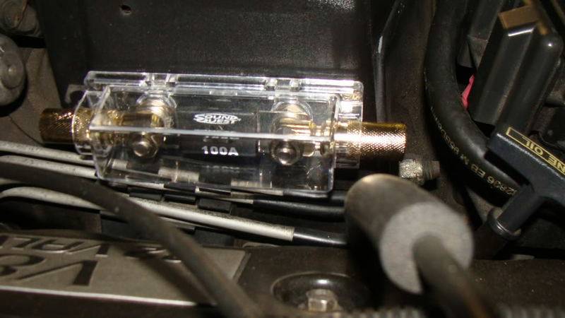

It's going to vary because I put in new door and rear speakers and installed 2 amps in the trunk. I ran 2 gauge wire from the battery to the trunk and into a JL Audio distribution block and then 4 gauge to each amp back there. All speakers inside were all rewired when the new ones went in, plus the stereo install.
Metra is the kit I used to drop down from a double to a single din. Seems like it was right at $18 for that. Took about 10 minutes or less to get it in and seated right and then wiring the deck in didn't take long. In my case, I have about 2 days worth of time in mine but I took a lot of breaks lol.
