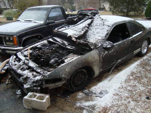

RC, I'm glad to see the problem was finally found and I don't think I done any bashing on anyone in here. I'm not the bashing type, especially to someone that it suffering a loss. Well, I'll bash a stupid person and I even bash myself for blowing up my own car lol. Just like someone way up above me posted a pic of my burnt car. I don't even care about that car anymore.
I think if you put enough effort into it, you could make that junkyard take that engine back, pull it from your car and install one from another junkyard. Not knowing the type of sale / warranty you got with that engine, it's hard to say but just know that I know what it feels like to put a lot of money into something and then see it burn down in less than 5 minutes after owning it for 5 years. I put a lot of work into that black car and now it's gone. I wished I would have had your problem to be honest.
I promise, you'll get through it, just like I did. I'm still dealing with this :q:q:q:q after four months. I still have a double car burnt hole on the end of the house and I lost my car and then had no choice but to buy another one. No, I'm not loaded with money. I'm single and I raise a 7 year old son on my own and I have bills to pay but a car payment and full coverage insurance isn't one of them. I learned from my mistake and swapped insurance carriers to State Farm and they are right down the street from me. I also learned to leave :q:q:q:q alone in a car that I have never worked on before. :)
You can bash me back if you want but what you done was almost what I would call plain stupid and what I done to my car was utterly retarded. None of us are perfect and for those of you that think you are, :q:q:q:q you because you're not. All of us had ideas and we were throwing them around like dodge ball and someone finally got hit tonight by the ball. I just hope it works out for you and just once more, if it makes you feel any better, I went from this.
to this in less than 5 minutes, while I watched it.
