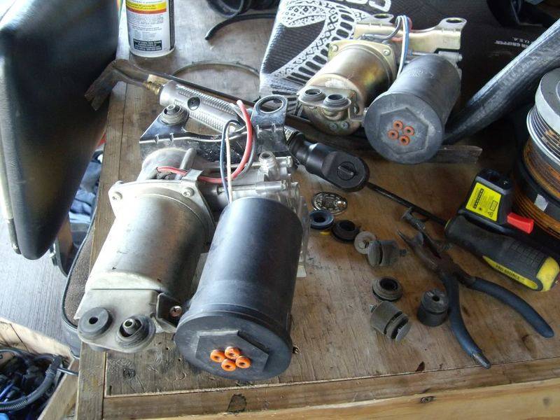

Went to do the air comp swap today but didnt go as planned. The mounts were all shot but that was a minor issue. Sapperfires comp wasnt nearly as strong as my OEM one and his filter/dryer was completly clogged. :( So I futzed with mine for a bit and saw that the seals feeding the filter were leaking bad. Pulled it apart and blew some air through the filter and added some new orings. Now she pumps like a champ!

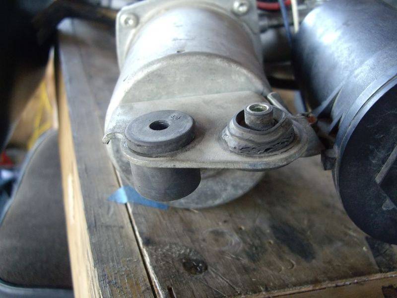

Got a little creative with the mounts and used the grommets off the old air box lower portion and remounted the compressor. Thing used to make a freakin racket and now is near silent. :D
Also was able to pump from full drop to full lift using the ASHAM8 and didnt get an error message. Guess the leak was it.
Can see the OEM in the foreground and the Arnott POS in the back:
And the new bushing setup on the left with the old blown out mount bushing on the right:
I need to buy one from Eddie soon. It might be my imagination but I swear the compressor kicks in way more than it did before I got my gears after driving slower speeds. I want to replace it before it gives up the ghost entirely.
Well crap, no help. System still has errors. I think its the dryer as its kinda hard to blow through. Wonder if I can buy a dryer by itself? Off to work teh Google on teh interwebz machine!
Do you think it's a result of the dessicant being saturated? I know many people have had luck baking the dessicant to dry it out....
eddie even says to do that, open the dryer and dump all the beads on a cooking sheet and stick them in the oven i think around 200 for 4 hours. bill did you stick 12 volts to the white and blue wire and make sure you hear the vent solenoid click open and closed? even if the compressor itself runs better if the vent solenoid wont open the compressor isnt gonna do a lick of good!
those grommets are the problem every time, ive never heard a loud compressor its just loud cuz the center breaks free allowing the metal bracket to lay on the body and buzzzzzzzzz, trust me running 2 on them i want them as quiet as possible
Well that was a waste of $40. :( The system still has a hard time airing up. The comp motor runs strong so that tells me moisture was ruined the seals on the comps piston. Eddie is currently out, not that it matters cause I cant afford one anyway. Guess I will be riding with an out of commission system for a while. Its the perfect time to get an Adrenalin setup but thats almost triple the cost.
