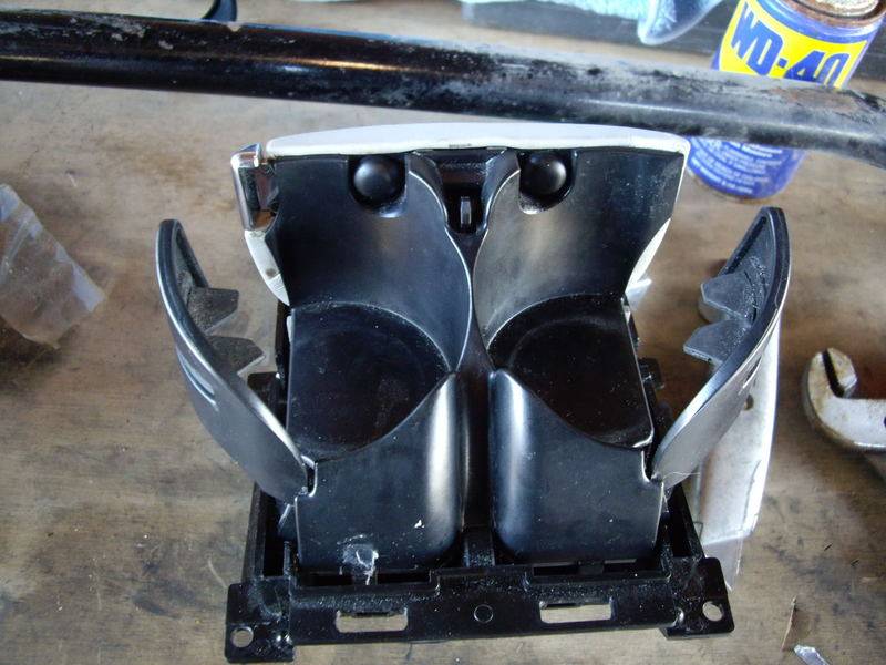

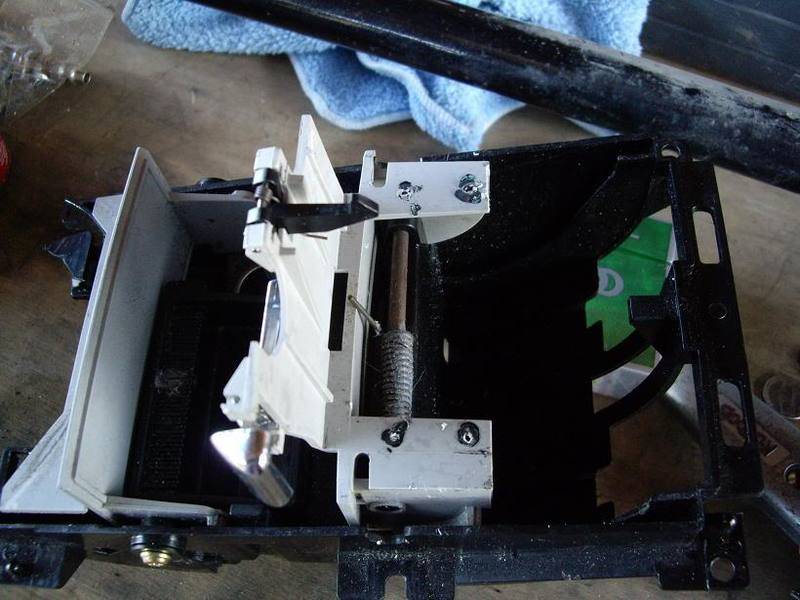

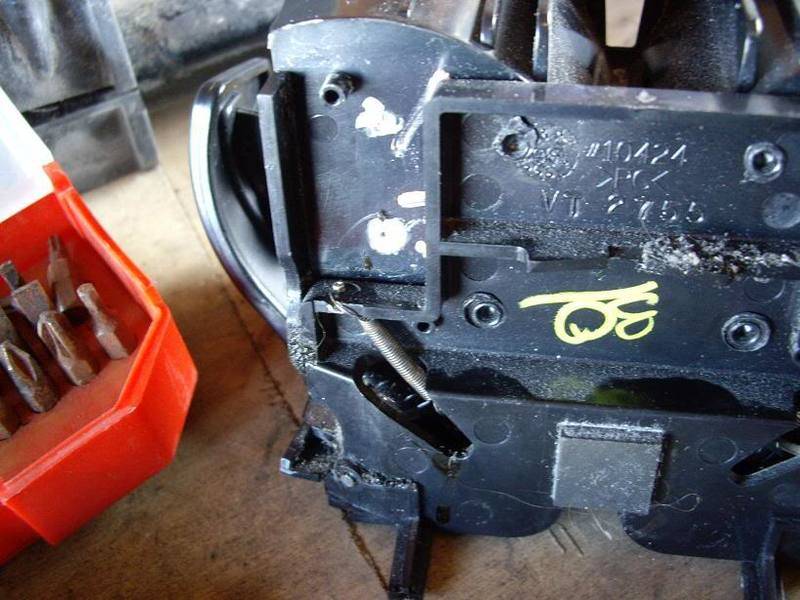

I swapped the cup holders out... what a PITA!! The colord piece is glued in place to the holder assembly so I couldnt just change covers and swap them over. I had to break the glue apart and use some CA plastic glue to get them back together, I also managed to break a tab that holds a spring so one side wouldnt flip out. I rigged it though and modded the cover to clear the screw I put in. Works great and now I can have a drink in teh car.

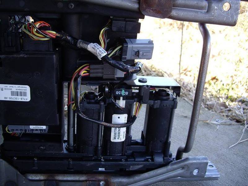

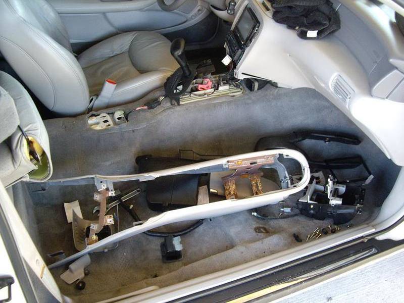

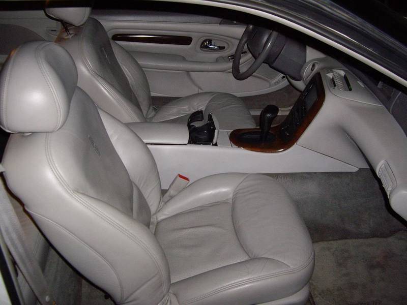

 After all that I worked on the seat. It appears the sensor on the motor is broken and wobbles around so it limits the seats travel. I swapped out the track with the 97's and that corrected it. Also the passenger seat belt reciever was broken but when I had the track upside down some glass fell out of the latch. So I shook the rest out and the seat belt now works again.
That led to the next problem of the seat belt not wanting to come off the track and I didnt want a tan one in the car. :lol:
I had to use my Ingrosol 3/4 impact with the pressure at 150psi to break that bastage loose.
 But finnaly got that done too.

The sensor on the end of the center motor was what went bad. Looks like a PITA to swap though so I just swapped tracks.
Here you can see where the two parts seperate for the cup holder. I reglued those black spots. You can also see my ghetto spring fix.
So after 7 hours and an amazing amount of blood I have a working seat, working cup holders, working console spring, working dampner on the glove box and a stock air box.
