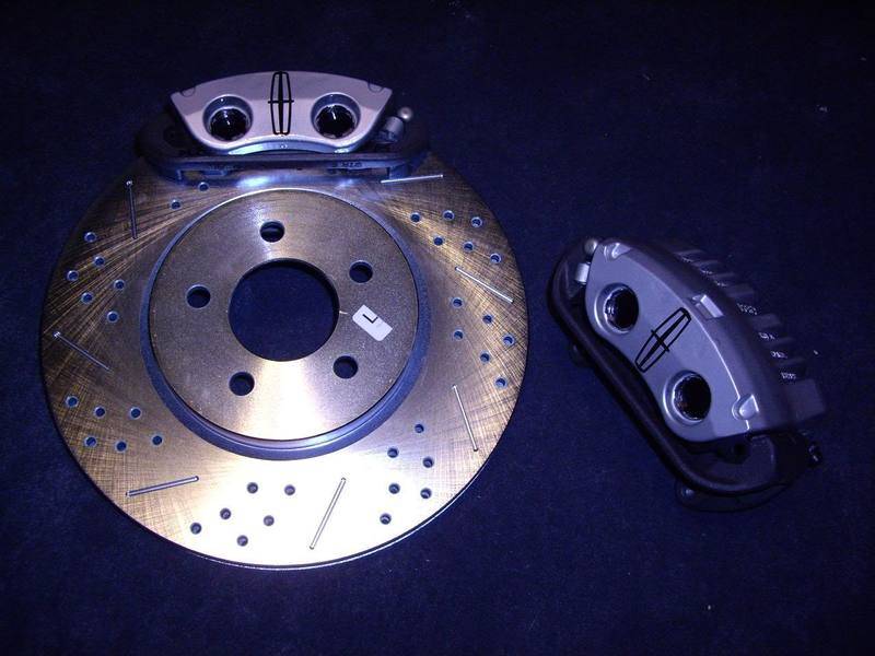

Anywho, work was slow as hell today so I got my calipers ready and painted them myself. Gonna get some high temp clear on the way home (if they even make it) cause I am happy with how they turned out. I will post some good pics when I get home but here is a teaser. :wrench
them calipers are sick you should sell paint them for all of us mark 8 owners who wants a set i now i do but you already now why but think about it and let me know
OK so here are all the recient updates. Finnished the brakes and will install them this weekend.... I hope, got 28 PMs today for parts off the 97. :lol:

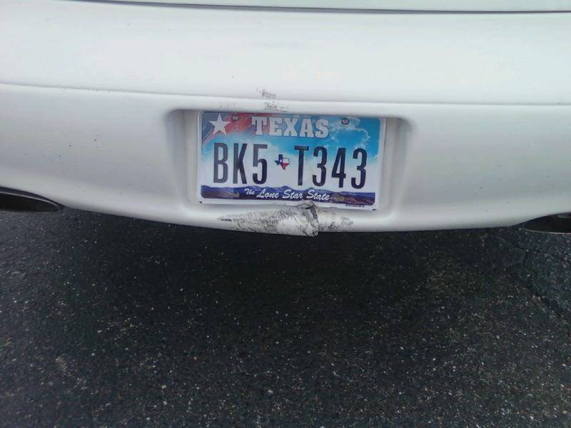

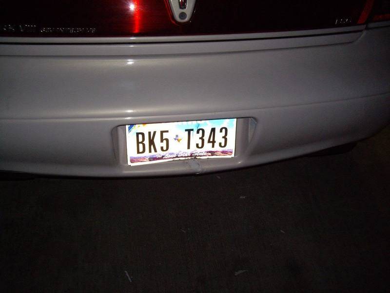

Then some ass hat in a SUV backed into my car and messed it up and made me want to kill anyone.... unfortunatly nobody else was in the parking lot so I had to leave a very very long tire patch in the parking lot. :mad:
Got home and buffed it out and applied allot of Nissan White Cloud touch up paint to get me by untill I can install the new bumper. Thats gonna be a month or so because I am not driving around with a white bumper and besides, i want it completly covered in white so it apears more factory. I hate it when there is paint covering a gap, just a pep peeve of mine.

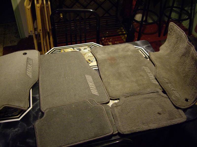

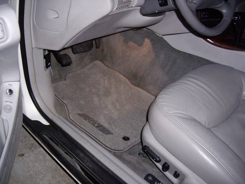

Then it was the simple things that made me happy. My floor mats showed up.... then I realized why I like my old tan ones more. They say LSC on them and my white car says Mark VIII. Never knew the real LSC mats were so much nicer and plush.
Oh well at least I dont have to stare at that red stain any more. :D
Old stained and burned ones on the right.
those arent geuine ford mark VIII floor mats thats why they look different those are knock offs you can tell just by the edge of the mats. but, they look 10 x's better than the old ones, and so does the back bumper, really isnt that bad after you cleaned it up and hit some touch up paint on it. i'd live with it for now.
Well then they prolly will not stay long as I search for real LSC mats. :(

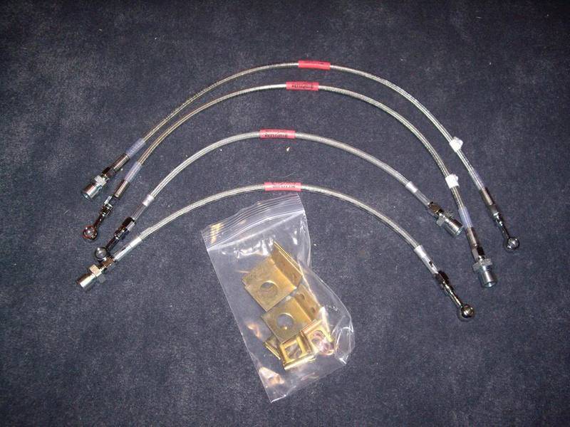

So here are the new lines. They seem to be real nice quality and even though they were not neccessary I really wanted them.

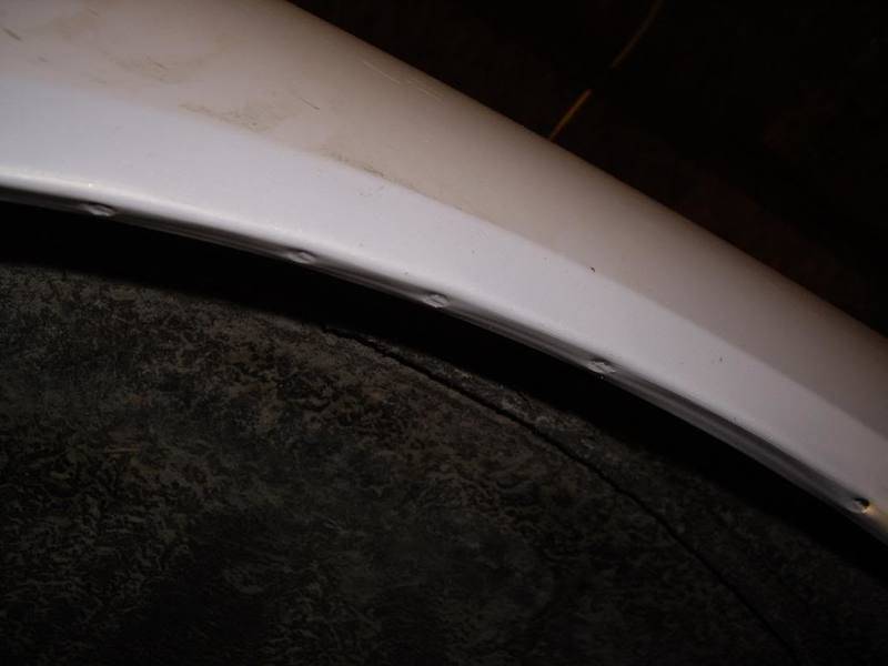

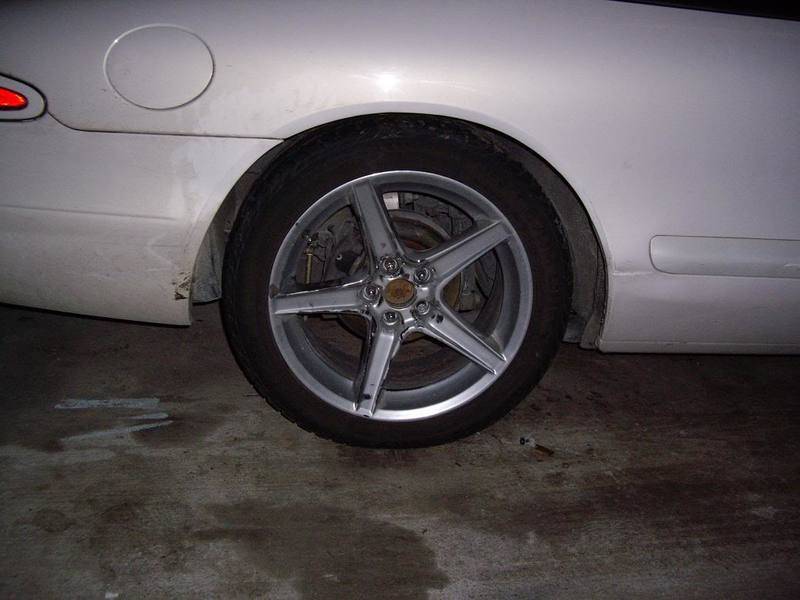

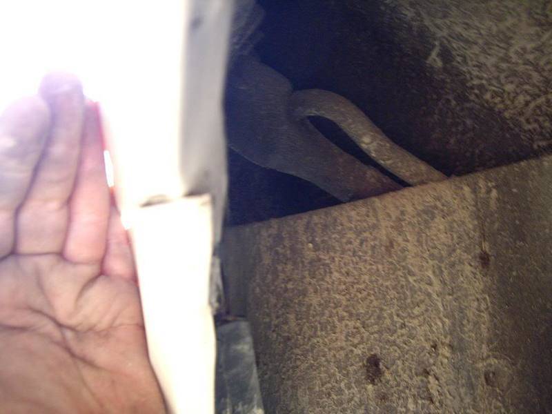

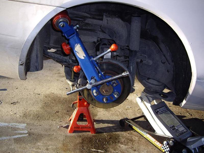

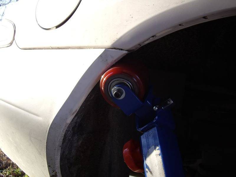

I did get the fenders rolled today! What an easy tool to use and with my laser temp gun I got the paint just right, no cracking. Just took my time and heated up a 6" long section to 135* then rolled 3-4 inches. I did the whole fender sections I thought needed to bend and then re-did each section two more times. Didnt want to bend the metal too much at once. I also cut off the bumper upper screw mount as the tires were rubbing there too. I figured I could experiment with this bumper since I will be putting on a new one anyway. I works though so I will do a little smoother cut on the new bumper before I bring it in for paint.
After that I sensor lowered the car 1" and then hit my bumpy ass road at some sufficient speeds and had ZERO rubbing. :wrench Thats just what I wanted, lower and no rub. I am a very happy mug. :)
So here are some pics and it shows where the tires were rubbing. Unfortunatly when I changed camera settings I also switched it to preview only and a dozen pics were never saved. :(
Yes I know, its dirty. It has been raining the last three days and I have been busy. CAr will be washed Monday. :p
http://www.rollyourfender.com/rentalpakage.html
Price has gone down a bit. You just pay $250 and then when you send it back (5 days after you get it) he refunds you minus $50 rental and shipping both ways (he gives a FedEx return lable. My shipping cost was $26 total so it only cost me $76 to rent it. :)

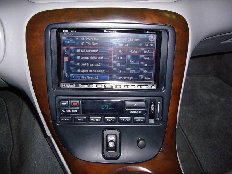

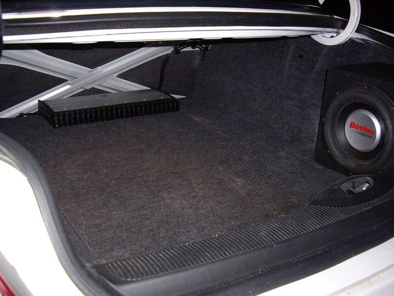

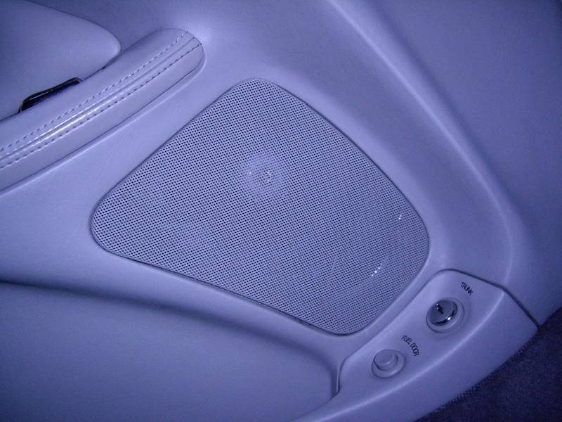

So todays progress was just installing the system and then getting the deck mounted better then before. It was sunk in 1/4" and just didnt look right so I brought it flush and made a trim ring. The flash has shown me some imperfections in it though so I am gonna have to make another one. :(
Gonna get that damn dome light fixed tomorrow and get the new brights in.... couldnt unscrew that damn bulb bezel for nothing today. :lol:

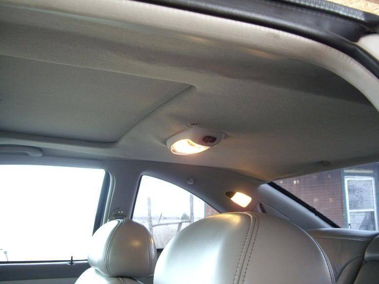

And that brings us to today. Today I did something that most of you would take for grandid, I made my dome light work. :D
The ground just wasnt good and you had to push up on the housing to make the lights work. So I went through the hassel of dropping the headliner to track the issue. Couldnt see why there would be one and so I ran a new ground wire to it. Works perfect now. :D

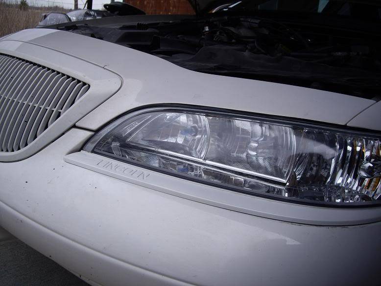

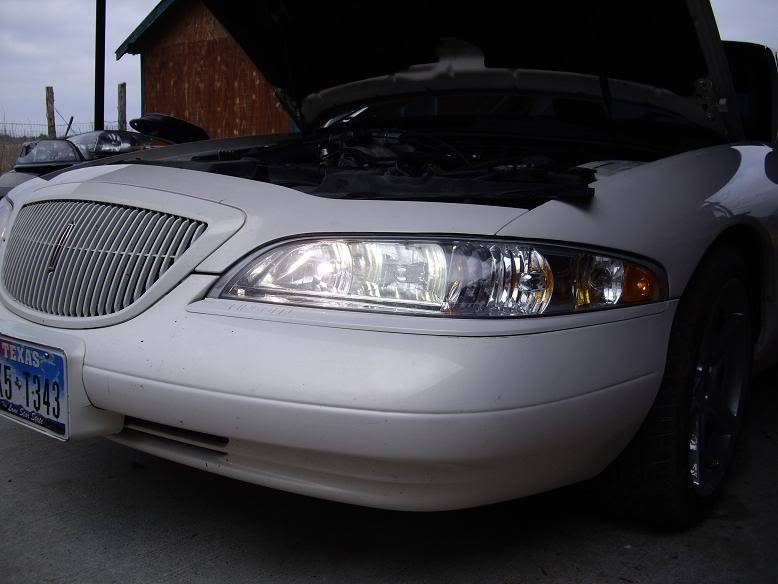

Next up was to get the damn brights in. That plastic bezel just did not want to unscrew. Finnaly got it off and put in some 6000K brights to match the HIDs. I also polished the lenses and they seem pretty clear. :)

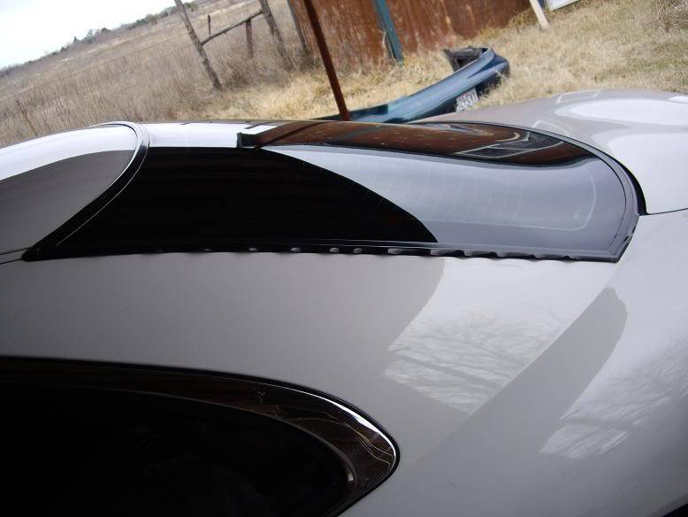

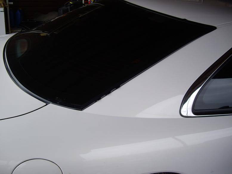

Well that was interesting. Guy came out and was real leery of doing the job being concerned it would break the glass and didnt want to do that in my only car. I suggested taking it off the bad car first since thats the glass I want anyway. So He has at it while I am putting my tools away and he goes into the car with this big ass Dewalt 18v ..... I think it was a recip saw with a putty knife on it.
So I hear this sound that is similar to using an air chisel on a weld. :eek: So I go watch him get the glass out. He says he ripped the tint in a couple spots. :( But he gets it out without breaking it. :) He then tells me since my office is next to his that he will take the window with him and and retint it for me and I can drop the car off with him tomorrow. I showed him I wanted the other windows darker too so he is gonna do the whole car for a pretty cheap price. Should look :q:q:q:q tomorrow. :D
I remember having the 93 window put in my 94. He used the same thing to remove it. The upper corners is where he had most of his trouble but he got it done without breaking either glass. It was scary though, listening to it. :)
I'm just glad that the 95 doesn't have the first ripple in it anywhere. Looks like we're both going to be tinted this week lol
Are you just going to throw that glass away? If you are, throw it in the empty 97 carcass and we'll continue our talk! Cause, I want to shave my 1st gen antenna, but need a gen 2 window prior. And I have flush mounted glass anyways so that seal doesn't matter.

As soon as I get it back I will check that out with the head liner. Thanks. And yeah I was planning on bringing the glass back home with me. He said hes just gonna cut the seal off on that one to insure the car does not get dammaged. :D
