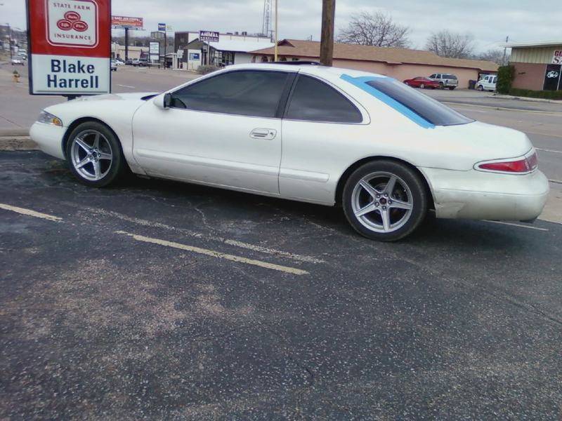

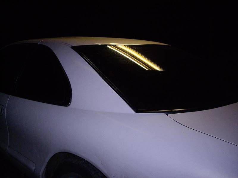

Ugh, gonna have to drive around for the next few days with blue tape on my rear window and am not supposed to wash the car. I also cant roll the windows down since they were just tinted and the guy said keep the moon roof closed so it does not blow the rear window out. No smoking for me in the car. :(
I like the tint though. :D

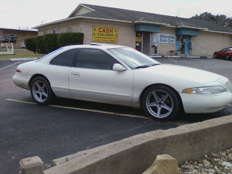

After that I sensor lowered the car 1" and then hit my bumpy ass road at some sufficient speeds and had ZERO rubbing. :wrench Thats just what I wanted, lower and no rub. I am a very happy mug. :)

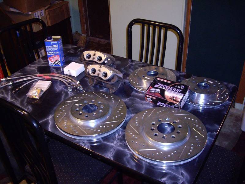

Also the UPS guy came to visit me and dropped off my new rear rotors and ceramic pads. :wrench So I guess I can do all the brakes at once this weekend. ..... damn.... :lol:

GMAN will even be here watching me do it. :lol: Your rear rotors and pads are identical to the ones in the picture though. Same kit from the same place. Now the fronts are a little different :p but at least its all under a year old including the calipers. :)

You see the problem is there were supposed to be some fine thread banjo bolts in the box with the strut. There were not and that means I cant install my Cobra brakes yet. :(

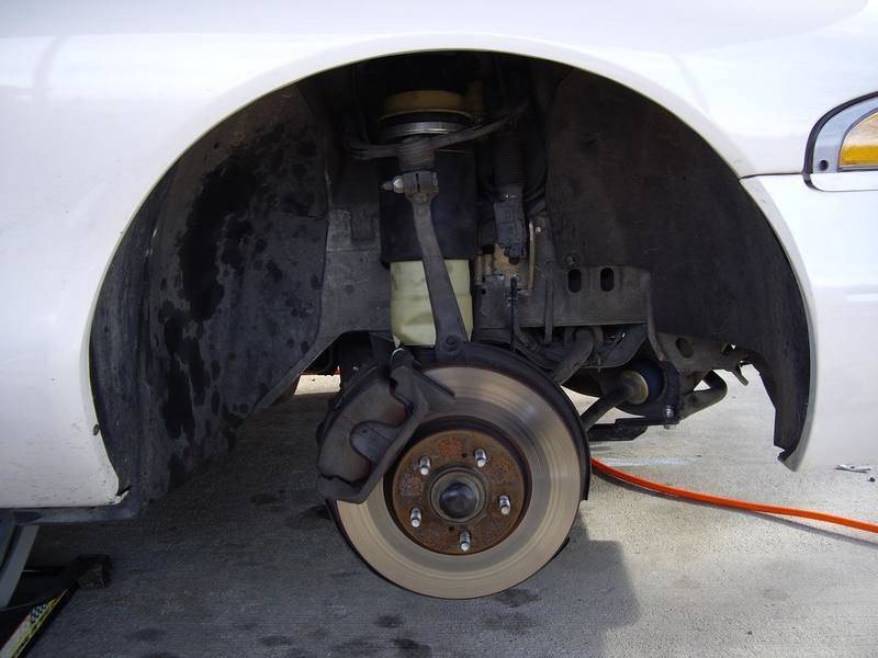

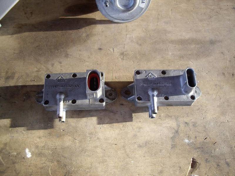

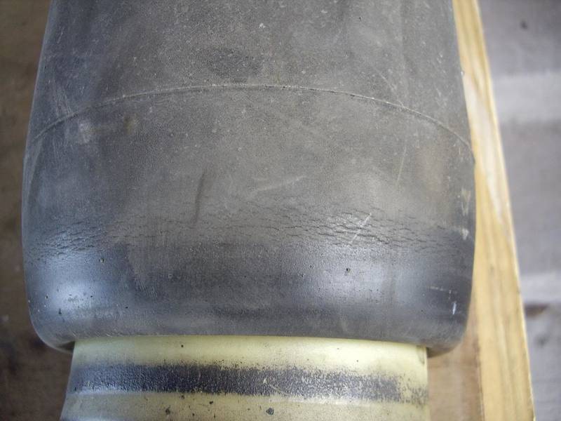

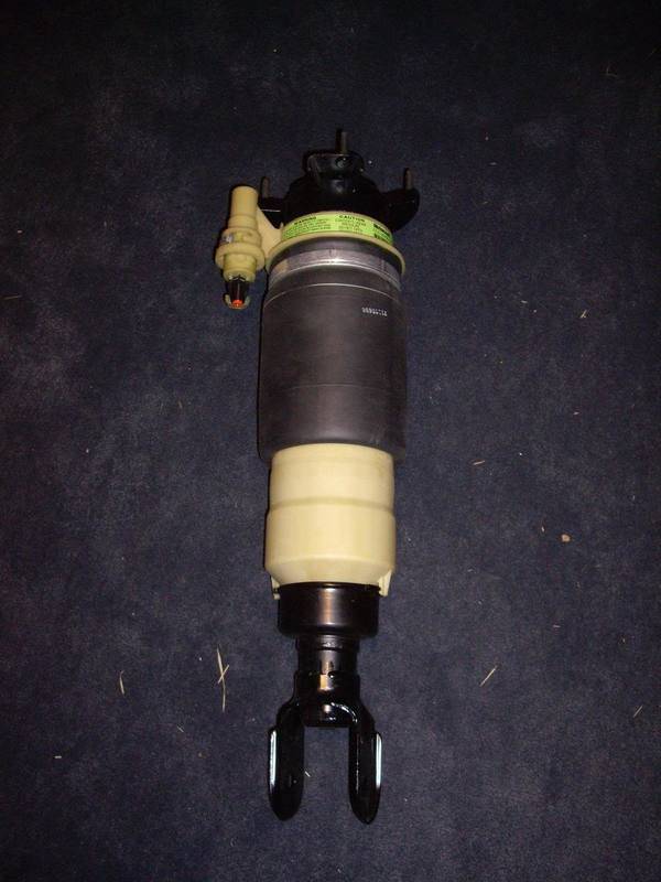

Today I just swapped the front air strut and tried to do the DPFE but gave up.
Shame that these little tiny cracks cost $400 :(
But the swap was easy after I figured out I had to remove the LCA
Also for those wondering, the Gen1 and Gen2 DPFE are different. Thats a first gen on the right
hope you marked the cam bolt location on the lower control arm. You didn't need to remove that though. The strut will come out with the suspension intact. You just need to compress it.
Didnt need to mark it, I used the marks it already had.
And how do I compress the strut to get it out?
that IS the trick you have to compress the strut

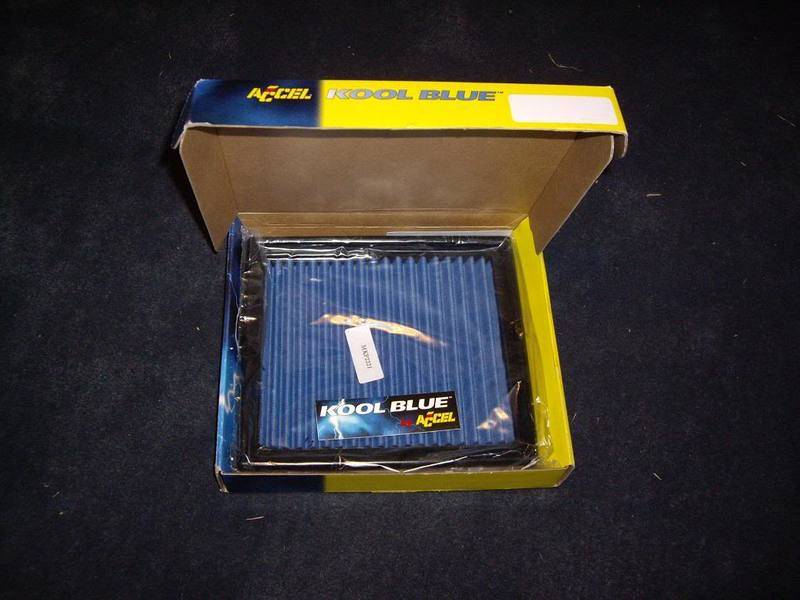

Hey Bill, What's the part number to the Accel Kool Blue air filter?
http://cgi.ebay.com/ebaymotors/Kool...ptZMotorsQ5fCarQ5fTruckQ5fPartsQ5fAccessories
You got two choices. Go to Autozone or O'Reilley's and check out their spring compressor. Or take the strut to a shop, and tip the mechanic, and he can take it off for you. That's what I did to get the springs on my struts. ;) Thanks for the link. :D
