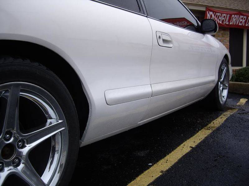

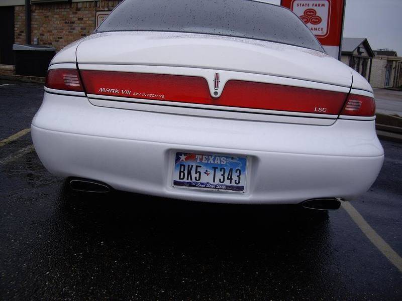

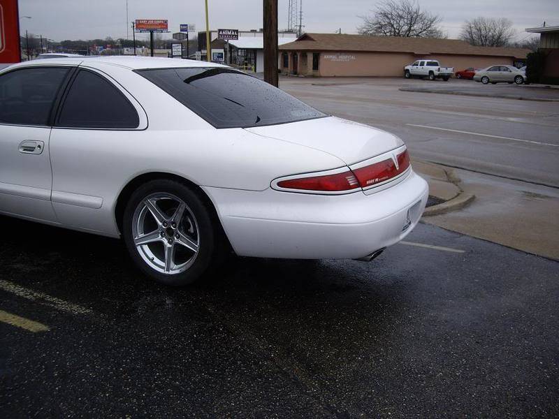

Just got her back from teh body shop and she looks great! They did an excellent job matching the paint and the guy said it should be near perfect after I clay the car. He used a polishing compound and some expensive wax on the area where he sprayed up to and you cant see any difference at all. He even rubbed a small spot by the door where he stopped his color to show that after I clay and de-swirl the rest of the car it will be right. :wrench
Although from the drivers side I cant tell and even the one picture where the lower neon light trim looks WAY diferent does not look different at all in person but does ned a serious cleaning. They even repainted the drivers tail lights and installed it for me. :D
I saw the dent before, and it came out very well..especially since it was in a hard to fix(multiple curves) area

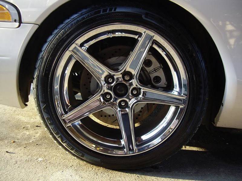

I had the rear wheels moved to the front and new tires slapped on and put the old front ones out back.
Big difference! The now rear wheels required almost 7 (couldnt see if it was OZ or GR) weights on them and the fronts only took .75 on each side. Car is so much smoother and its great to have that steering vibe/wobble gone at all speeds. 55 used to suck but now its nice and smooth! :D
After a few hundred miles I can say the car drives so much better now its a huge difeerence. New tires and the better wheels up front made her smooth as silk. I also tweaked the trans shift points some more and its much nicer now too.

Huh? Car hasnt even been washed since it was painted. I am gonna do the detail myself if the weather is clear on Sunday and you can be sure the bumper and passenger quarter wont see the clay bar or wax.
Oh, no. On the passenger door AFTER the blend he hit it with a cleaner and then wax to show the color is the same just my OEM paint was dingy but after I clay it then the match will be much better.

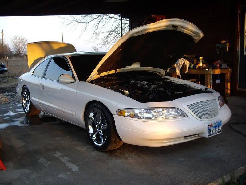

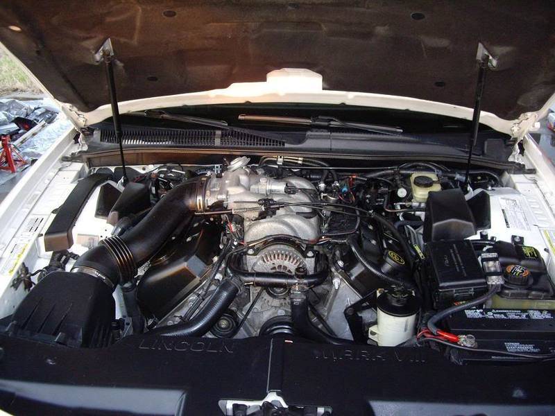

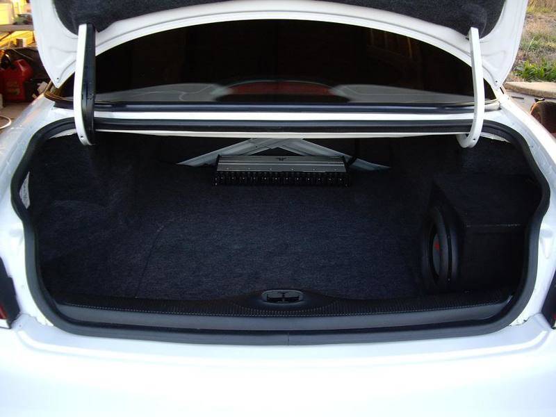

Alright another small update. I am getting ready for one of my full details and they usually kill me so I decided to split it up since I have no plans to go drive it tonight. So I gave her a very thorough wash and engine compartment detail. Took allot of effort to get the white white again in the engine bay. It was really dingy and I had to use a bunch of polishing compound and wax. Plus polished the fuel rails and scrubbed the spots off the plenum. Got the trunk detailed and the jams waxed. I also busted ass on my wheels and polished them up.

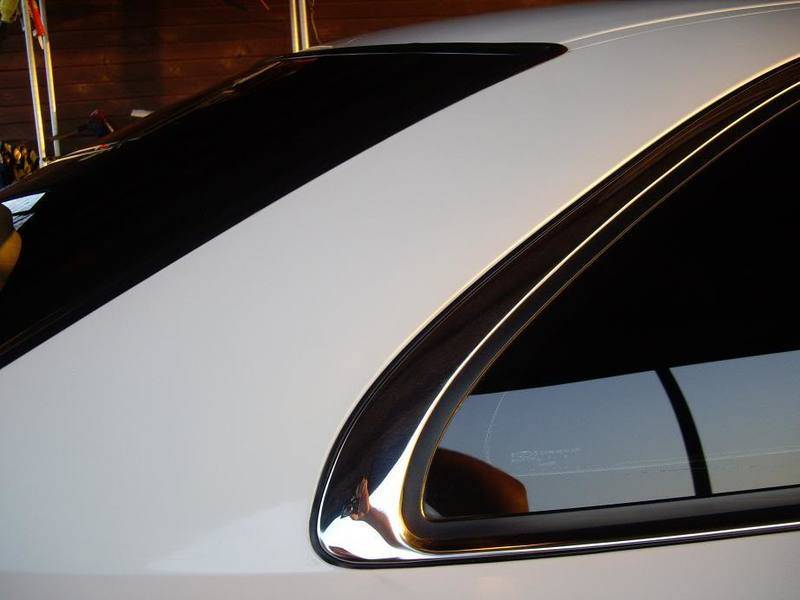

My chrome around the windows was really hazy and scratched. I guess I am not using the right stuff cause I got the haze gone but couldn't do as well as Brandon did on Stacks car. Still has fine scratches... cant really see them with your eye but the camera picks them up bad.
So here is where I am at, almost the half way point. Should be nice and clean when I'm done. :)

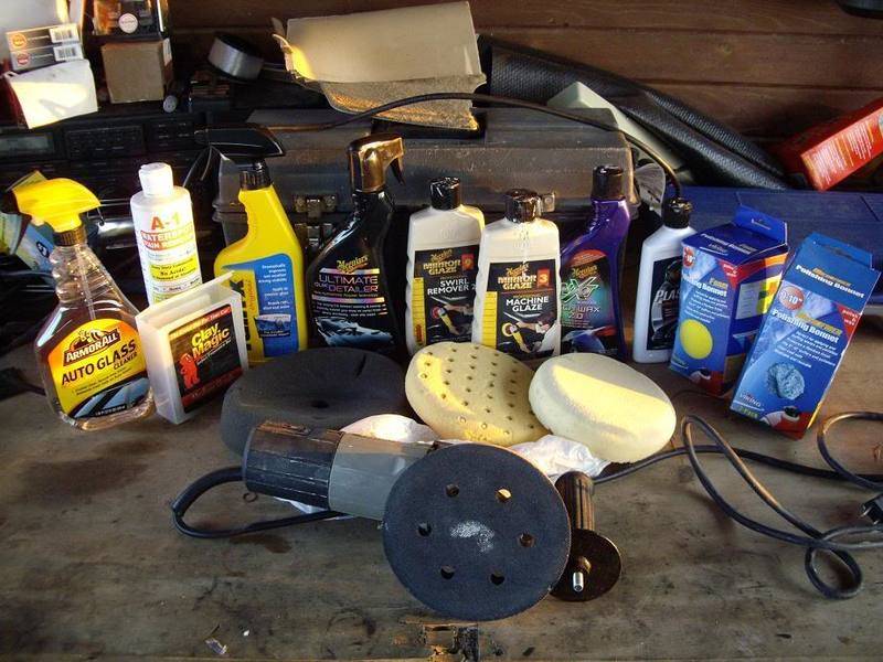

So tomorrow is clay bar 95% of the car (not touching bumper or fresh dent fix) then hit it with a Lake Country orange pad using my Porter Cable and some Maguires Professional swirl remover/cut. Then I will hit it with my foam pad on the PC with some Maguires Professional Glaze to add some depth. After that I will use the black foam finishing pad with some Maguires NXG wax then a microfiber bonnet to buff it out.
Then gonna use my yellow foam pad and the Maguires plastic polish and clean all the lights. Lastly I will use the Mothers Back To Black for all the little black parts. Should take most of the day and then I will take her out to get some nice pics. I had a PM from someone for some high res wide screen shots of the car for wallpaper but now cant remember who. :(
Heres tomorrows tools:
I hope so. The paint is so ruff right now. Its like touching sand paper. And the side moldings are very dingy so I may have to hit them with some polishing compound too. :(
