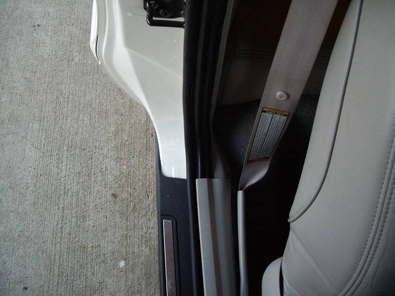

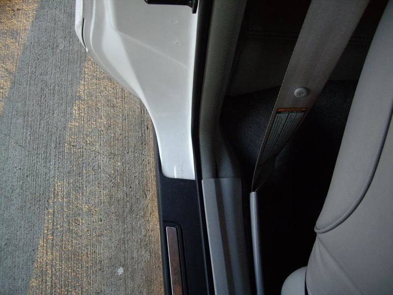

Also fixed up something else that was bugging me.
Before:
After:
Enjoy installing those Taiwan parts that are gonna fail the first time you drive the damn thing!!!!! (j/k i wouldnt want anybodys ride jacked up).
Damn them doors are hard to close now! I hope the seals soften up and form a bit cause it kinda sucks how hard you have to slam them.

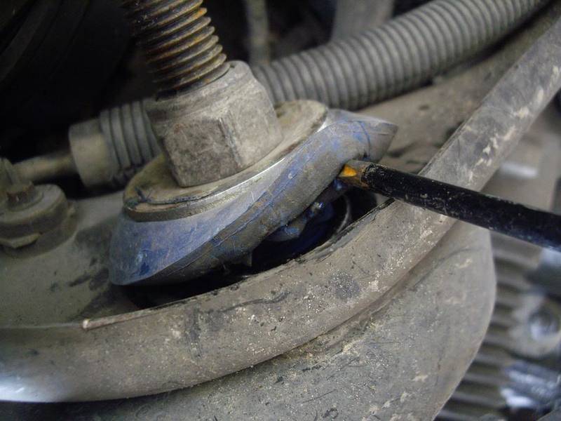

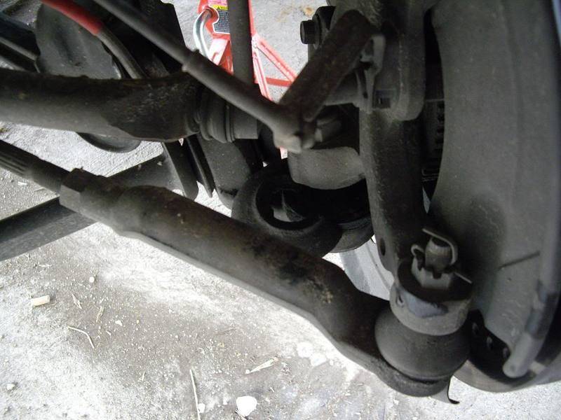

So I got the car prepped to do the front end overhaul tomorrow. Got it in the air and the wheels off and sprayed everything with PB Blast. I am so glad I am doing this as the lower ball joints are way worse then I had thought. The boots are destroyed and the drivers side has visable dammage on the ball. I also found out why the car would dart left and then drag right when getting on the brakes. I knew it wasnt a brake problem as the pull wasnt severe and it ..... hard to explain, I just knew it wasnt a brake issue.
Turns out the 6 month old Moog strut rod bushing had the washer almost pulled all the way through it! :eek: I could hardly see the washer and the bottom of the bushing is really eaten up. I jushed it with my finger and the washer POPED out of the bushing. I pried it back a little with the screw driver so I could show how eaten up and split it is.

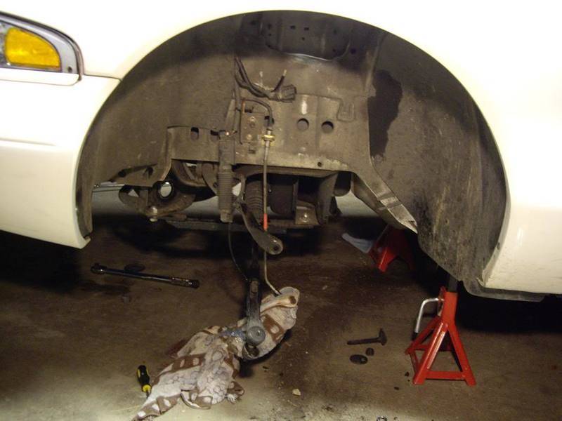

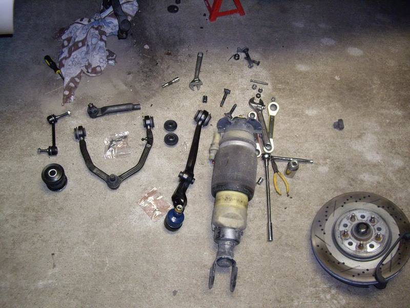

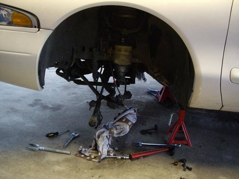

Well at 6 pm I got bored so i started on the tear down.
Only took me 38 minutes to get everything out and that was because I had to cut out the factory SRB because the sleeve was over tightened and mushroomed together. :(
I also saw that the UCA is a TRW so they have been replaced sudo reciently. Dont know how old so they are getting swapped out anyway. Better safe then sorry.

Remove the brake fluid level sensor plug and that vaccume thing above the strut so you can move them out of the way. Put a 18mm ratcheting wrench (dont see ANY way to do it without one) and crack the nut loose. Then if your tabs are broken off the bolt like mine were you can put a wrench on the bolt and back it off. I backed it most of the way off using the ratchet wrench before I realized I could do that. If you just unscrew the nut the ratchet can only swing one "click" at a time and its very slow going.
Not a hard job at all really.

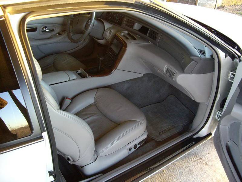

hey Bill, yes the console has to come out in order to get the cup holder out, there is a screw in the center on the bottom of it, very easy to do, if its at all like mine, open arm rest, 2 torx screws in there under the rubber mat, pop the trim from around the Climate Control to reveal 2 more torx screws, pop the trim from around the shifter and unplug the switches and cig lighters, slide console toward the back seat to seperate the air duct for the rear vents in console and lift out
Uh yeah. That problem was solved that same day and I am pretty sure there are pictures with it out of the car right after that question was asked.

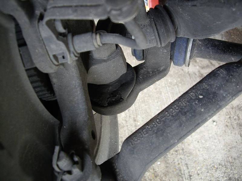

tie rod ends, you doing just the outters? if you are doing the inner, theres a pin that has to be removed first..or you WILL strip the threads and buy a new R&P
(ninja edit) i dont see one in the pic, thought i would ask, and maybe someone reading this in the future can be warned too :)

Cars still kicking my ass. :( Had to cut off the other side rear and front bushing sleeves. Somebody really over tightened these damn things. I had to take a break cause I almost threw my back out trying to loosen these damn things. Almost there though. Drivers side is done and passenger side is almost out, just have to drop the strut then remove the UCA that is another TRW but its ball joint is loose as hell in there.
Never removed air from both struts before so getting it back to ride height should be interesting. Good thing I have two hydraulic floor jacks. :lol:
