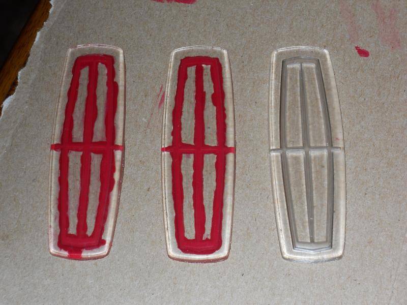

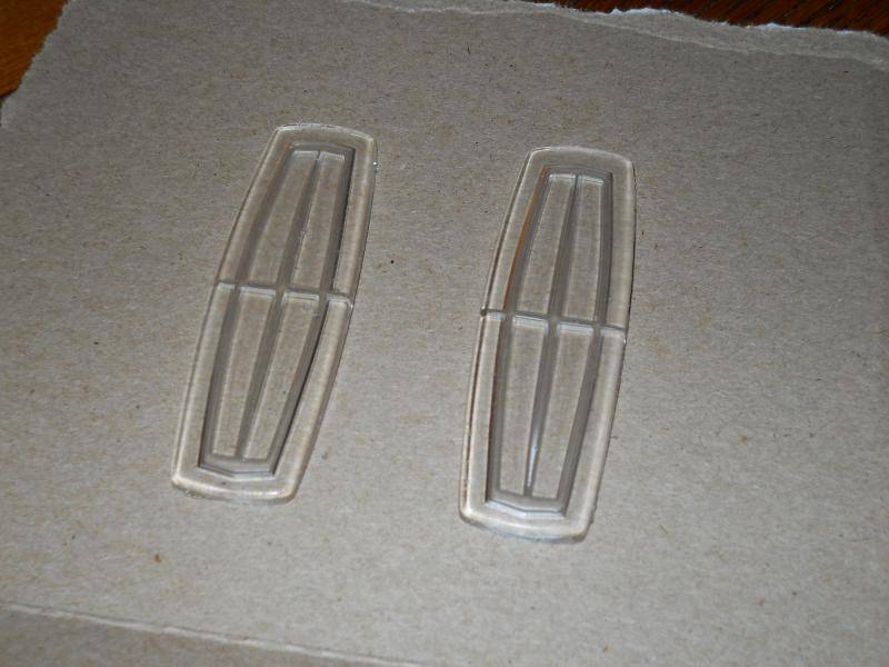

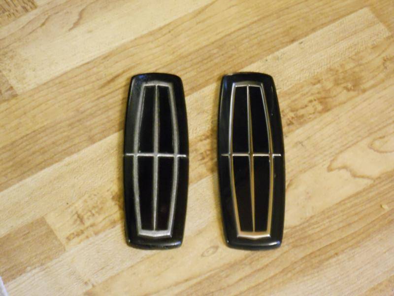

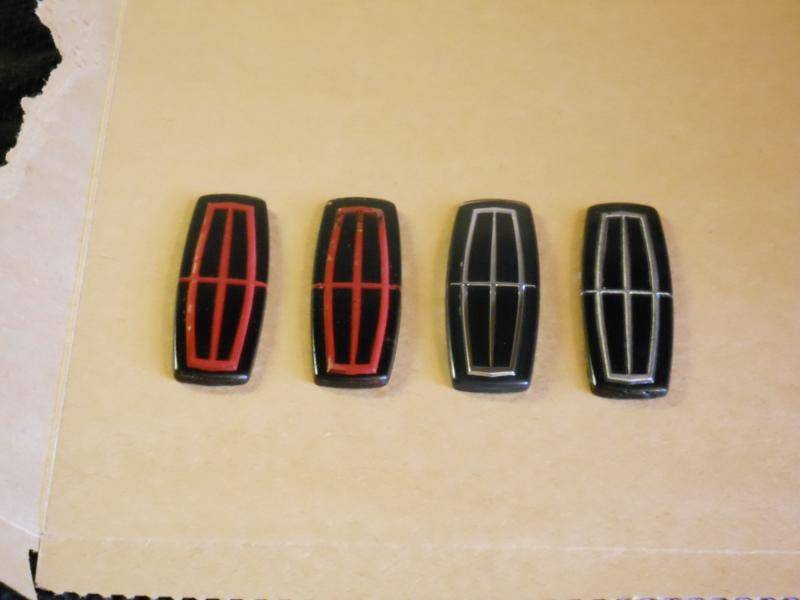

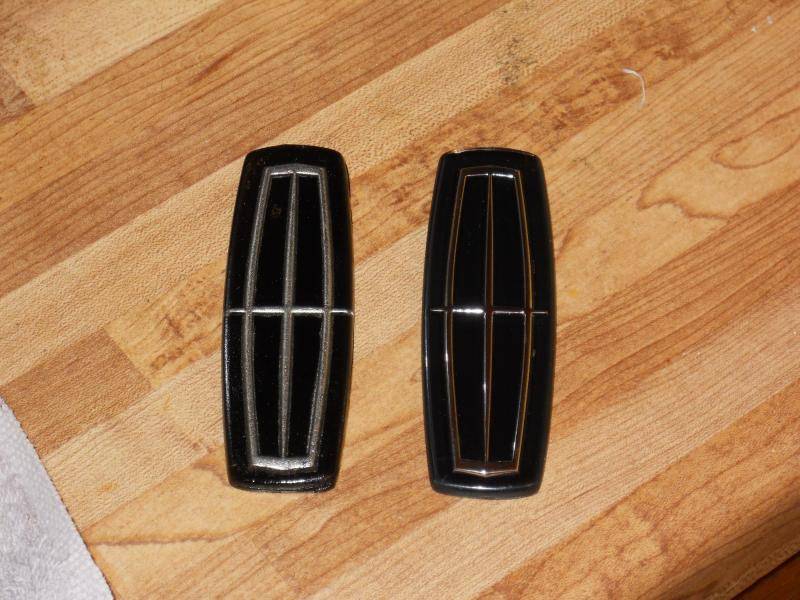

I made 4 new emblems tonight so I could play around with paint and see if it was something I would want to do for those ordering emblems. I learned that I need to stick to spray paint instead of a brush on paint. In the pics you will still notice imperfections in the pieces because I am still using my original mold and process. After doing some reading I now know that to get the kind of results I want I will need to cure the parts under pressure(it forces out the air bubbles or makes them microscopic :-D ) and probably still some heat.
So the first 3 pics are the new emblems I cast.
The next one is me trying to use a red brush on paint to make some red and black emblems that a few have asked for. In the following is the emblem I had already spray painted with a chrome/silver which I took and sanded the back down to see how it'd work.

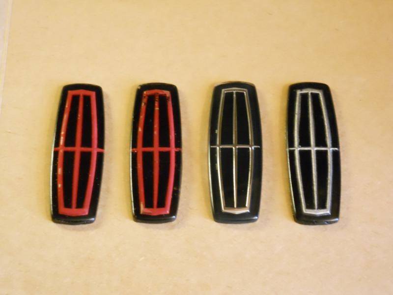

The next two pics are the chrome/silver with the black background placed next to the original emblem. Guess which one is stock?! You probably can since I don't think I can match the stock chrome but the whole point of this thing is because everyone wants something different!

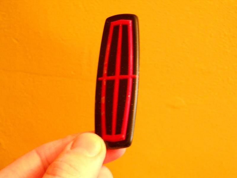

The next pic is a close-up of the red on black emblem.
Last two pics, have the red and silver star emblems side by side.
Enjoy!
Next post I'll talk about some pricing! :D
damn close.
Just need to get the lines more sharp and defined.
damn close.
They actually are just as sharp it's just that it doesn't show well in the pictures and the chrome stock emblem will look sharper than most spray paints.
Nice. The black n red is hott.
How r u painting these? Like do you shoot fhe star paint on it first, then sand the back until just the star remains colored?
Because that seems it would work well, then once the star is dry you can just shoot black all over the back without messing with taping off stuff.
I really like the black w/red logo that looks awesome. Very subtle but still a really nice touch. Can't wait to get a set installed!

Saw them in person today. The lines are infact crisp and damn near perfect. I'm excited to see what else he will be making.
That is exactly it and it works very well! It's nice because spray paint gets in all of the nooks and crannies then when you sand it you get the nice clean edge between the background and the star. Krylon or fusion paint seems to work the best for these. I will include a few different pricing levels because some people may want to paint their own and some may not want to deal with it, plus I will have a ton of colors to choose from anyway.
