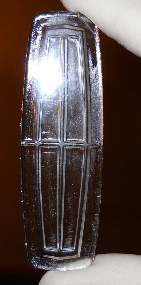

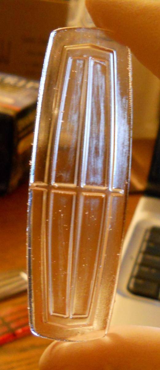

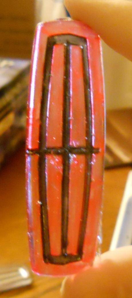

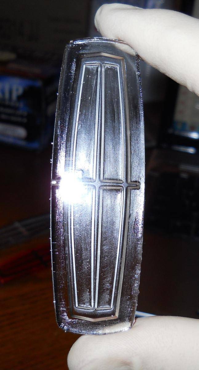

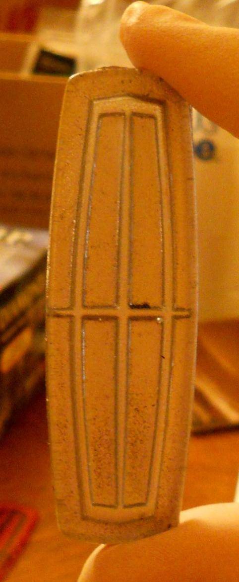

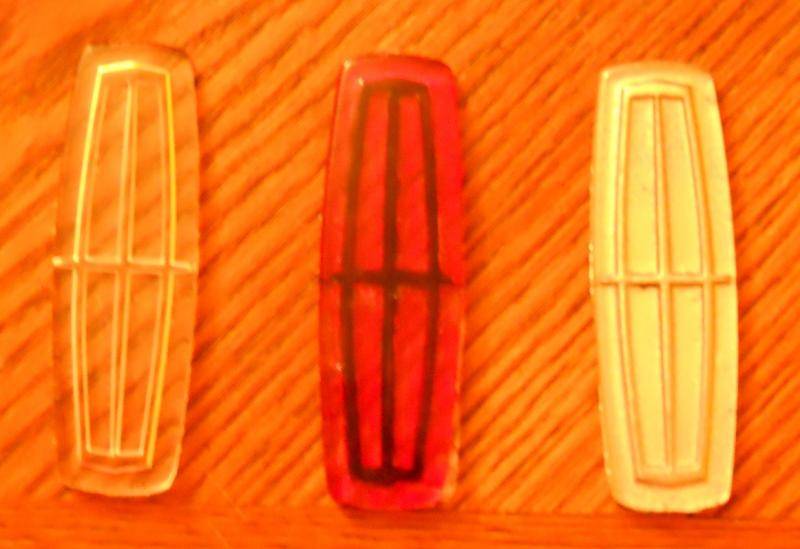

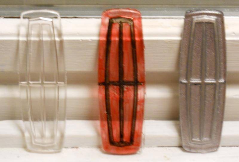

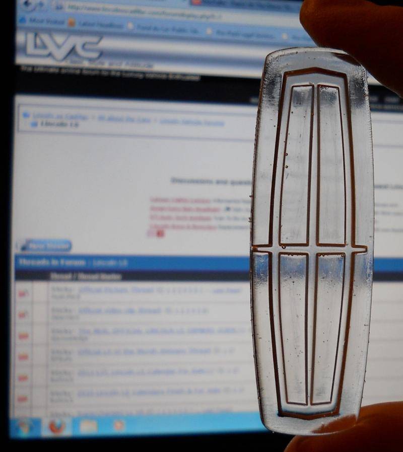

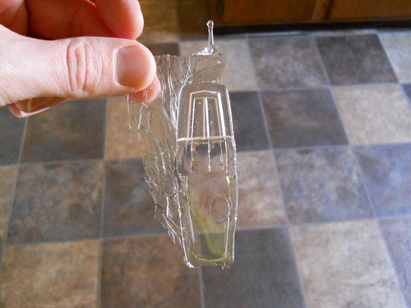

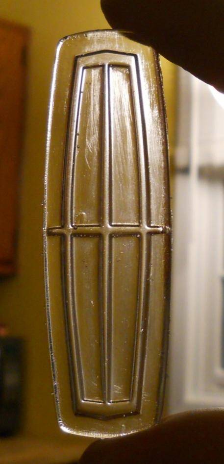

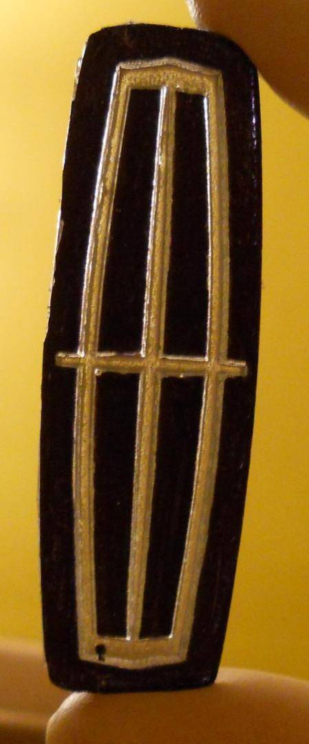

On our last episode of "Emblems for our LS" there was an issue with the parts still being tacky and flexible. I got both problems figured out! Here are a bunch of new pics! The clear emblem is the one I just cast tonight and it feels exactly like the stock emblem! You will see in the pictures that the clear emblem shows some scuff marks and tiny air bubbles. The scratches are actually from me sanding the original part so in my new mold I will have to put a coat of clear on the emblem first and make sure it is perfect because everything transfers to any parts made from that mold. I figured out that I need more heat for my parts to fully cure since they are smaller pieces so I have to put them in the oven at like 150 degrees and this will also help remove air bubbles in future emblems. I also took two other emblems I made and added some color just to see how it'd look. The silver emblem is a chrome spray paint I was trying out, not so sure about it yet. On the back of the silver emblem I colored the background black, plus managed to slip and make a mark on the silver star. The red emblem is just colored with dry erase marker, red background/black star.
Once I get my new mold making material I will have it set up so I can cast 6-8 pieces at a time of the emblems with the star indentation in the back. Still working on the emblems that I can embed pieces into.
Enjoy!
(First pic, just couldn't help but leave LVC in there!)
