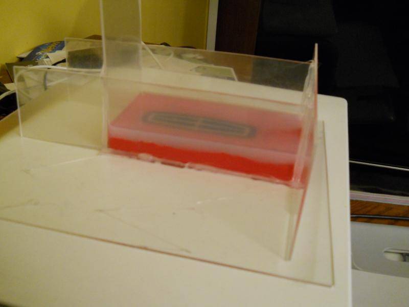

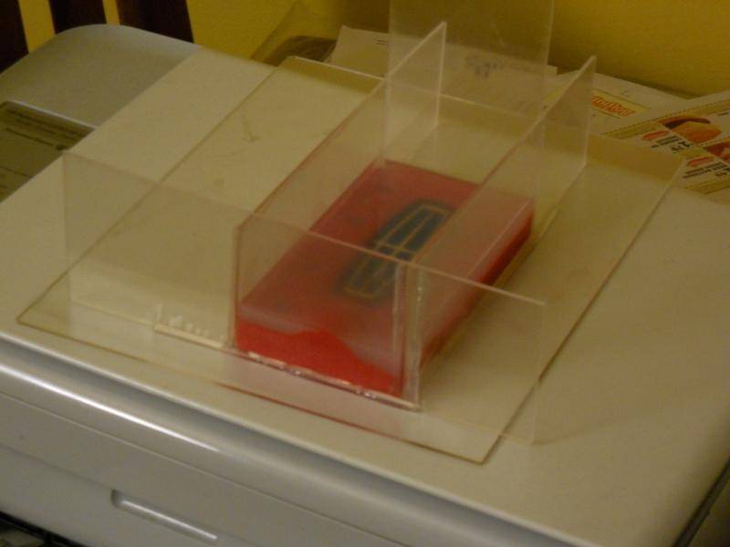

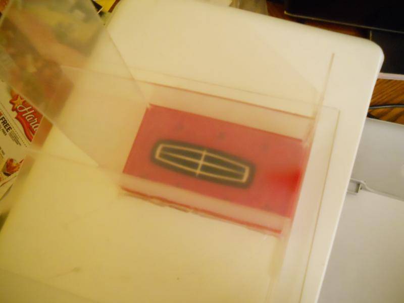

Here are some pics of me casting the first half of the mold for the emblem. I would post the finished mold but I have it set up and am attempting to cast the first emblem. I will put up pics of that once it's done and it turns out ok.
I need to find a more ventilated area...these fumes are makin me woosie.

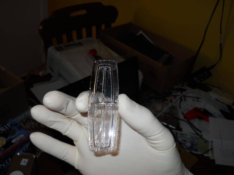

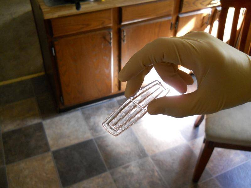

Ok so try #1 was a partial fail. I got the part cast and the detail is fantastic as far as getting the bevel of the star from the back and how clear everything is but I didn't use enough hardener with the resin so the part was still tacky and flexible. Guess I need to experiment a little more. I'm going to pour #2 before work here and see how it turns out when I get home.
EXCELLENT first attempt!! I can't wait to see the final product! Be careful of treading on Ford's copyright for the emblem.....
Yes, do not sell them. Sell an envelope for whatever price, and throw in a free emblem. :D
Looks like it will work well!
You could put a piece of tape or something on the back side and avoid the star indention and have a clean face to put whatever behind it.
Also pektel is right, this is how people get away with selling event tickets @ over face value. Most State laws do not allow for people to sell a ticket any higher than what it is stated for, so you throw in a random item that is included with the tickets.

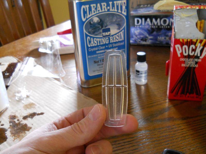

Will it was better but still not good enough. The part is still tacky and slightly flexible. On to round three, need more cowbell, er, catalyst!COWBELL!

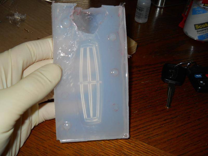

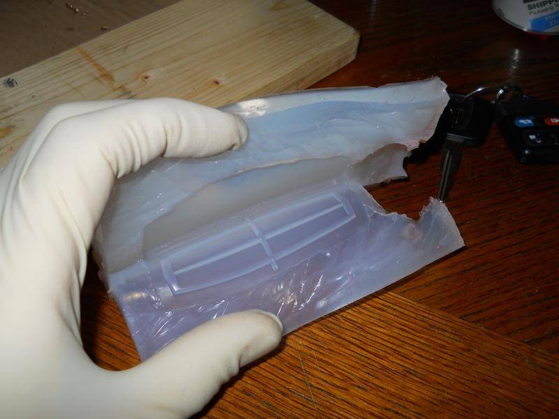

Here are some pics of the mold. It's not the best but it's my first one ever! Pics of part number 2. Also notice my snack of choice at the moment, Pocky sticks! YUM

looks good!
how come your key looks diff than mine??
EXCELLENT!! Blacking-out the star and having the rest (or vice-versa) "glowing" would look very nice!
