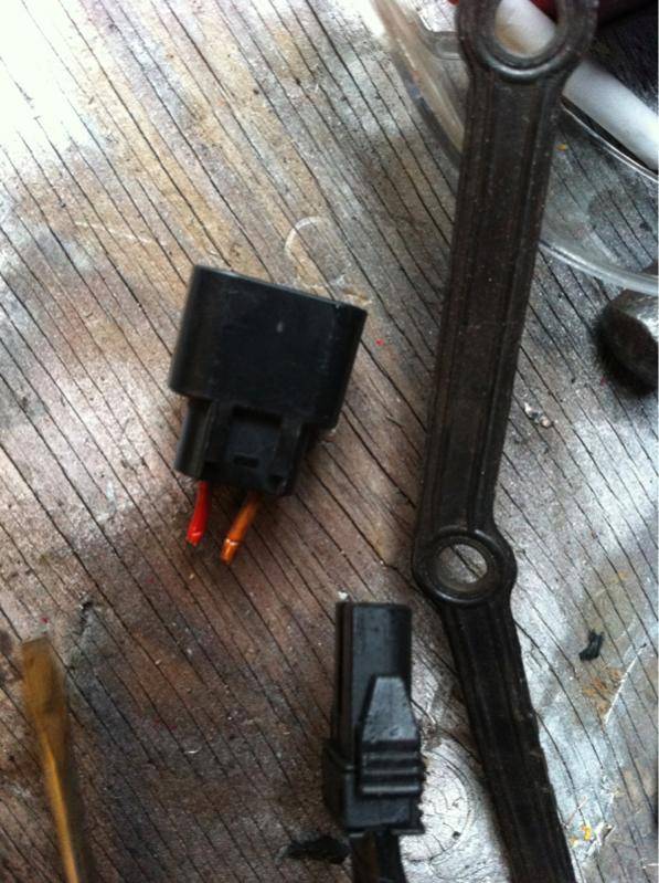

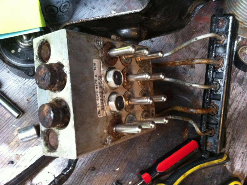

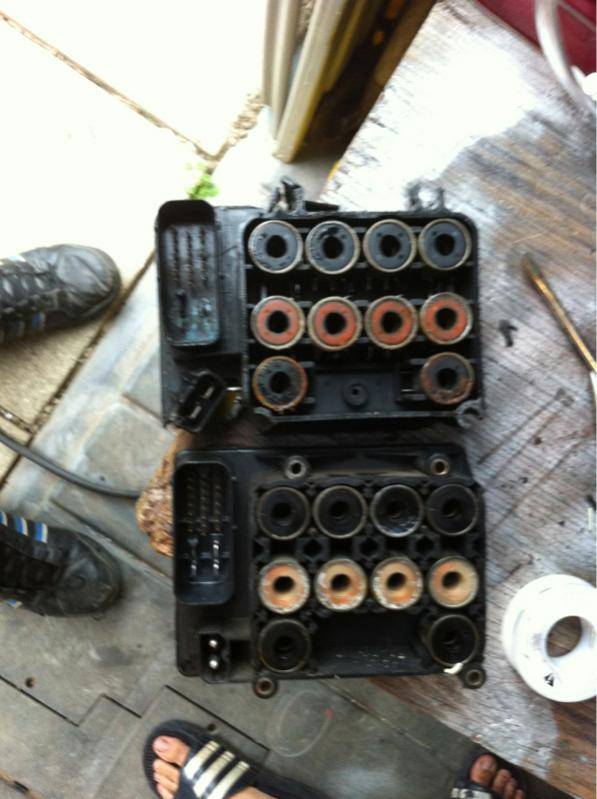

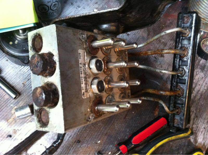

So I have a 98 LSC that the ABS Pump was shot. Put in a whole unit out of a 97 but a lot of the pins were corrupted on the module so I had no speedo no odometer and the traction control off light was always on. What we did was take the working pump from the 97 and the working clean module from the 98. Had to splice the connector as they are different but other then that everything turns out the same. Will be installing in tomorrow morning and will post results. Here's some pics..
97 module on top, 98 on bottom. As you can see the top one looks like shat. And was metal. 98 is plastic and clean.
Lonely connector is from 97 the one attached is the 98.
Here is where the module is attached to these posts, will be cleaning up before installed.

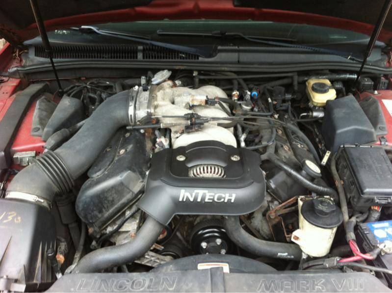

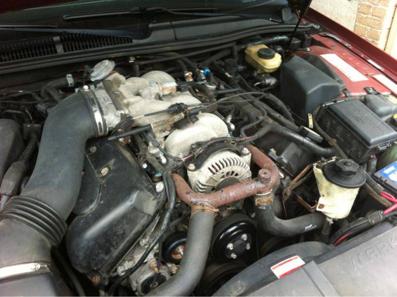

Also today put the plastic intech cover on to cover up the rust for now.
Before.
After

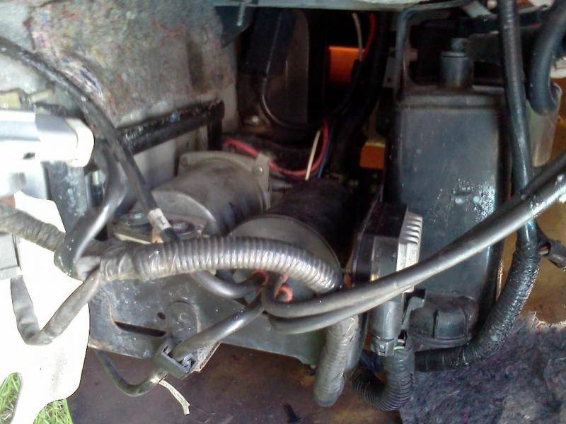

Air compressor from the '97 LSC. Works great!

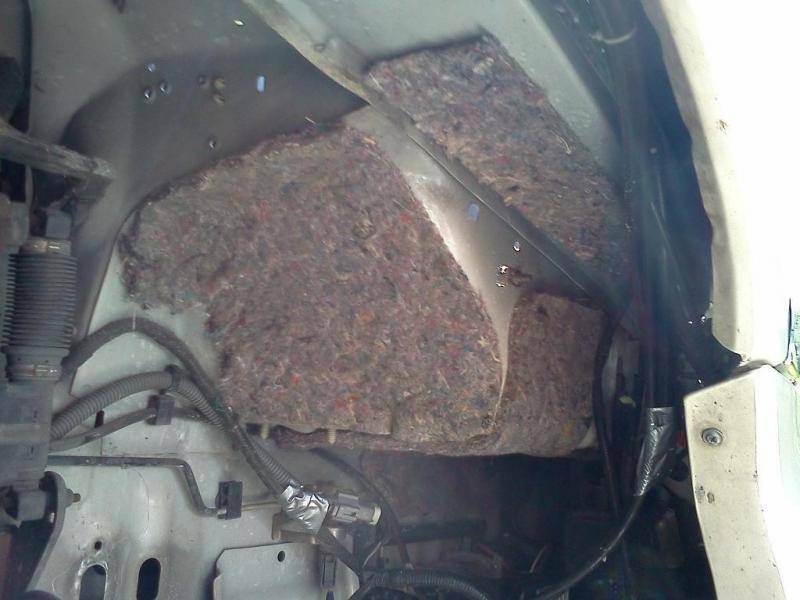

Little bit of sound deadener (from the '97 trunk).

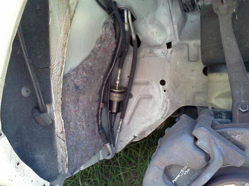

New fuel filter.

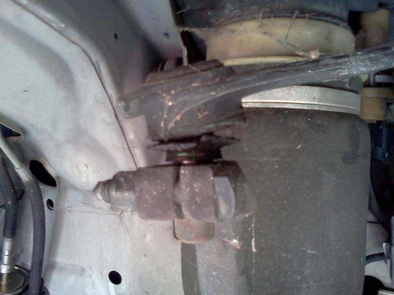

Need to replace UCA's.
Drove it around today. I think the new fuel filter helped with the idle. But it still needs a TPS and IAC. I'm just glad to be able to drive it again!

Well we finished piecing together the 97 and 98 ABS pump. And it worked!!!! Brakes work abs works traction control works speedo and odometer work!! So happy. Bled the brakes and took her for a cruise! Certifying tomorrow then be driving it all the time!

Don't know about the first gens but on my second gen it was just disconnecting the 5 brake lines and I think 3 bolts and 2 nuts to remove the full pump system. Then 4 very small, 4mm I think it was, bolts to remove the module from the pump system. Then swapped it over and plugged it back in, after changing the plug from the pump to the module. Then bolt it back in, reconnect the brake lines then bled the brakes and all done.
