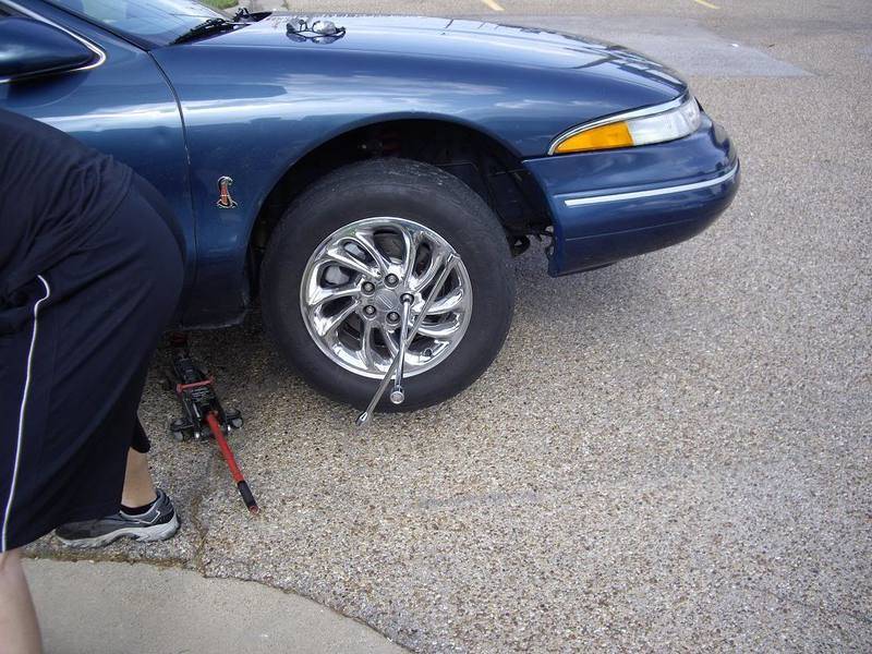

Ill be nice and not repeat the conversation when we were finnishing the k-member install. :p
It was an honest.... and unusuall mistake. :lol:
I wont repeat it though, hes my friend and its unflattering. :p
Yay! New progress! Roadside working FTMFL!!
Ill let Sapperfire narrate it.
First time I ever saw someone try to power a lug wrench with a fart!:bowrofl::bowrofl:

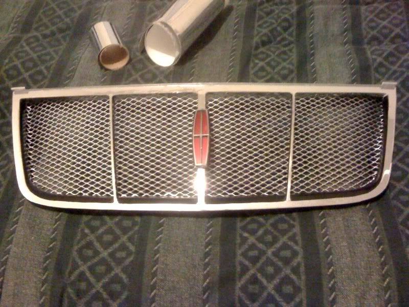

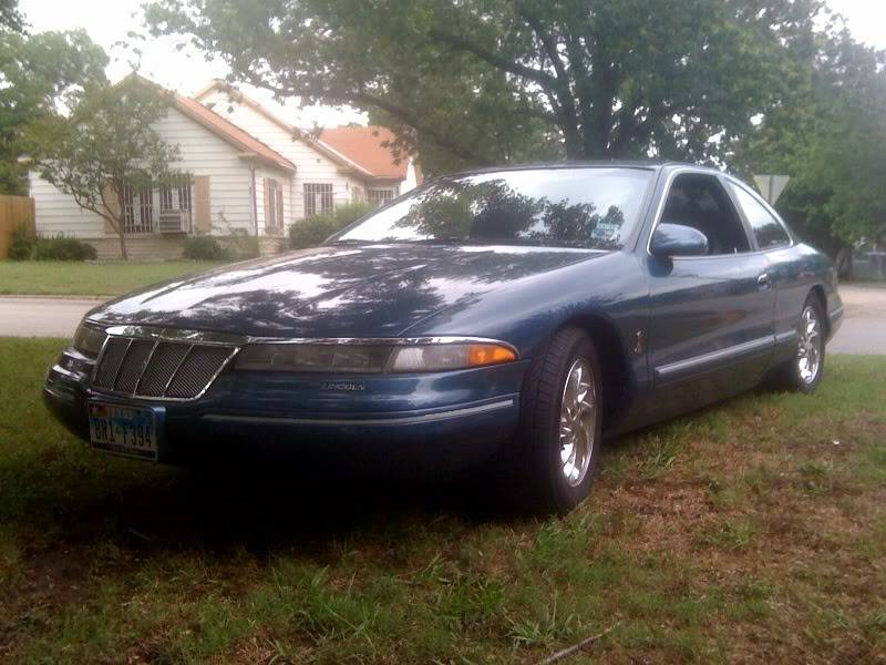

K, so Sapperfire got a used grill from some douche for his birfday. Was a little rough but he cleaned it up and then slapped it in today. :)
Hey! Don't be pickin on my favorite douche, I mean friend....
