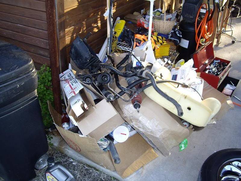

So just a shot of everything back together.
So anyone want to buy some nice quality, slightly used parts? :D :p

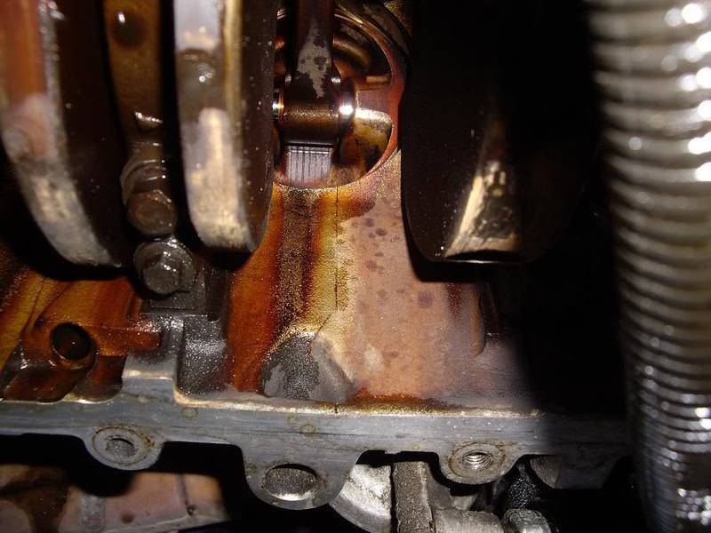

I am sure that is a casting line, If that was a crack you would know it.

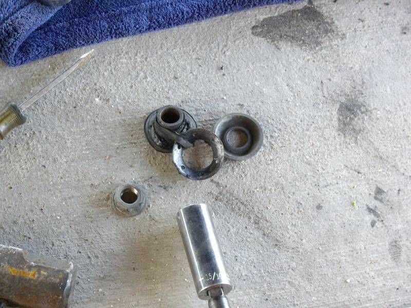

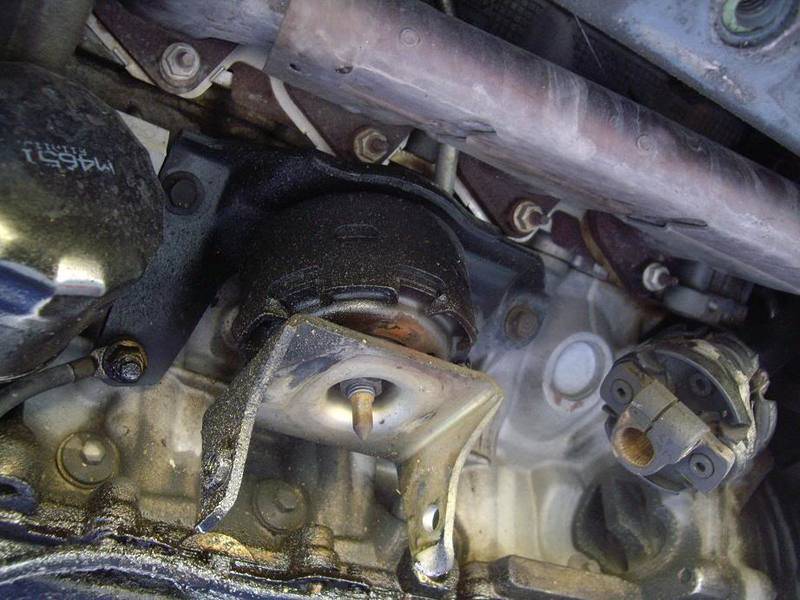

The rear strut rod bushings are shot but fortunatly he thought ahead and bought a set before coming out here to BFE. The can not being happy with no parts store runs decided that it would reward us with a broken engine mount. :( Any of you that have had to replace these before know the joys of trying to locate one anywhere. Fortunatly I located a parts store that had one and it was only 52 miles away. :lol:
So we are no back after the journey of getting it and will resume tomorrow.

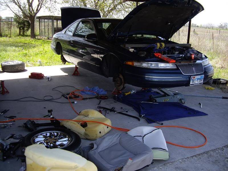

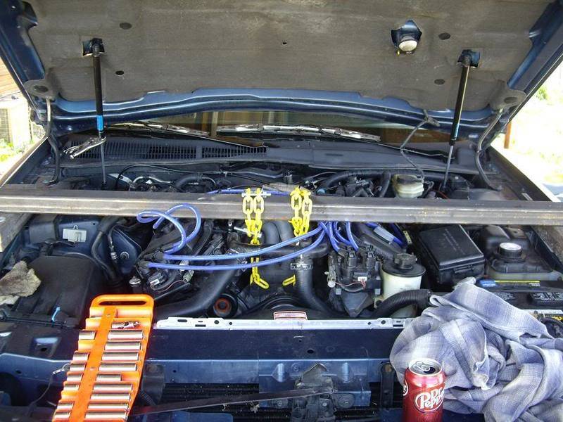

Here she is back up in the air and us multitasking by working on both cars at once.
Thanks for the alt idea!

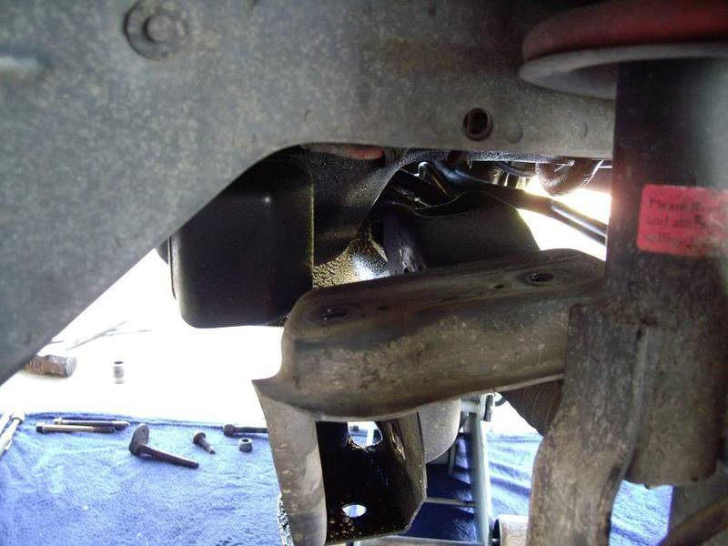

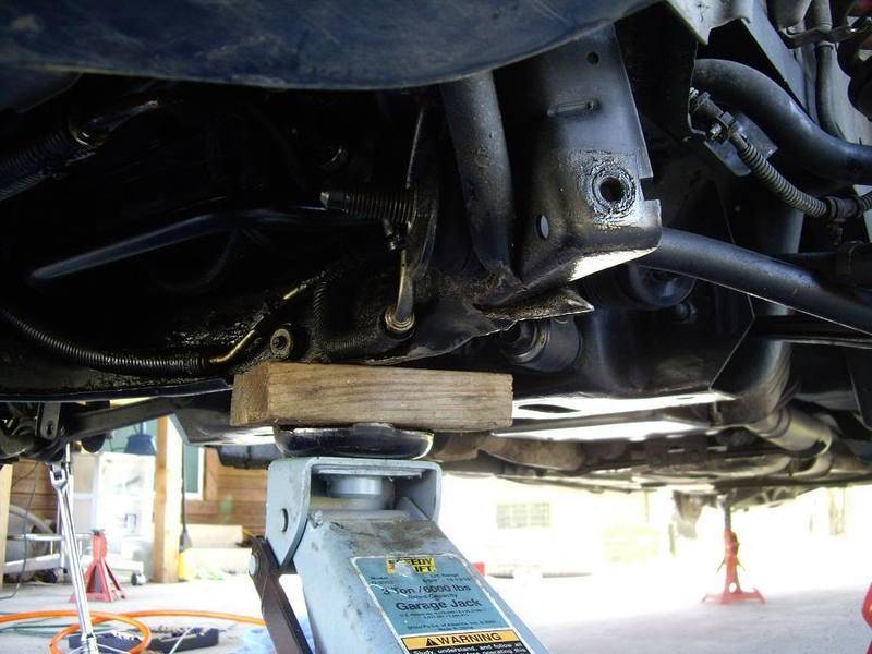

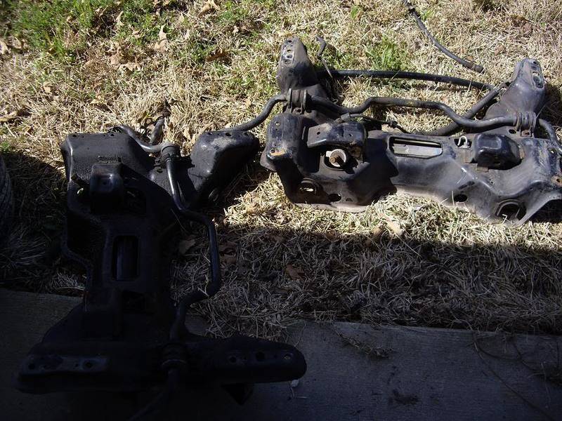

Here you can see just how messed up his cradle was. When I removed the front brace it almost shot off like a spring.

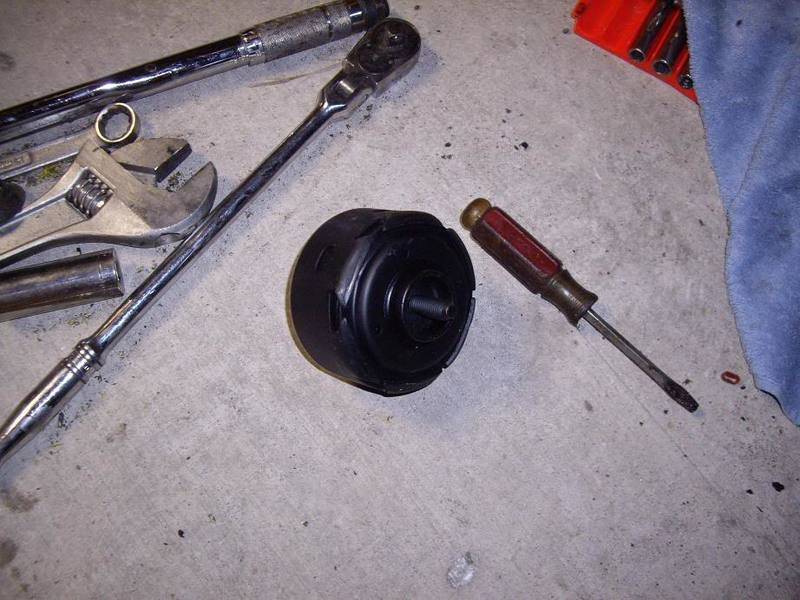

These may be worn out, not sure.

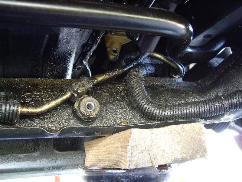

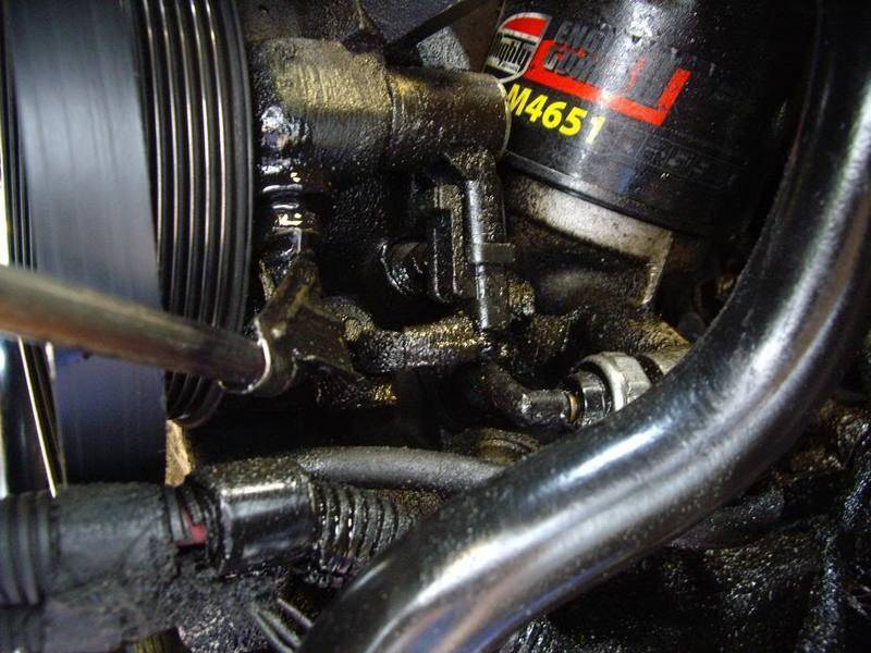

One of the many leaks that will be addressed, the infamous power steering line leak. Im sure 50% of us have had to deal with this leak.
Just a nasty mess but soon to be nice again.

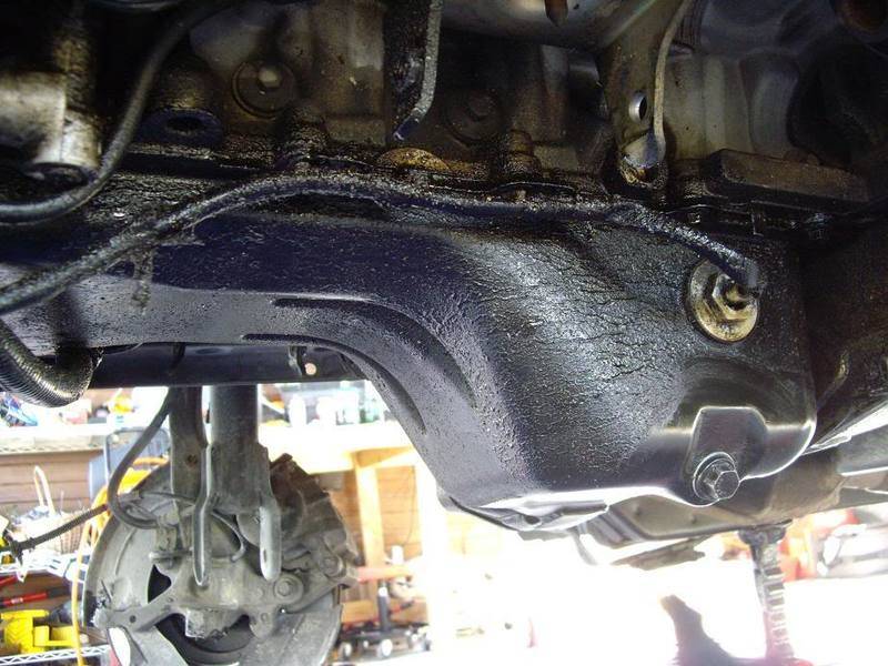

And the oil pan leak:
Finnaly lowering the cradle:

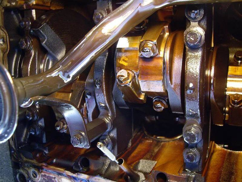

Just a shot of the inside. Oil pickup was clean but engine shows signs of early on poor maintenence. Did a couple back to back oil changes to clean it out and shes getting refilled with Synthetic. Engine runs like a raped ape so I am sure shes fine.
Fuggin failed mount. :mad:
And $100 and 104 miles latter:

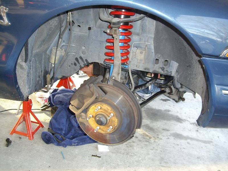

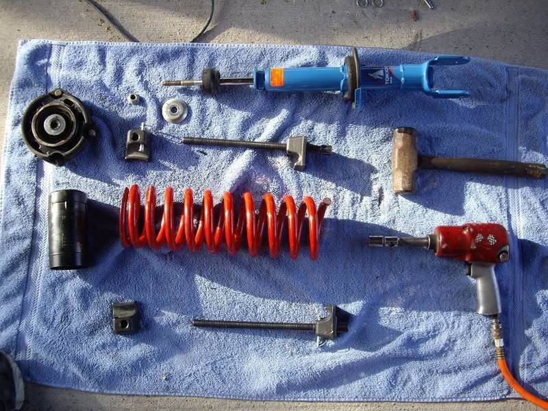

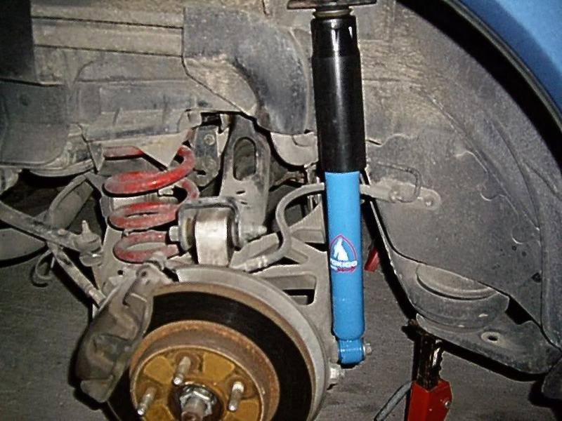

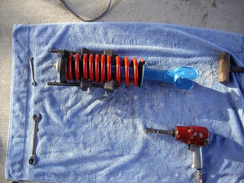

Next up was the struts. PITA getting the dang spring compressor in there.
And all pretty:

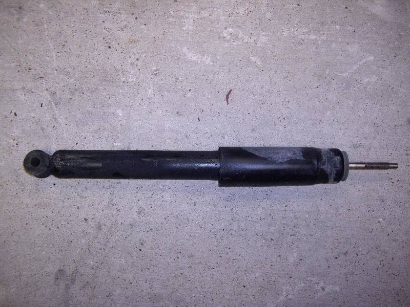

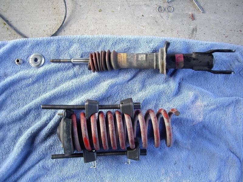

Both rear shocks were completly blown and the rear shock mounts were shot. Also one shocks lower bushing was about gone.

i would of just used the old school meth. use the weight of the car to compress the spring on the strut
Nope but if you want to come by and bribe Sapperfire I bet he would. Hes changed his 3 or 4 times in the past month so I am sure hes pretty good at in now. :lol: Hell he even did it in a Starbucks parking lot. :D

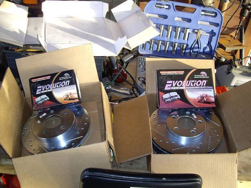

So....the new stuffeses,what was the costses?
Reason for asking is that I am in need of new rotors,they are scarred and I have a piece missing on the left rear. Note to retarded friend: Brake rotors are not good for prying.
Its $190 for the kit with rotors and pads all from Power Stop. :)
or you can have my old ones really cheap...like...free
but you hae to take the rest of Bills garbage with you
:lol: The brake lines cost as much as the pads and rotors.

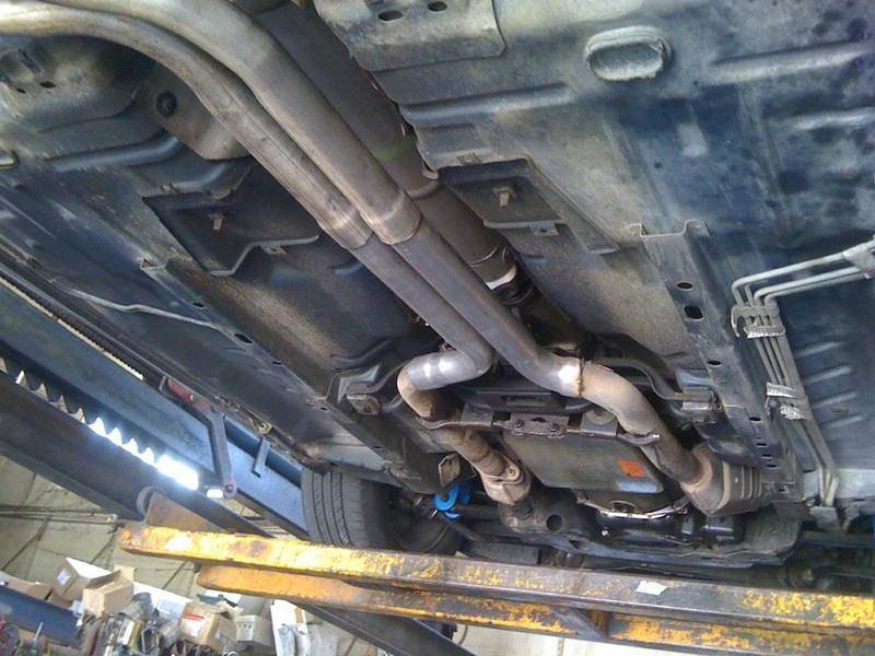

Installed my old exhaust on his car. Going to remove the nice tips off my green car so he can replace the bent ones on the setup I gave him. Also just ordered a X-pipe cause it dont sound too great at WOT. Car sounds like a GM 350. :lol:
X-pipe should help though.
