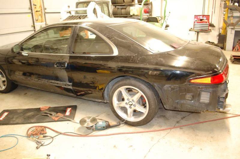

So I didn't accomplish as much as I wanted this weekend... but at least I did something!
That being said I have learned a few things, one Lincoln used some really thin, really poorly weldable metal on these cars, and two sheet metal work is not like riding a bike... if you stop you lose what little skills you may have had quickly :D

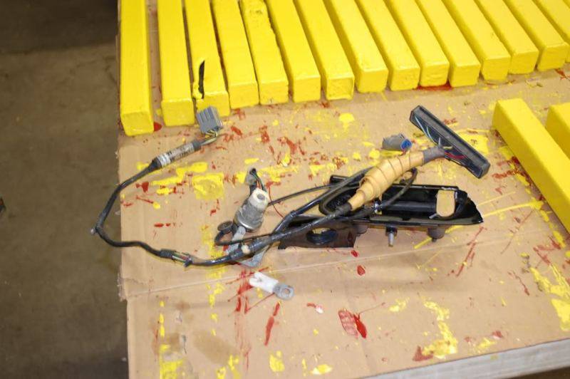

So I am waiting on the hinge and latch for the tail light so that is on hold... and I am not quite ready to tackle the shaved door handles, need to gather a few more parts for that as well.

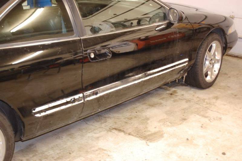

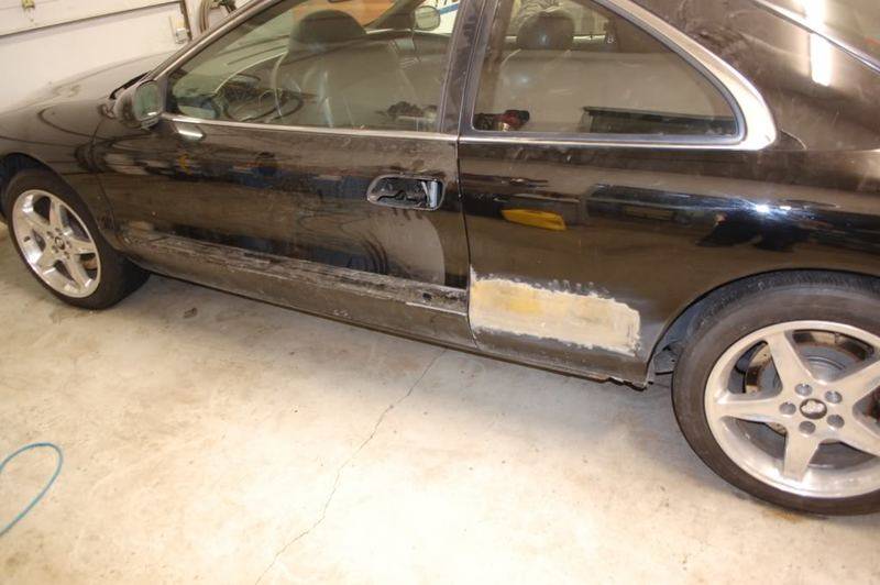

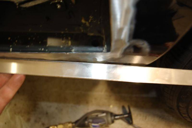

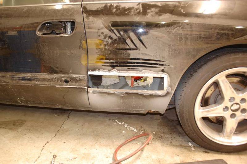

So what did I decide to do... Cut a big hole in the side of the car :D
Get rid of the useless stuff...
No turning back now :D

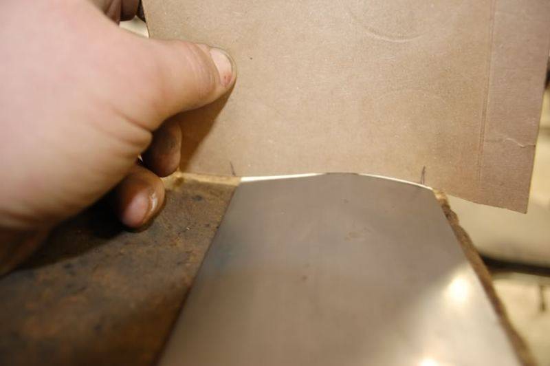

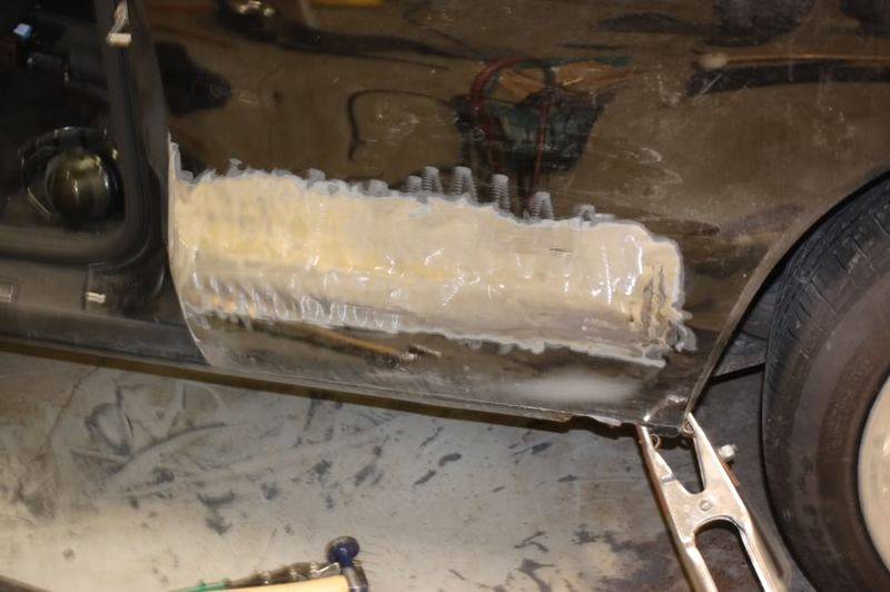

Well the flat metal doesn't fit at all... wtf :D No big just need to finesse it a bit!

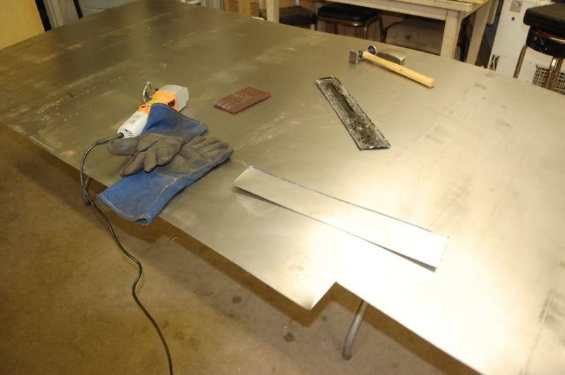

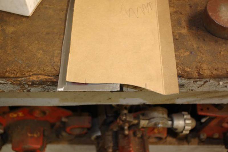

Contour Gauge

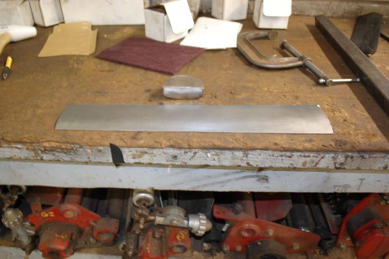

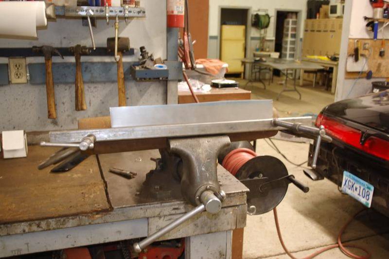

Precise rolling tool :D

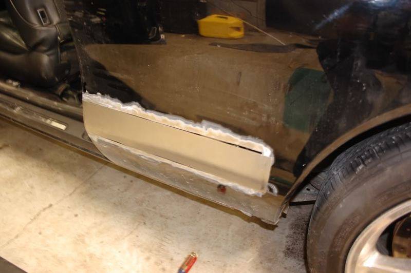

So you would think you are ready to put the panel in right... well not quite, the sides of our cars are very flat... but very and completley are two different things!

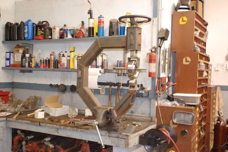

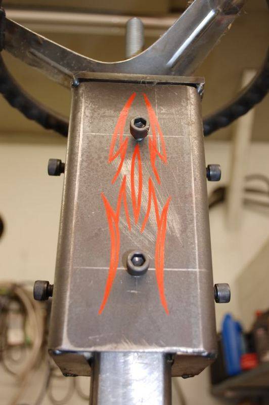

So you use the English wheel to give the panel a little dimension...
Wheel bling!
Pretty damn close!

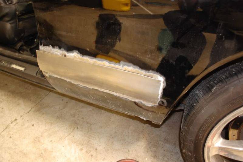

Weld it in and grind smooth/

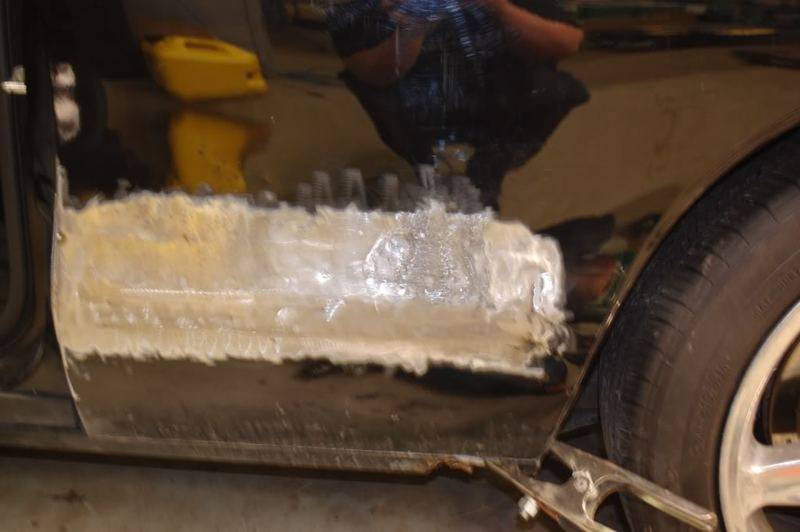

I had a horrible time welding the panel in... the Mark is ~20 gauge, maybe even a little thinner... my welder was loaded with .030 wire, way too thick... .025 would be much better...
So I had to fix a spot where I burned through severely...

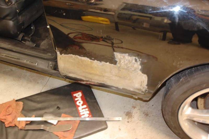

Due to my poor welding I had fits finishing it out... I was able to get it close... but nowhere near what I would like to see... sadly this panel will need a lot more filler than I would like. I'm going to do the otherside a bit different...

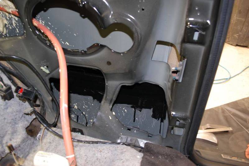

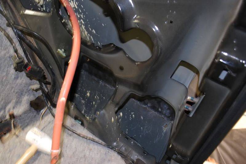

Inside
Put on some chassis black paint to protect it from rust.

I also believe Marks metal was closer to 22 or 24 awg. 20 was what older cars had.

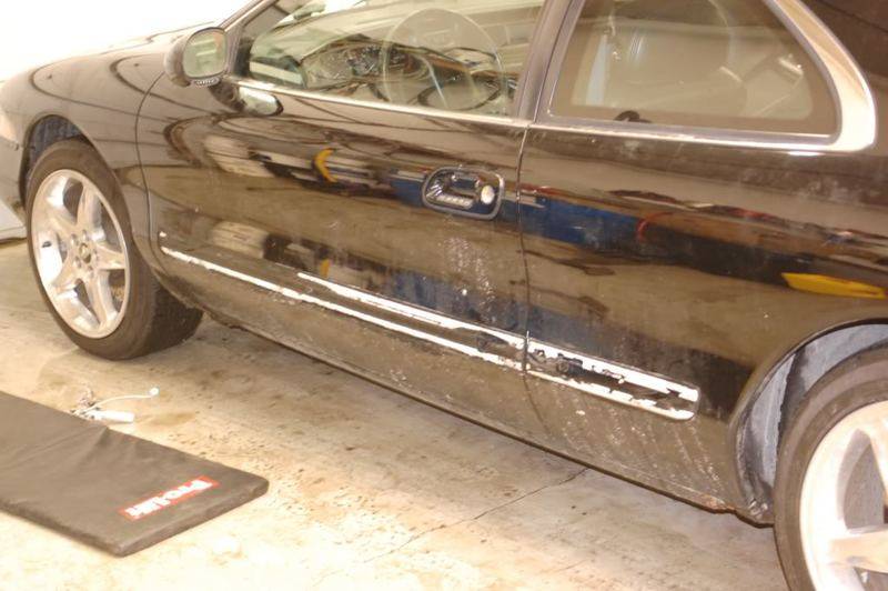

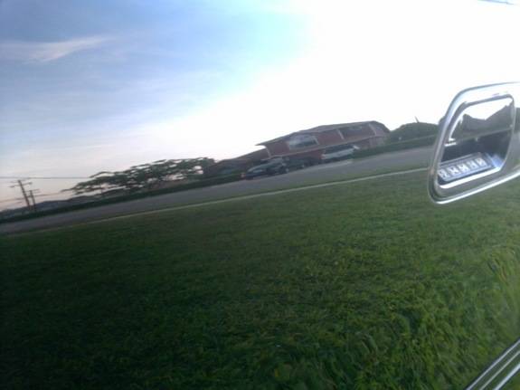

Looking good! Black is pretty. Ford put the blackest black on these cars, too, makes for a nice wet-sand finish.
Not the nicest example but an idea at least.

I am no body man but I just want to ask about your method. What if you possibly didnt cut out the channel, but maybe ground the outside of the channel and weld your peice to that? Just was thinking that it might keep the door from warping from taking such a long peice out of it. I am sure there is a method to your madness, but I was just curious.

Maybe also use the old door trim as a template for the new peice of metal... just thinking out loud...
I was thinking you'd have done this on the quarter, cut/grind your filler panel down to size so it sits in enough inside the radius of the groove, tack in the gap a bit btwn filler and edge of groove, then use kitty hair or a bit of mud, light block sand. Then run filler primer over the side of the car using more where your fab work is and block that out to finish up. With like, a 12" or 18" block.
