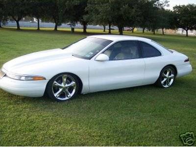

Maybe also use the old door trim as a template for the new peice of metal... just thinking out loud...
Thing is it's flexible, when it's laid out it's not the same shape as it is on the door..
And the shape isn't going to be the same either, the factory molding protrudes in center to assist in doors running into it, which he doesn't want in the filler piece.. he wants it more smooth
And he's working with a curve in every direction, the piece he needs to make for a filler piece has a curve up/down, side/side. Gonna take some patience for sure.

There are a couple big problems with trying to do this with one big piece, getting the shape is just one.
The LSC trim goes all the way threw the door seam, its a main part of the door stucture.
Cutting that would be a major mistake, unless you just work in that area.
Even then trying to get the door right in that area is going to be a major PITA.
The door is very weak all around the LSC trim, it bends and just gives too much.
I think if Brandon cut it out they way the rear was sectioned would make the door a scrap pile test door in a hurry.

Right, agreed completely,..
What I mean, is not to cut any of the door out at all, and do what I mentioned with his fabbed filler metal.. If you keep this in mind and re-read my last post, what do you think about it?
I never thought he would cut any of the car to perform this in the first place, really. Not that it's necessarily ''wrong''..

I just mean the outside shape of the filler panel, you would have to use the english wheel to round it out a bit, it would take some time but it would just keep you from removing that channel that is already in the door, most likely for strength in the first place.

Here is the problem with the door...
1: The inner structure where the door meets the quarter panel is intended for the moulding... if I don't fix that there is no way to make the door gap look right without an ass load of filler... What is going to to have to happen is I will have to cut out part of the inner structure and make a new one...
2: The bottom line of the moulding channel has a pipe running behind it... no access behind it, so after welding I can't do anything if it comes out warped or messed up...
3: It's a huge flat panel... it going to warp after I weld on it, no way around that... just going to have to fix it the best I can after welding...
If I were to make a filler and weld it above the channel if it came out warped or too low or anything I'm stuck... only thing left to do is start pilling on the filler until it looks good...
