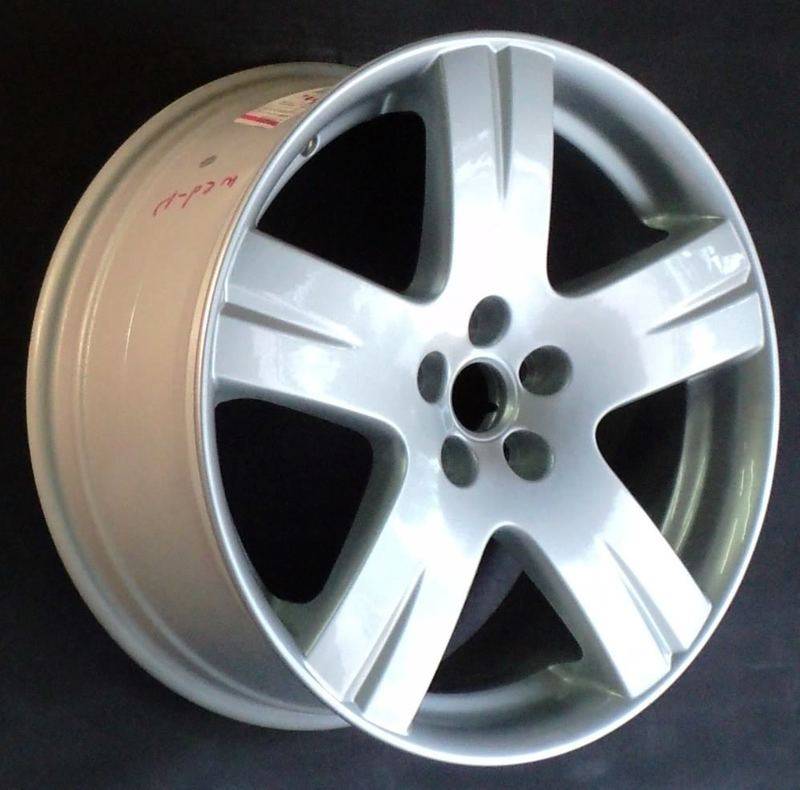

    I just don't get al these sizes and off sets along with the "rubbing"
    I've got the stock 17's on mine with winters,
    I need to get some nice rims and tires,
    looks like I should go 19 ... but, all these numbers confuse the hell out of me.
    I like these, both the looks and the price.
    http://www.usarim.com/jaguar-wheels-sku-270-19-inch-silver-with-machined-lip-rims-p-1670.html
    they are "however" the same rim as,
    http://www.usarim.com/lincoln-wheels-sku-270-19-inch-silver-with-machined-lip-rims-p-1671.html
    so if I was to get a set of these,
    what size of tires would I need ?
    I was told there could be ABS and speedo, tranny problems if you don't get it right.
    rubbing out be another concern.
    at the local Rim n' Tire shop here in town, the high-rollers are keeping
    the staff too busy with their big money and I can't even get a few questions in.
    don't know what to do as far as sizes.
    thanks for any help.

    Those will fit, but I hate it when companies don't provide the offsets available. You would need a high offset.
    Now my question for the masses. What is the lowest offset I can run in the rear on a 19x9.5? If I do a 8.5 in the rear could I go lower? And the front at 19x8.5? I don't want them sticking out, but I don't want bad rubbing.

    I don't follow along well with all this offset talk, I've never bought nice rims before,
    this is going to be my first venture into rim 'n tire land.
    anyone ever seen these rims on the LS's ? ( any pics )
    http://www.usarim.com/lincoln-wheels...ms-p-1671.html
    and would I be ok with 245/35 R19 tires on them ?
    whats a good popular tire to go with somehing like that ?
    thanks ...

    You'd be perfectly fine with 245/35/19. Depending on the offset and if you plan to lower it you could even go 245/40/19 that gives you a little
    More of a sidewall. I'm running 245/40/19. But my wheels are 8wide not 8.5 and my offset is +49 I believe. And I can lower and still have no issue.

    Nice choice of wheels.:cool: 245/35/19 tires are perfect. Thats the size I had before the 20's. Brand is a personal thing. I have had good luck with Dunlop.
