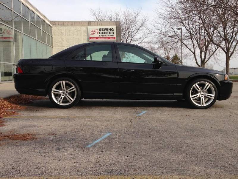

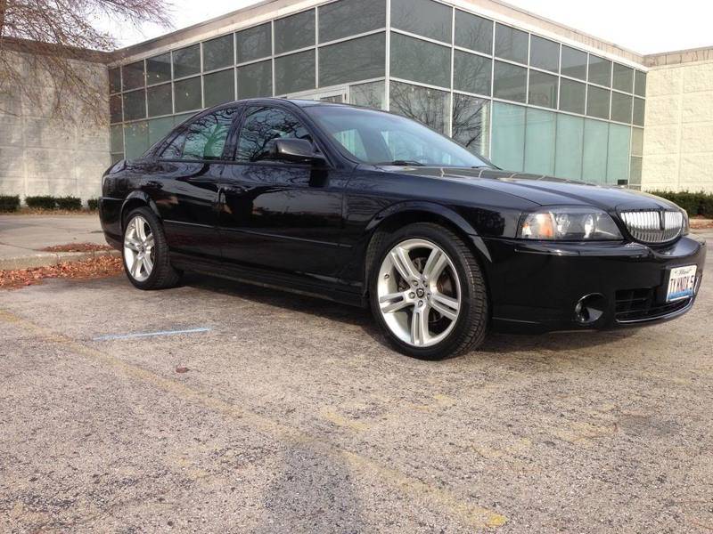

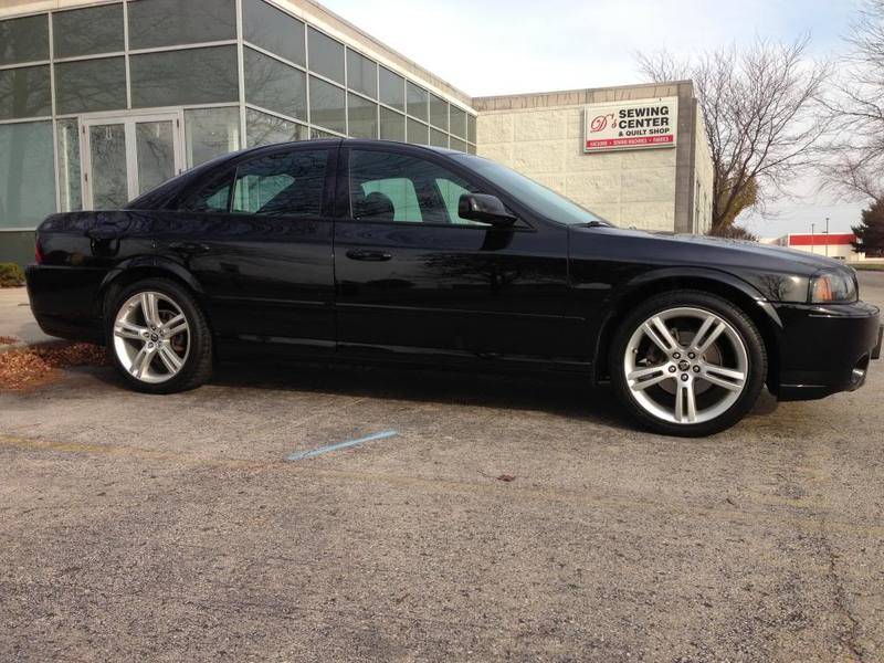

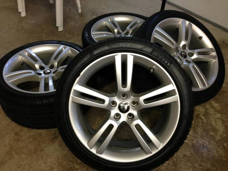

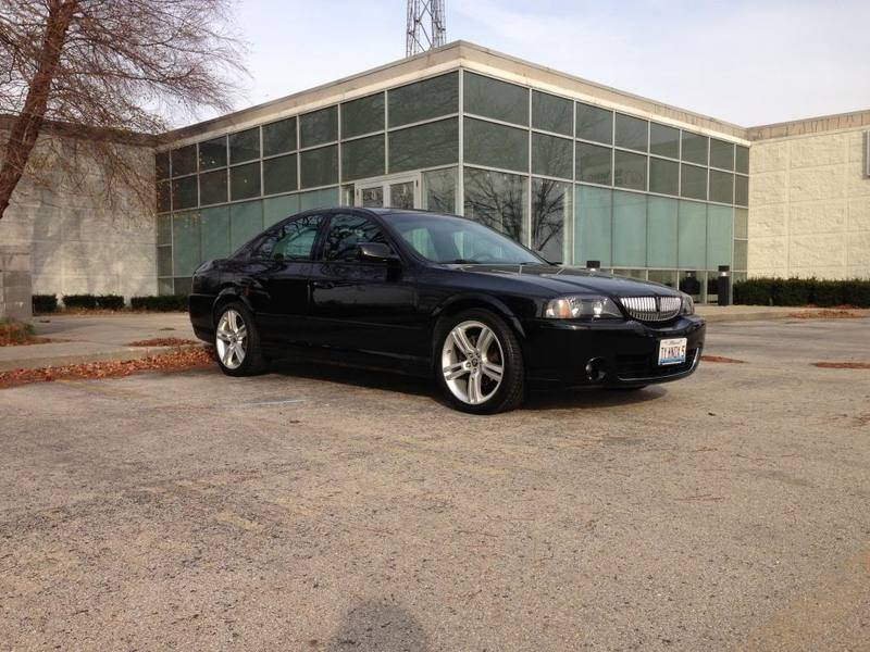

    OK, New wheels for the Database.
    Jaguar Jupiter Wheels. 2007-09 XK/ XKR.
    Note if you buy these you must get 4 fronts. The rears are 9.5 which would normally be ok but the offset is only 31+.
    Specs on a set of fronts:
    19X8.5
    49mm offset
    Tires are 245/40/19
    Silver factory finish
    Normally I am not a huge fan of silver wheels. I was going to send these in for a chrome exchange or maybe paint them gunmetal. But after putting these on I really like them and can see myself keeping a silver set for winter wheels.
    You'll have to excuse the dirty car, I was going to wash it for the shoot, but it may snow sunday night here. Also poor quality cell pics.
    Enough words, Picture time.

    As expected...
    fugging sexy!!!
    With a drop those would look even better. Side and rear shots are money! or T-money haha I needed one with the wheels turned for the front shots.

    Ahh, dammit.. I was going to do a few with the wheels turned, but you were texting me at the time and i forgot to do it lol.. Ill make sure to do that when the Barcelona's go on.
    and I know.. A drop is badly needed on my car.

    Those wheels look great on the LS. Sucks rear ones don't fit, but still. Lowering would make it look 10 times better, but regardless looks very very nice.

    T-Money, you only have them on the pass side because you didn't buy 4 fronts? Those look pretty darn good!

    That is correct, I bought a regular set off of an XKR. I knew the rears wouldn't fit, but I got the whole set for 350. so I will just sell the rears. and buy 2 more fronts eventually.

    Find anything nice at D's Sewing Center and Quilt Shop lol
    Sick wheels my friend. Awesome snag.

    I knew someone would say something about that haha. It actually isn't even open anymore it went out of business. So I was just using the lot.

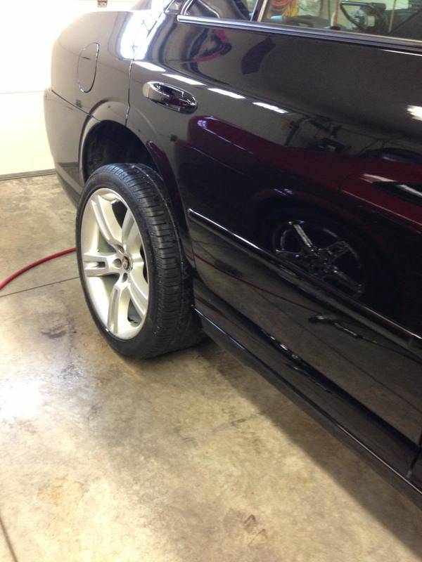

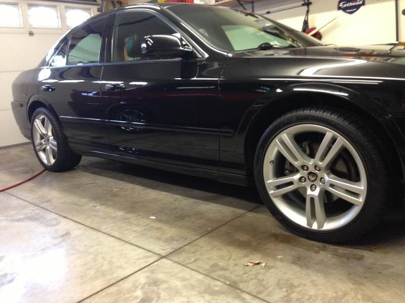

    You are correct. The XKR wheels have a 31mm offset in the rear so they stick out past the fender( Tmoney you should post that pic). The STR wheels are just as wide but have a 60mm offset which puts them nice and flush with the fender. You can still run pretty wide tires without rubbing tho. 285s fit with no issues on the 18" STR wheels. I may look into 285s for my Barcelonas when i get new tires. ill let u guys know how that goes...

    per mlaras request:
    Now in the pictures the car is still up on a jack. I was just throwing these on for fun to see just how far they would stick out. I should of just dropped the car down to normal height so you could really get the picture.
    19x9.5 with a 31mm offset :

    Maybe, just maybe, that could be pulled off if you dropped her low enough?

    Maybe if that's your style. I myself wouldn't want anything lower than a 49mm. Except those range rover wheels like bulls. That would be my exception.

    Yea those are really sticking out. Would probably work with stretched tires, but i would not do that to my LS.
