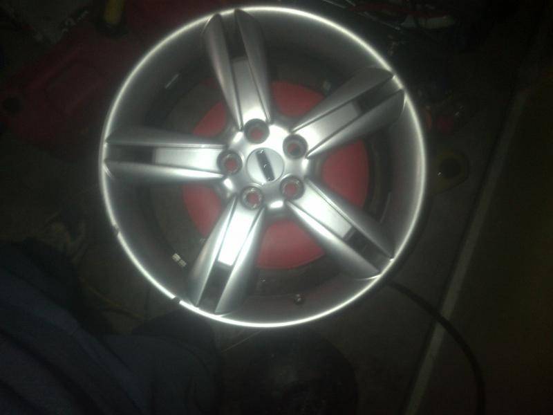

    Here is a picture of the worst shape rim.

    255 fits perfect, you can do 245/40 too. I had that size before. Look in my "garage" or some threads that i started for pictures.
    Wheel doesnt look too beat up. Good find.

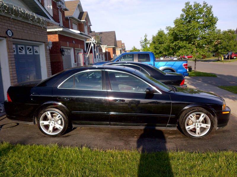

    I touched up the worst rim a bit and got a set of tires mounted on the rims. I couldn't pass up the tires, the price was too good so it has 245/40r18 Dunlop Star spec on all four wheels for now. I just wanted to get them on the car.

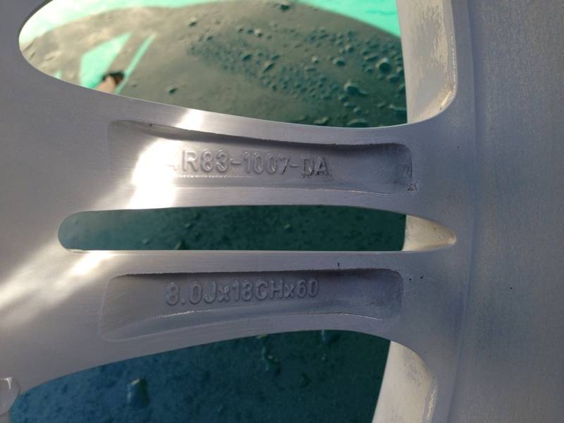

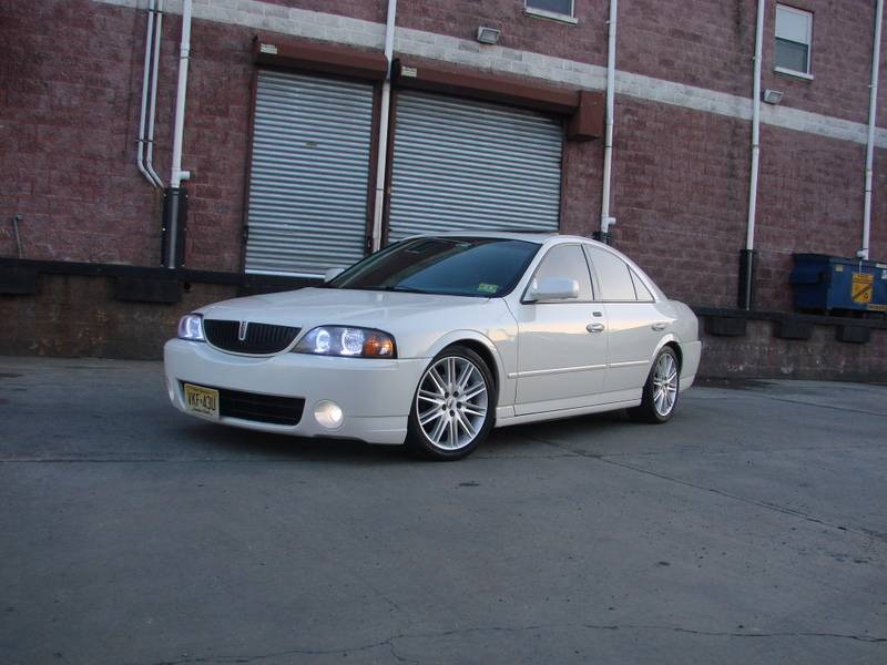

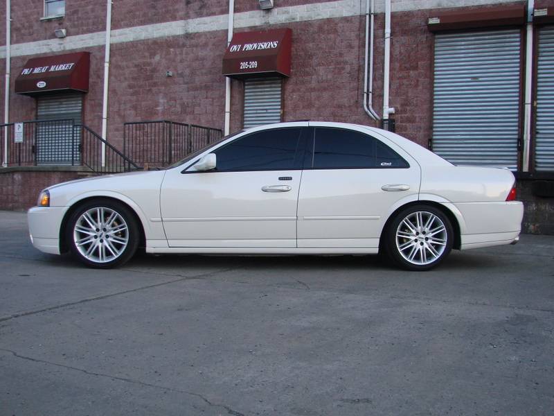

    Jaguar Triton Wheels: 18x8 ET 49
    ***Off a 2005 S-type
    Tires: 245/40
    Equipment: Eibach Lowering springs
    3
    4
    5
    6
    7
  8. HyeLifeLS
    HyeLifeLS Dedicated LVC Member
    Messages:
    5,152
    Likes Received:
    24
    Joined:
    Aug 23, 2005
    Location:
    Long Beach
    I like those! I thought those have an offset of 60mm.

    i'm pretty sure they're 49mm because they sit just like the Tucanas. I guess I just assumed since they're both 18x8 lol. I cleaned them today and forgot to check :rolleyes:
    i will confirm ASAP.
  10. mlara1129
    mlara1129 Dedicated LVC Member
    Messages:
    4,100
    Likes Received:
    37
    Joined:
    Jun 29, 2010
    Location:
    Tri-State Area
    Tritons have a 60mm offset not 49mm
    You were correct my good sir. These do in fact have a 60mm offset.
    On the bright side, this means you can easily fit a 20mm spacer(adapter) or maybe even 22mm for a flush look :cool:
