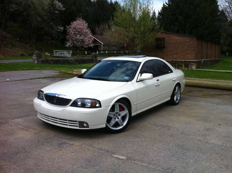

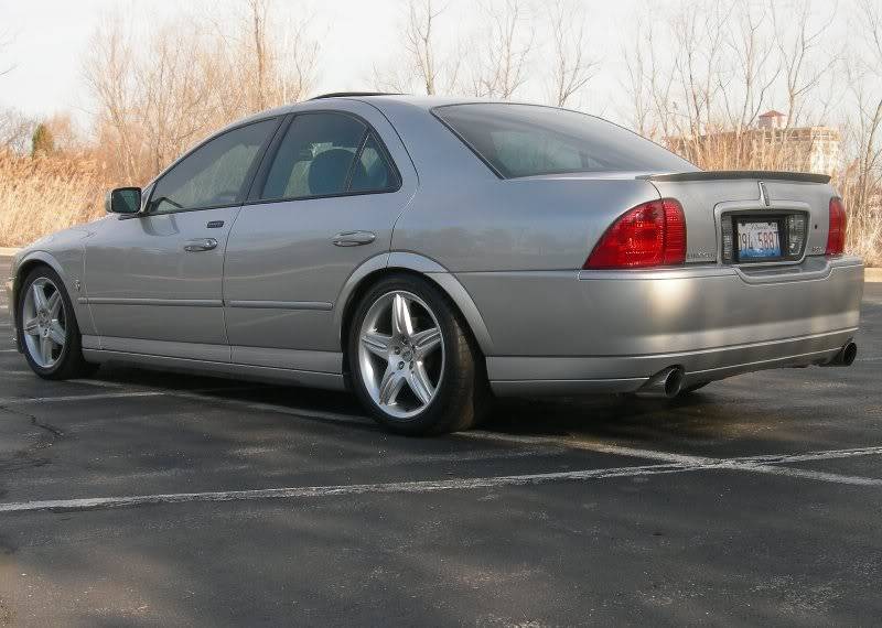

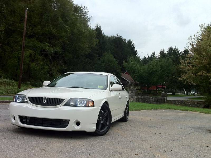

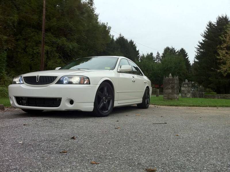

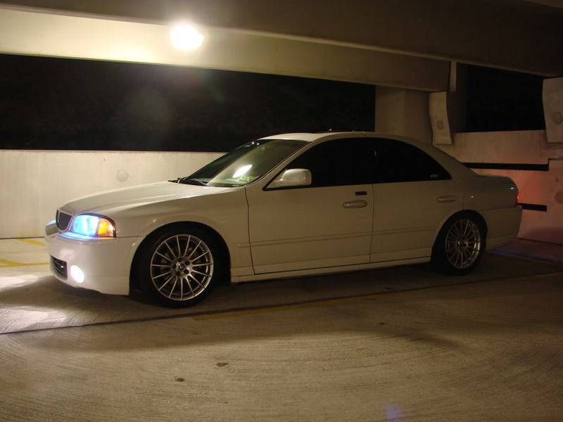

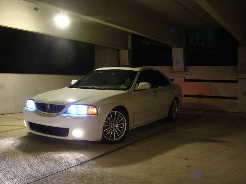

Zeus Wheels (From 03-04 STR)
Front:
Size—18x8
Offset—60
Tire—245/40
Rear:
Size—18x9.5
Offset—60
Tire—275/35 (Some have made 285’s work)
Equipment:
OEM Sport Struts
Eibach Pro kit Lowering Springs
Dark Charcoal:
Silver:
02V8Sport’s LS with 285’s in the rear:

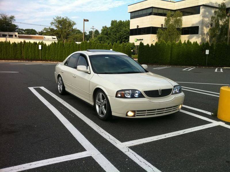

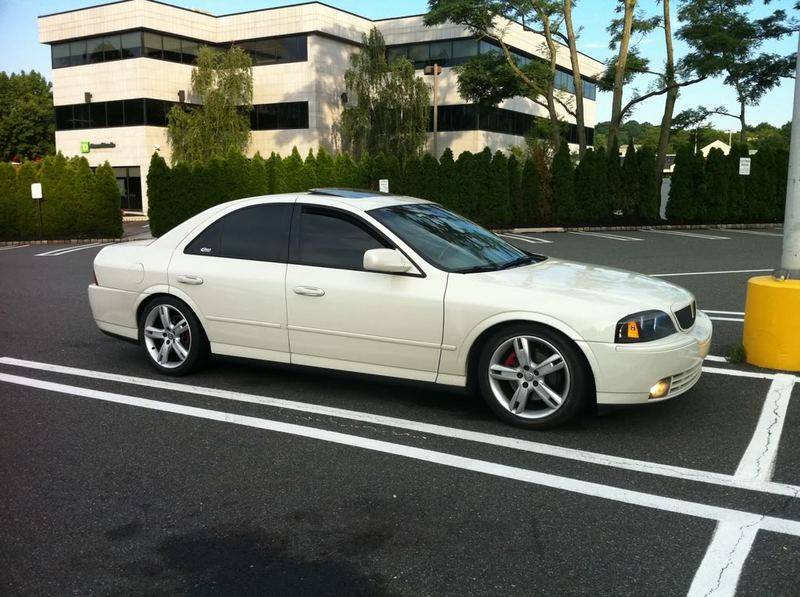

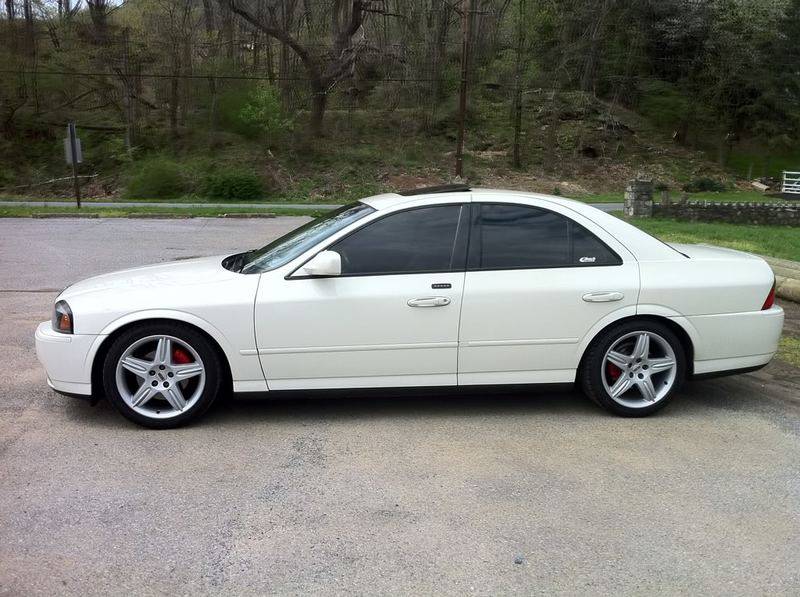

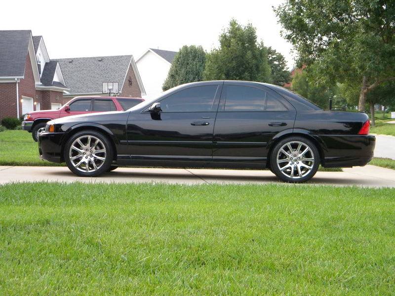

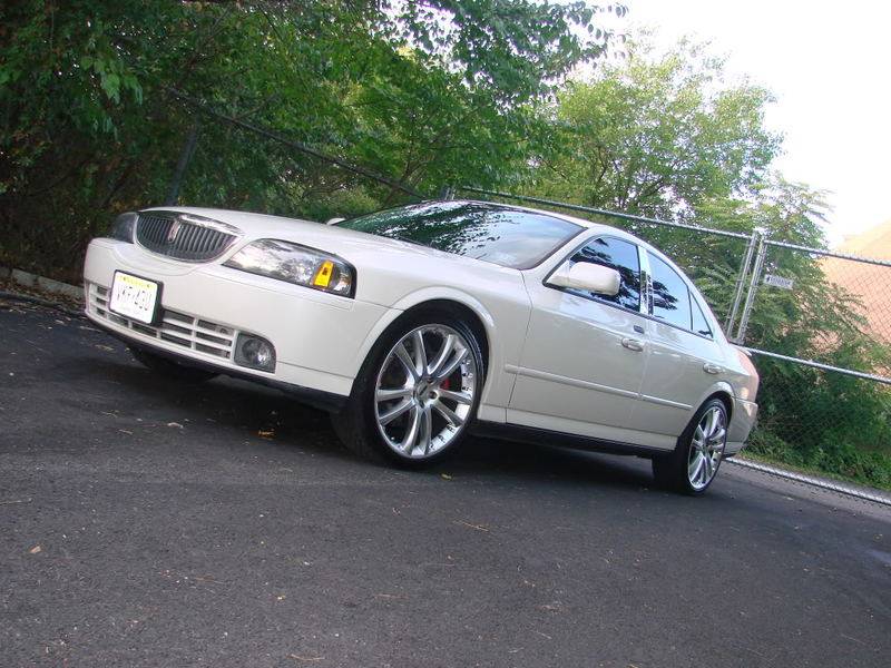

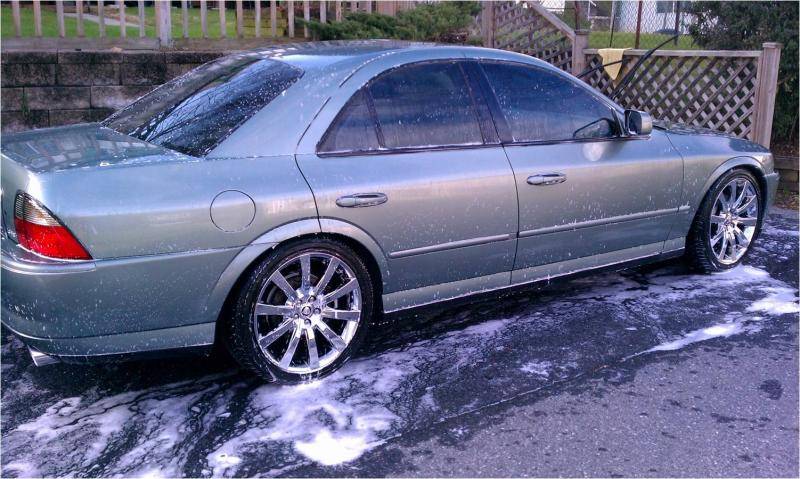

Senta Wheels (From 09 XF)
***Originally came equipped on Jag vehicles with 8.5” fronts and 9.5” rears. THE REARS WILL NOT FIT. You need 4 Fronts, 8.5”s all around. Replicas were also available from usarim.com, 8.5”s all around, but currently out of stock. ***
Offset: 49
Tire: 245/35
Equipment:
OEM Sport Struts
Eibach Pro Kit Lowering Springs
* Minor rubbing at full lock and major dips.
*Others have used 245/30’s and 255’s. Maybe they will Chime in with their experiences.
Stock Height:
Lowered:

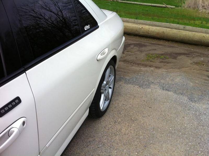

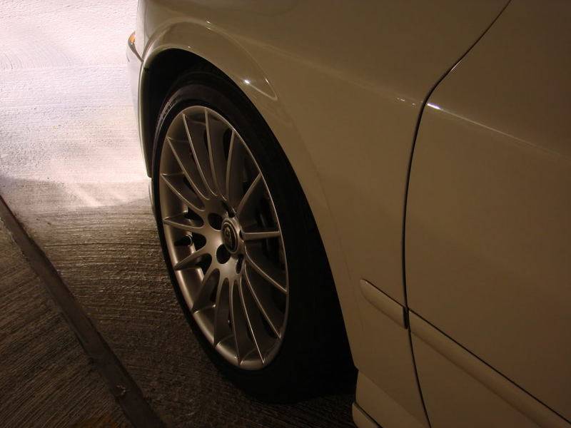

Tucana Wheels ( From XJ8)
Specs:
Size—18x8
Offset—49
Tire—Currently using 225/45 front and 245/45 rear.
*Love the look in the front, not so much the rear. Too much sidewall, will be likely going with 255/40’s in the summer time.
Equipment:
OEM Sport Struts
Good thread! Sentas with 255/35's rub pretty bad when lowered, and I would reccomend using a 245/35.
Good thread. Those Tucanas are beast mode. They look like 19 s even.
Love the Tucana wheels! Those are my favorite Jag wheels. I've wanted a set for a while now... just can't get the wallet open that far:rolleyes:

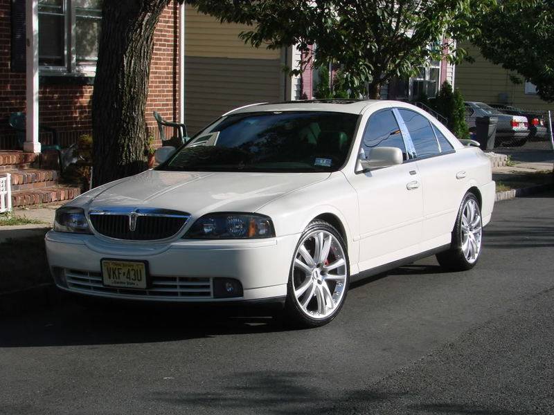

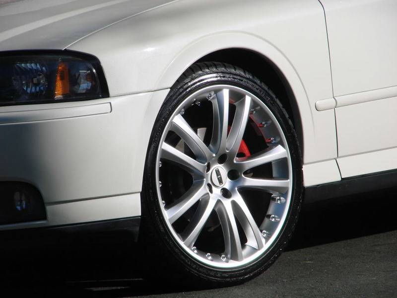

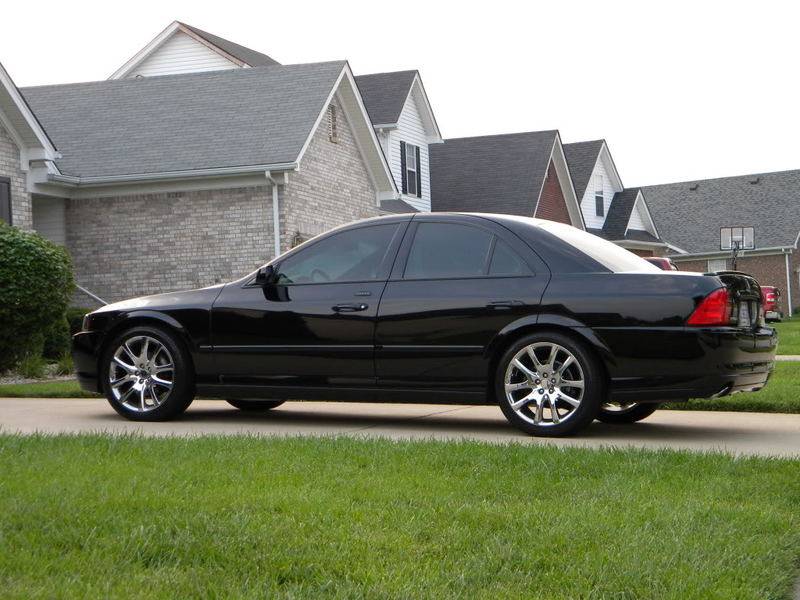

As per Mlara's request, I'll include my wheels.

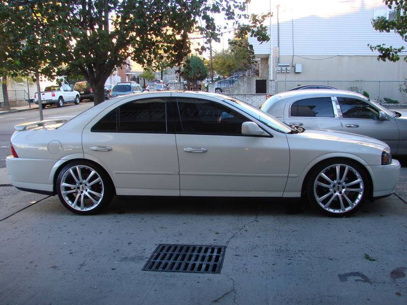

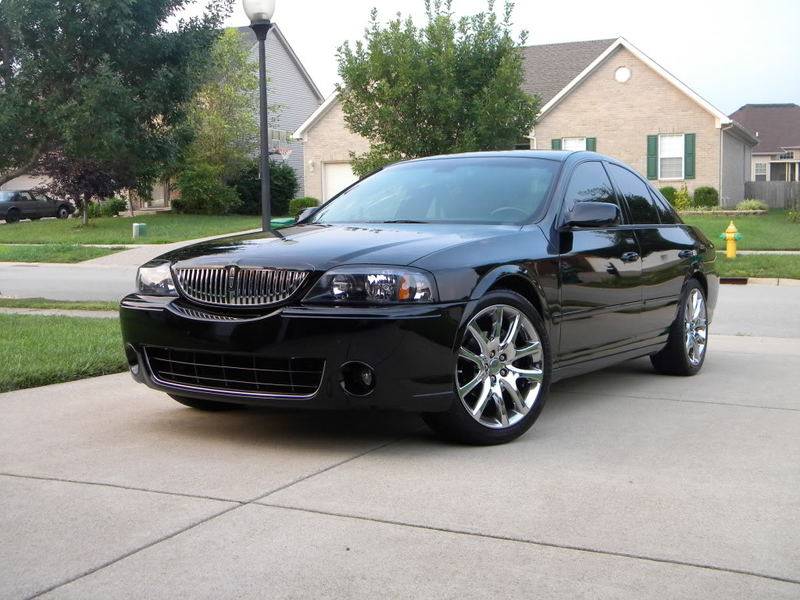

19" JAGUAR XF CARELIA - CHROME
(I believe you can find these in silver as well)
The set I bought had all four wheels the same size - 19x8.5 with a 49mm offset.
I'm not sure if my set was pieced together (2 front sets) or if some Jags came with all four wheels the same, but I know for a fact that some sets have different (wider) rear wheels which won't work on the LS as the offset is different.
A staggered set would be 19x8.5 for the fronts with a 49mm offset and 19x9.5 for the rears with a 31mm offset (which won't work). If you can find all "fronts" then you're golden.
I'm currently on Eibachs and have no rubbing issues.

where did you pick these up from ?
Thanks Xford
I got em from ebay...I don't like to brag but I will :p - Paid 600 for wheels and practically brand new tires shipped to my door. The seller didn't really label them properly and I accidentally (luckily) came across them.

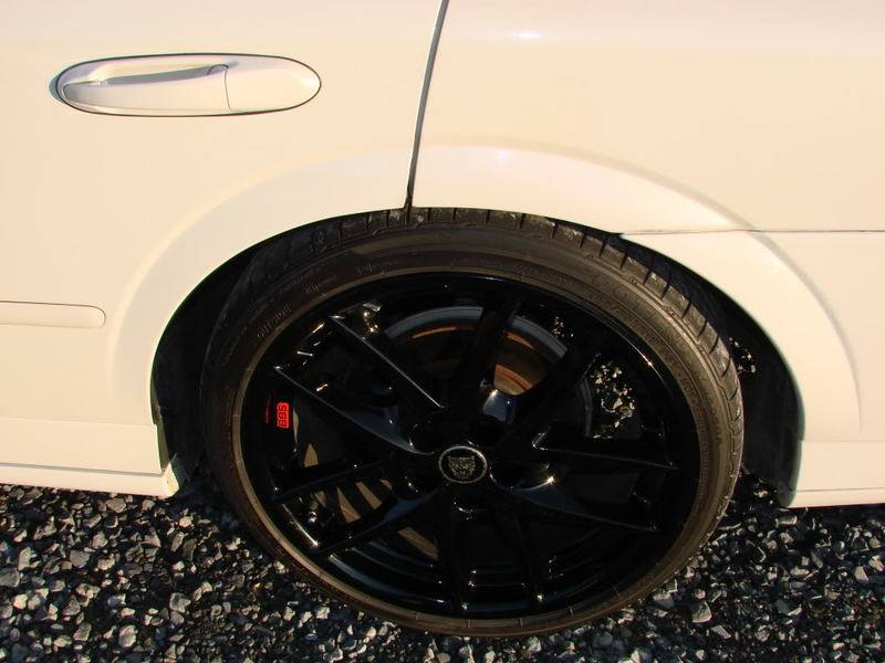

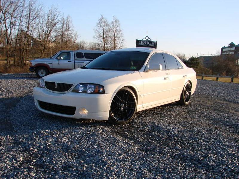

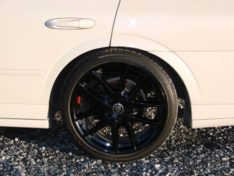

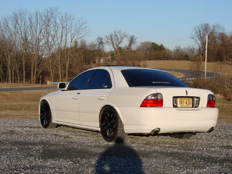

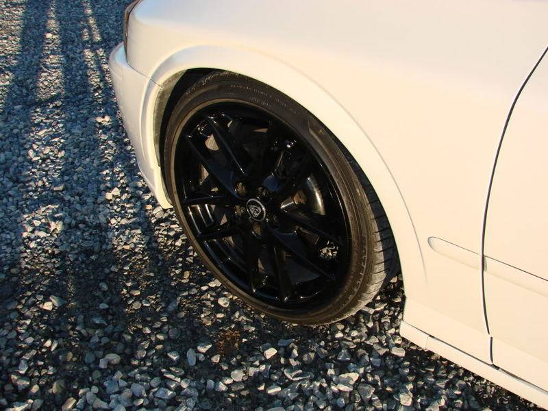

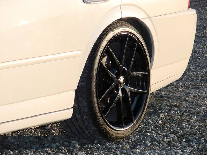

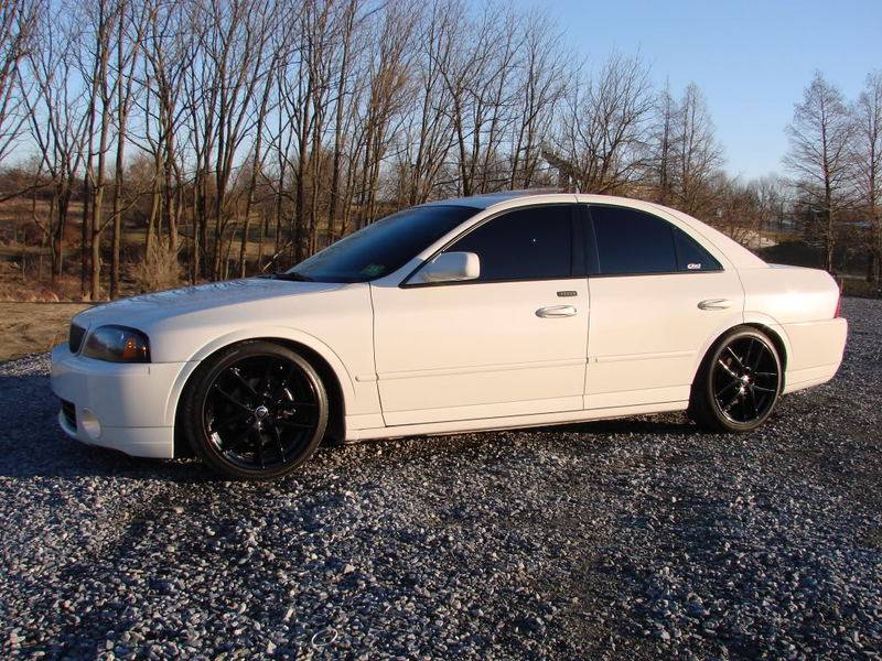

Barcelona Wheels (08 STR)
Front:
Size—19x8
Offset—60
Tire—225/40 (Stock size: 245/35)
Rear:
Size—19x9.5
Offset—60
Tire—255/35 (Stock size: 275/30)
Equipment:
OEM Sport Struts
Gloss Black Powdercoat:

Oh how i wish i could be pm'd with these barcelonas photoshopped on my car lol:)
Front:
Size—19x8
Offset—60
Rear:
Size—19x9.5
Offset—60
Equipment:
OEM Sport Struts
Shadow
Dirty Wheel

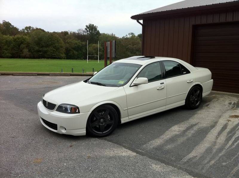

Mlara If you ever want to sell either set of the black jag wheels you have let me know. I really like your car, have to say its in my top 3 LSs
wow thank you!
I sold the dark charcoal zeus wheels a couple of months ago, i only have the barcelonas and a set of sport edition wheels im working on (basically sold as well), unfortunately i can't afford to hoard jag wheels lol
A couple other people are in line for these before you lol but ill keep you in mind.
