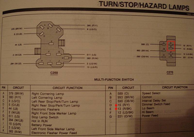

This is an FYI for somebody who recently PM'd me regarding the MFS pins. This picture highlights the pins I bridged - compare this with your book - it's possible your book just numbers differently.
I just got my 5000K HID's installed on my '96 yesterday. I put them in the low beams first. I'll be doing the MFS mod soon. And I'm also planning to put a set of HID's in the hi beams too. And maybe some day, I'll have the time and energy to pull the housings and clean and re-chrome them. I've got everything I need, I'm just putting it off cuz I'm lazy.
