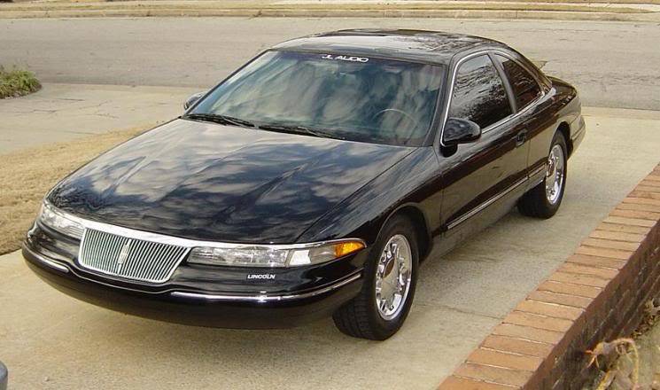

This just an idea of what they look like in my residential area and no, they were not aimed when I took these pics last night but now they are aimed. It's been raining here and I found that having a long stretch of street in front of you works best when aiming these.
WOW. Something must be seriously wrong with mine. I have the 6000K white HIDs and I still cannot see worth a damn. I know part of it is in the aiming, but one of my housings is almost brand new. I guess I have to pull the front apart and see if something is bent, not allowing me to aim them correctly?

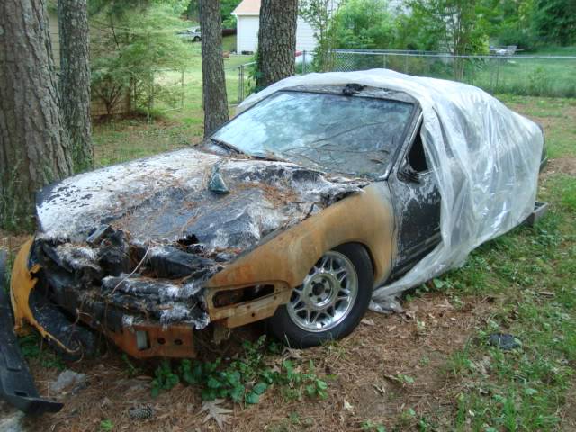

Hah, I was right, my friend insisted my hood is aluminum, but that picture proves it is fiberglass. Maybe his 97 has an aluminum hood.
No, the housings were still like new condition. I blew the car up and it burned.
Damn. Might I ask what started that?
You having a Gen 1, your hood is not aluminum but the 97 and 98's are. My stupidity of messing with injectors and not checking for leaks before starting is what lead to that. It happened while at idle, inside the garage. Knocked the back wall 8" off a concrete foundation and blew all the windows out of the garage and warped 2 steel doors in the garage. I was inside the car with the windows up and only suffered a cut leg from jumping out into the driveway into glass. That's all I got to say about that. :)
