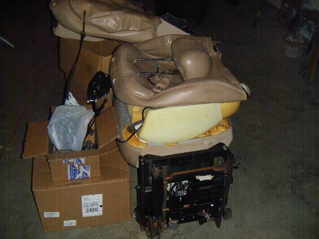

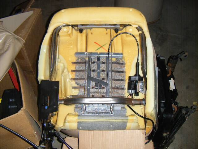

Well, seeing Magneto's progress thread motivated me to start taking apart my spare drivers seat so that I can swap the back frame and cushion to mine.
Pretty uneventful, I've had alot of experience swapping power/manual buckets and benches from town cars into Marquis and vics ect. This was easy peesy.
Might finish it before winter, not really in any sort of rush. Also have to decide if I want to sell the seat track or not.

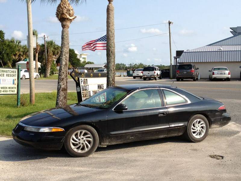

owned the car exactly a week now. didnt have time to really mess with it last weekend, so i got a few things done today.
1. removed chrome wheel arches
2. installed 6k drop in hids
3. air bag sensor 'drop' to lower the car.
dont have any before pics... fail on my part but here is how it currently looks.
Nice stance. Now get a pin stripe remover wheel and put it on a cordless drill and get the pin striping off. You'll love the difference it makes. The wheel I used on the black 94 I had was made out of some kind of hard rubber like polyurethane but I done the whole car and used a compound when I had it all off. The whole job from start to finish took me right at 45 minutes. Looked much better.
