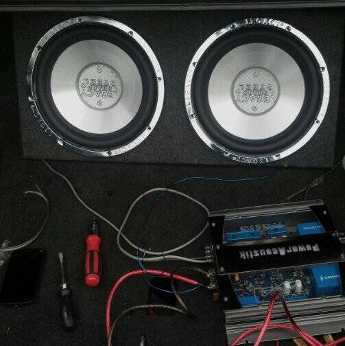

Finally got around to installing a system into the LS. Ran into a problem trying to fold the rear seats during the process

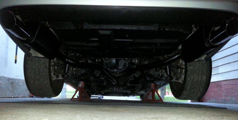

Painted exhaust tips, painted calipers, wire wheeled thottle body/any rust underbody, painted misc trim, still have yet to wash/wax/clay bar exterior...gotta be prepared for the summit show tomorrow

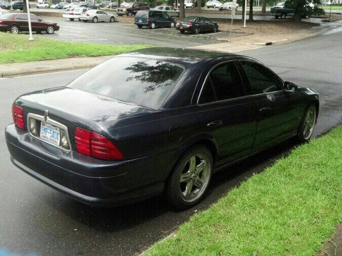

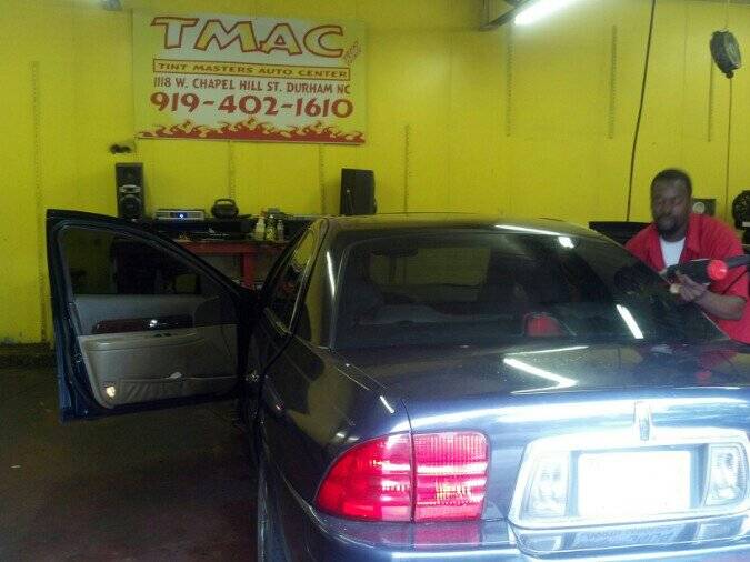

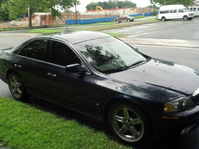

Finally got the windows tinted today
20% on the doors, 35% back windshield and no tint on the front one

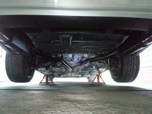

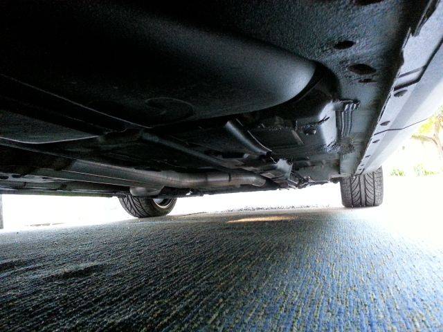

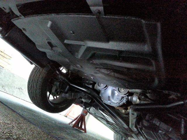

Having just way too much fun today with the LS undercoating.
Nice and hot out, sticky spray, makeshift garage ventilation, BBQ and cold drinks.
BigRig style. Should be stumbling by 4 (at least that's the goal, give or take)
before: ( one Canadian winter )
after:
European Texture Rubberized Gravlguard PF 560 ~ http://www.proformproducts.com/en/products/info/?product=17&category=4
and VHT high temp paint was separately used on the exhaust.

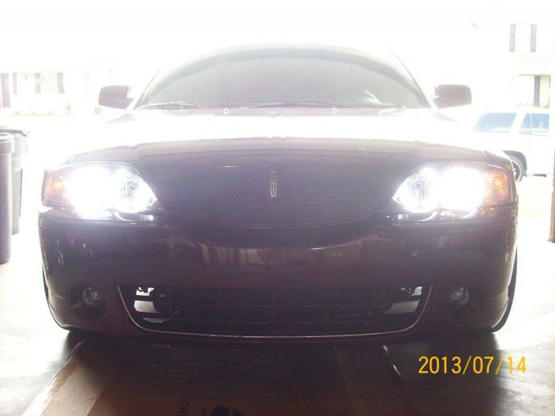

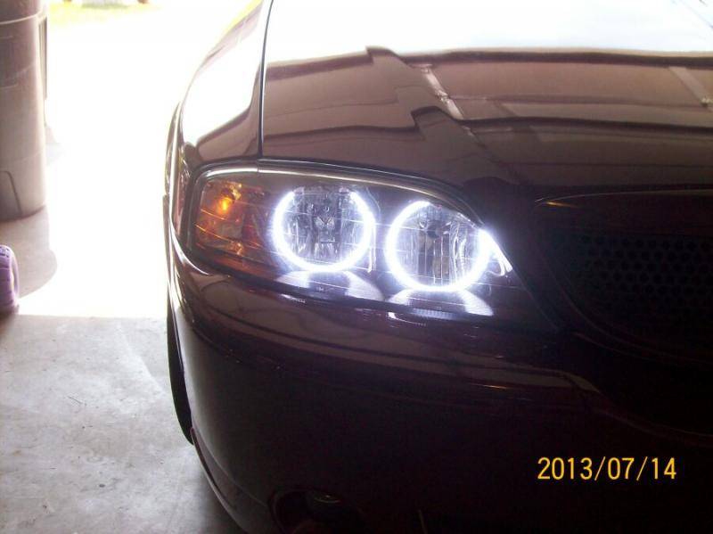

2 years ago a former member here gave me a set of HIDs. I had forgotten all about them. Last weekend while cleaning out the garage. I found them. I installed them this morning. Only problem. If you can call it a problem. My foglights work when the parking lights are on and when the high beams are on. Foglights will not come on when the low beams are on. Which is fine with me. I have high beam bulbs in my foglights. When me high beams and foglights are on at the sametime, I have 2 sets of high beams on the road. Needless to say. The first SOB that wants a high beam war. Is going to get blinded by me....:N
Pic 1 angel-eyes
Pic 2 HIDs
Pic 3 high beams with foglights
Pic 4 HIDs
Pic 5 high beams with foglights
Sounds like a wiring "problem". The fogs aren't supposed to be energized with the highs. However....... Whatever works for you!!!!!!!
Unexpected Mod Rollin! +1
Hmmm, something is reversed is it not? shouldn't it be ... fogs on w/ low beams, fogs off w/ high beams.
at least that's how mine behaves, the fog lamps cancel themselves out when high beam is selected.
at least that's how mine behaves, the fog lamos cancel themselves out when high beam is selected.
Yes, it's supposed to work that way. The fogs don't do much with the high beams on as the highs overwhelm their output.

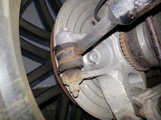

Did find this problem today though, guess it was only a matter of time. may as well do the end links as well.

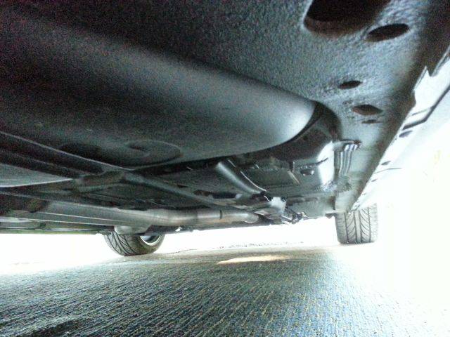

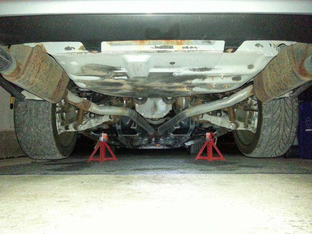

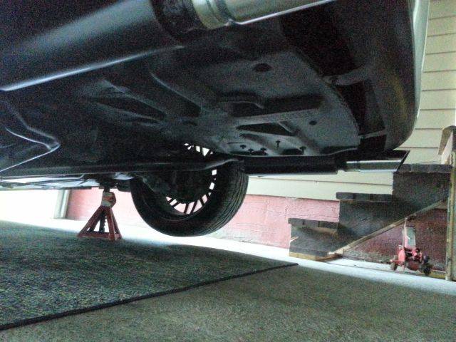

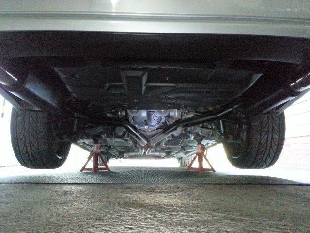

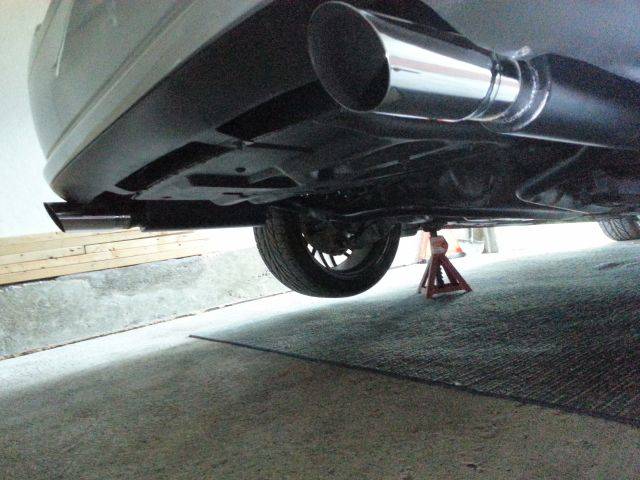

after:
European Texture Rubberized Gravlguard PF 560 ~ http://www.proformproducts.com/en/pr...=17&category=4
I'll be putting this on my to do this for this summer
Did you prep at all or just spray right over the rust?
Why the hightemp paint on the exhaust and not the gravelgaurd?
I did some prepping but how much surface rust in one going to get without sand blasting.
I managed to get along the frame rails on each side with a steel brush on the drill end.
then just covered it all with the gravelguard, 2 cans worth.
cleaned up the exhaust, used all sorts on that including rough grit sandpaper, steel brushes.
I had VHT high temp paint laying around and didn't think it would be a good idea to put the rubberized gravel guard on the hot parts.
That stuff hardens up like no tomorrow, same stuff as for doing pick up truck bed liners if you will. Don't think it likes getting hot.

Looks good and it will protect the undercarriage for years to come.
