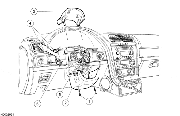

Weird. I'd look for some of the wiring being misrouted and rubbing against the steering column shaft.
Edit: I guess that alternately it could be a badly worn multi-function switch that is failing. Of course, the 2003 switch is different than all the other years (AFAIK), and very hard to obtain anymore.

Certain position as in up/down tilt and/or in/out telescope? If so, this would likely be an issue with the wiring to the connector to the multi-function switch or even might be that the connector isn't fully seated. Remove the two screws that face down from the bottom half of the column trim cover, then snap the two cover halves apart. Then you should be able to get to the connector and wiring.
Thanks Joe! My Turn Signal is acting weird; Having to push that 'Ball Looking Socket; at times where the arm connects to the Steering Colum to keep working. This diagram helps as I was wondering if it was going to be involved with the Air Bag.. Like I need this kind of 'Take for granted' problem.
Out of all of my other vehicles I have never had a turn signal problem other than due to a replacement flasher. This car is driving me crazy!

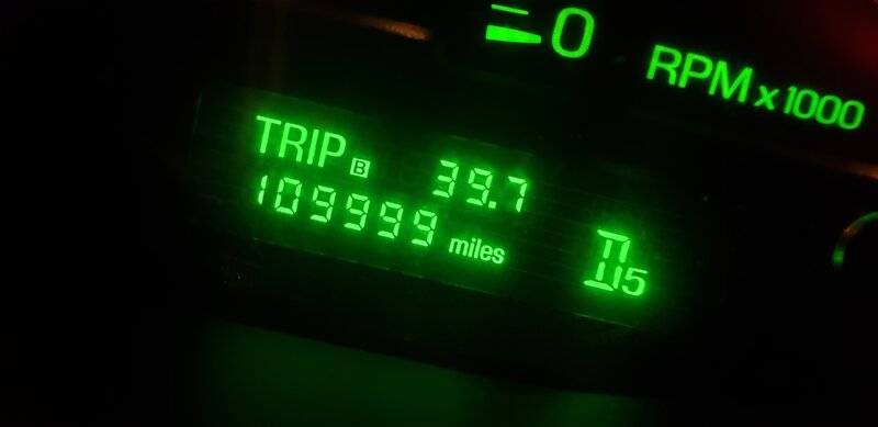

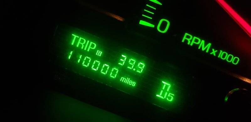

Took her to 110,000 miles...reluctantly. She's been a feisty one, but I hope to have her money eating ways (temporarily) tamed when my next paycheck comes! Gonna bring her to the shop that the 2nd owner took her to ever since he got it 15 years ago.

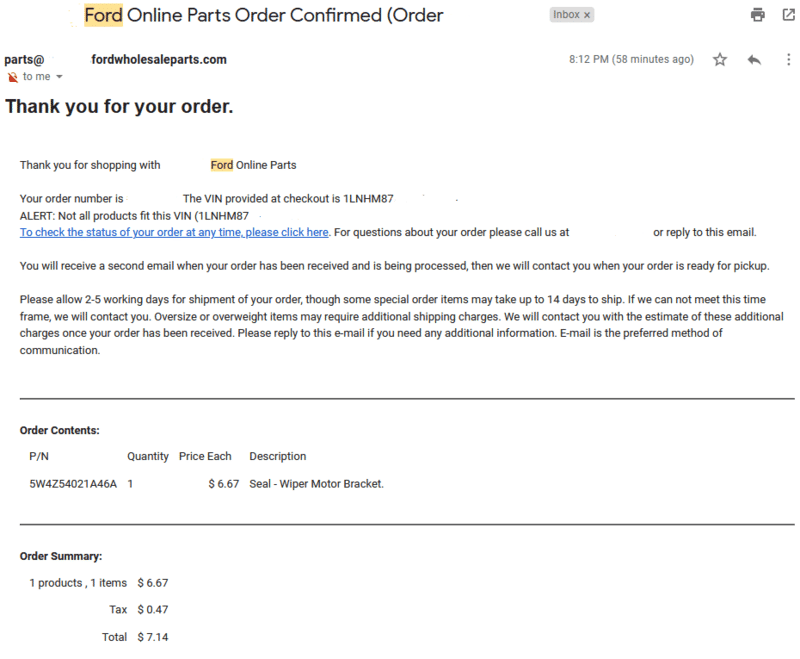

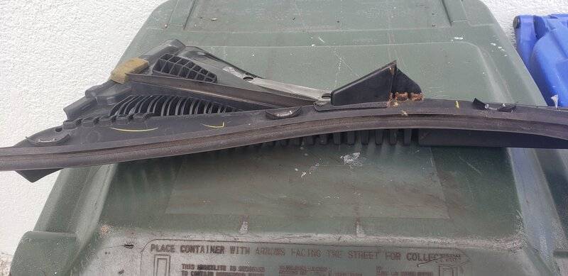

Ordered the part to fix my problem with water getting into the spark plug wells and fouling the COP's out.

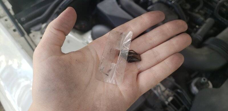

Made a rookie mistake when attempting to fix my wiper cowl leak, completely broke the clips on both cowl pieces.
I do not belong near a car. Oh well,, time to go scrounge the local salvage yards.

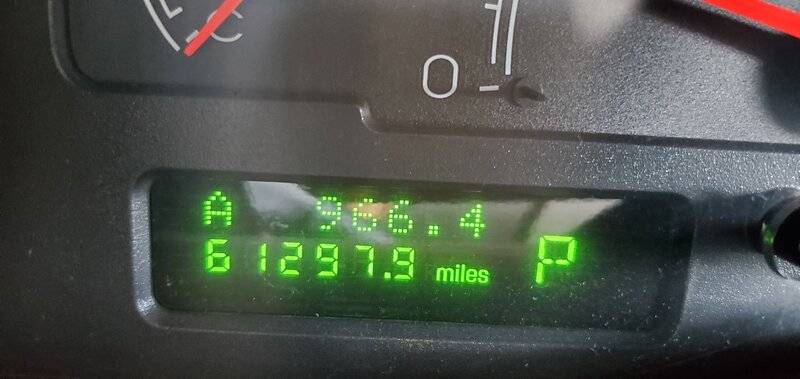

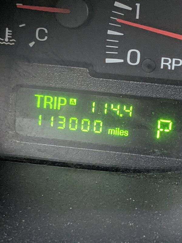

113k! Time for an oil change. Also, probably gonna put another 2k miles on it driving it from Florida back to MA by the end of the month.

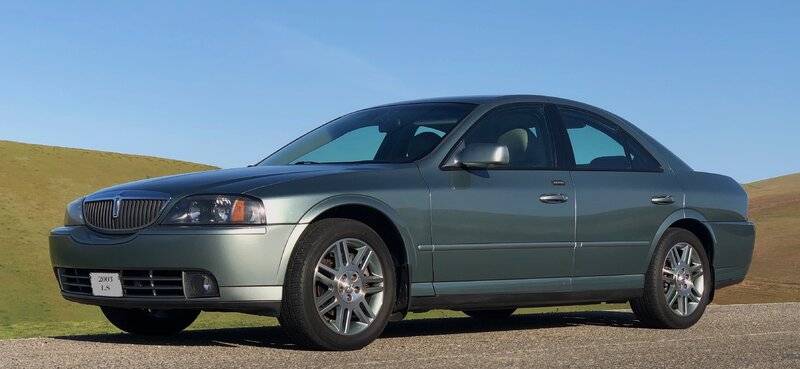

My car is for sale ... see my For sale ad, here.
Original owner = me.
Also posted on the "SF Bay Area" CraigsList ... Search Lincoln LS.
Can you afford that drive? :(
I've been planning and saving for a bit now. Recent gas prices means that I've got to take it easy and cut out some of the fun detours I had planned on the way there. Oh well, that's life.
Wow. Its pretty much a perfect example! None of that 20+ years of wear and tear
What is this Lincoln LS V8 ... the TRUE Hot Rod Lincoln ... and WHY is this car so nice?
2003 Lincoln LS V8 Sport
Original meticulous owner. :)
The facts:
Light Tundra Clearcoat Metallic exterior.
Espresso and Medium Light Stone leather interior.
Variable valve timing, 280hp 289 Ft-Lb Torque 3.9-Liter V8
SelectShift 5-speed transmission (auto w/manual mode).
OEM 17″ alloy wheels feature body-color accents.
235/50 Michelin Pilot Sport A/S 3+ tires.
Independent suspension.
Four-wheel disc brakes with Stoptech slotted rotors.
Stoptech braided stainless-steel lines.
Showroom condition ... never neglected or abused.
Superior driving dynamics ... as the suspension has been maintained (see below).

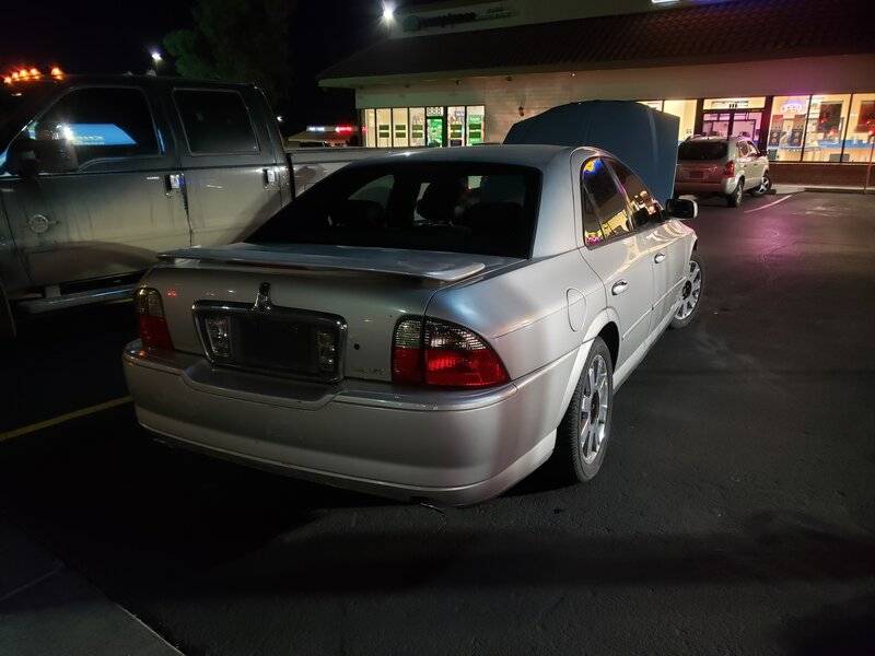

Today I drove it! :) Hadn't in a month or two. Cause the driver's window fell into the door. Again. I think it's happened almost 1/2 dozen times since I bought it new. Like to send Will Smith to the home of whoever designed this mechanism.
OK anyway it gets worse. No the LS didn't fail me. I failed me. Cause I found yesterday my registration renewal form for it. It had arrived around Christmas. Fees were due in Feb. :( But worse again I have to jump through the hoops created by the AHs who run this state. I gotta get it smogged. Now when I put it away and when I drove to the smog station today it had (has) a check engine light. Well I know what it is - a tiny Evap leak which I've been unable to fix. Good news is that is the ONE failure the car can have and still pass smog.
So off I went. Got there and said - well it's got a check engine light but it's only the evap system, tiny leak. Like two years ago when I came here you guys passed it. But guy says - well if it's got a CE light on, it fails. BUT - its only for evap which is ignored. Nope. I can reset the light I say. If you do that you gotta drive it for 100+ miles to see if the CE light comes back on. Great. At $6 gallon for reg, I gotta blow off about 5 gals to do this. = $30+. :( Then pay $60+ for smog. Ah California. I think I might jack the rear up and run it in 4th for 80 miles. Probably use less gas and waste less time that way.
OK sorry for the long - wait - I also wanted to say how much fun I had drivin it, running it through the gears, both front windows down, wind in my - on my head. Loved it.
