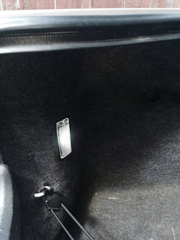

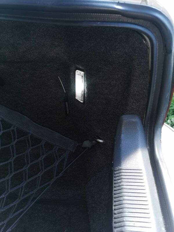

I did that last year, second light, then also added two more lights into the trunk lid then converted them all to LED. My old eyes can finally see in the trunk.
Hey man that looks good, what size bulbs? I'm probably gonna convert to all LEDs soon

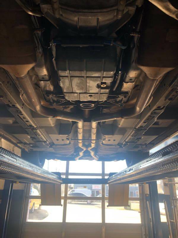

Went a little crazy today! The last time I am driving it till the hubs are replaced but I had my exhaust system replaced. Went with resonator delete, ran new pipes 2.5 inches, x pipe, and 2 Magnaflow mufflers. Now she is sounding good! I Will post videos later when my wife gets home so she can give me a hand recording it.
If anyone is needing any of the old OEM exhaust let me know as I kept the old stuff in case anyone was in need of it and the old stuff is rust-free and very clean cause the car only had 46,700 miles when this was just taken off it.

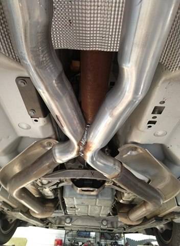

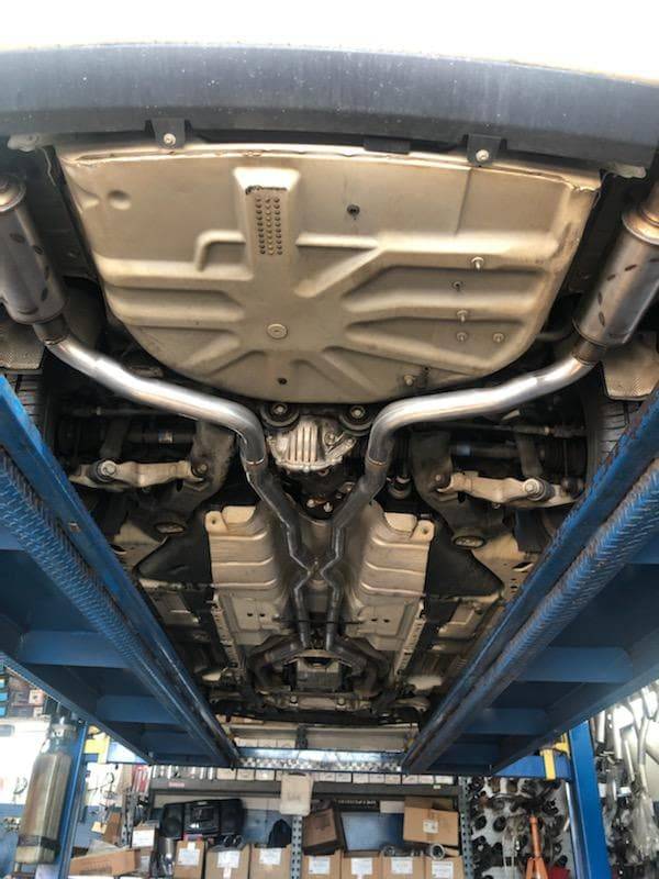

Making another post cause the place that did the exhaust did a very bad job on their install so I went back today and they took it off and I got refunded. So then went to another shop that actually knows what they are doing and got it re-done. I went a different route on the muffler selection this time as I choose to go with Black Widow Mufflers. I wanted to do something a little different than what everyone else was doing after I heard it in person. So same setup just done much more professionally than the last time with a different muffler.
Beautiful workmanship that's.

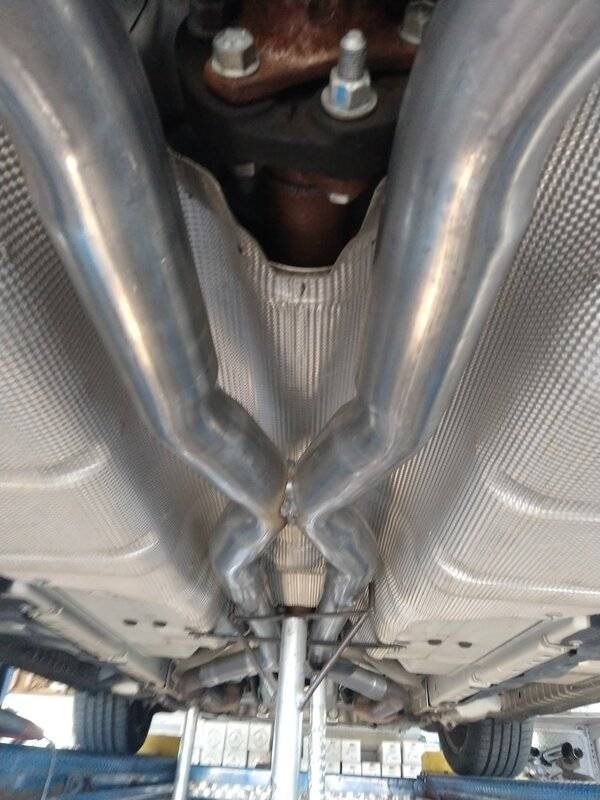

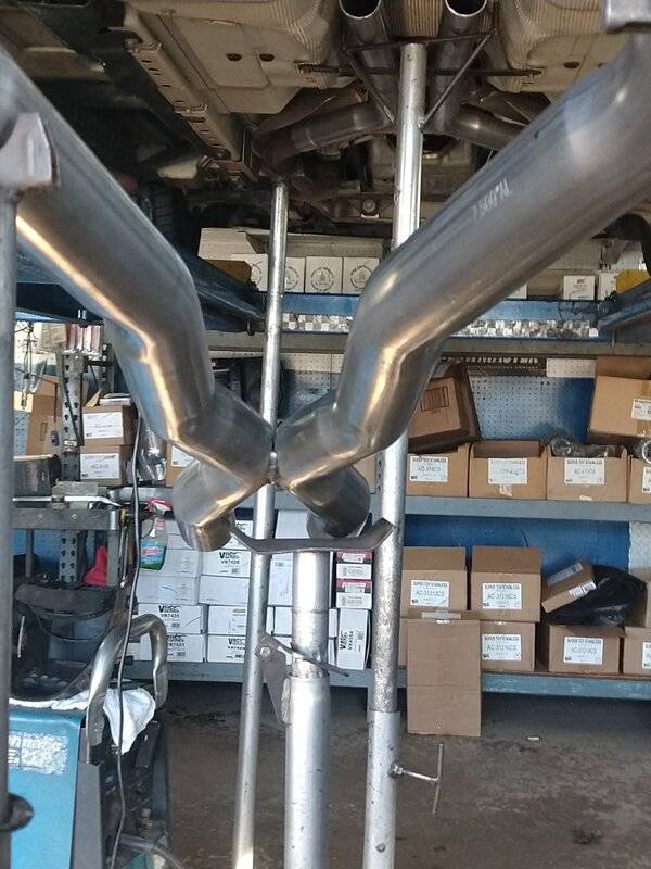

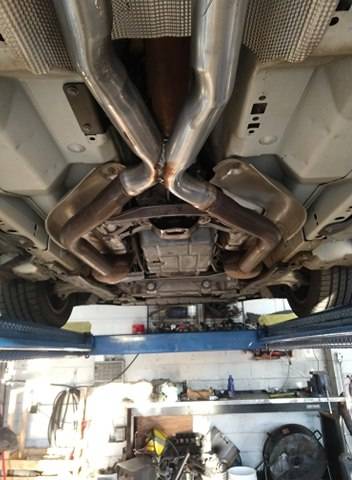

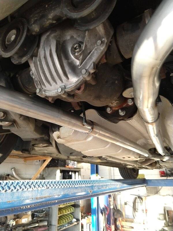

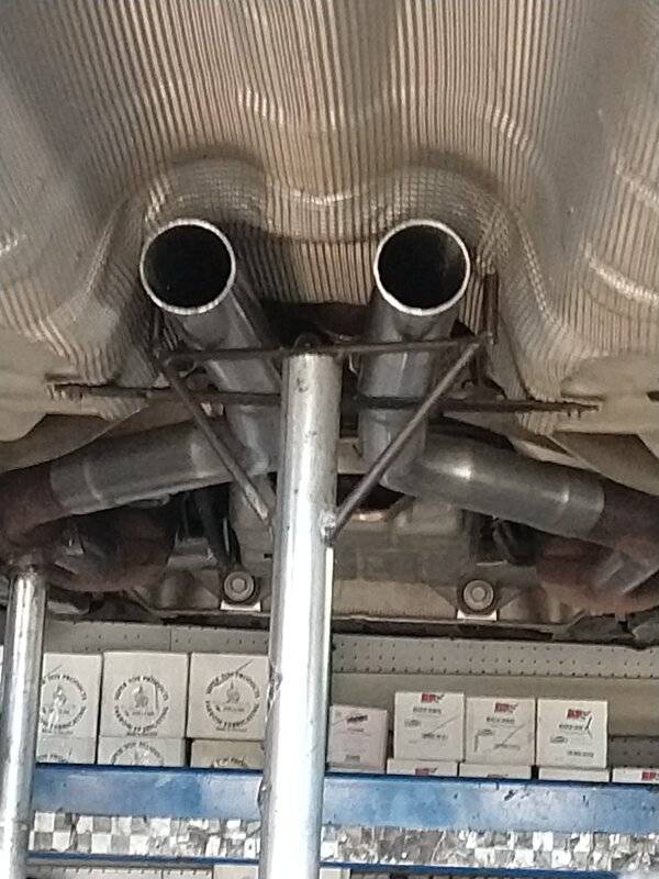

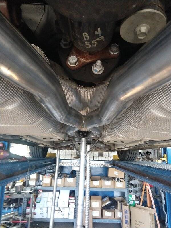

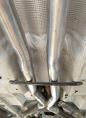

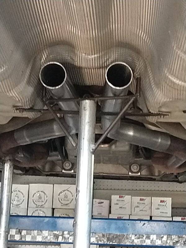

Thanks! And to show all why I got my money back from the first place here are a few pictures of how bad their work was!
First it would be wise of them to start at the same point on each side. And where do I begin on how many unnecessary bends they made in this setup. I honestly feel like air was being more restricted than anything by the looks of it.
Gotta love their attempt at an X pipe. And where do I begin on how bad that center weld is. Amateur night would have likely turned out better for most on that one.
Yep was sitting on the cross member

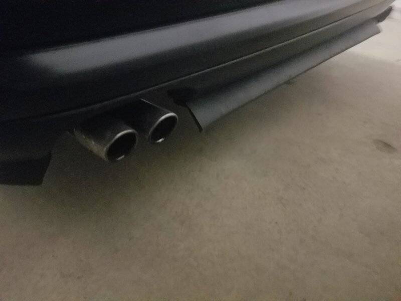

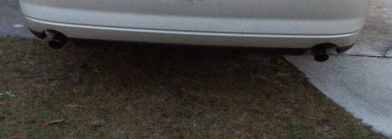

What were they smoking here? The tips and placement there make me cry inside just knowing how bad it once was! Glad it was only for a day! In the end it looked like a restricted nightmare to me among all the other crap mentioned just now. But it was very fun driving to the other shop with no mufflers and all that pipe cut out for about an 8 mile drive! Yep I had lots of fun knowing I could get away with it for that brief time.

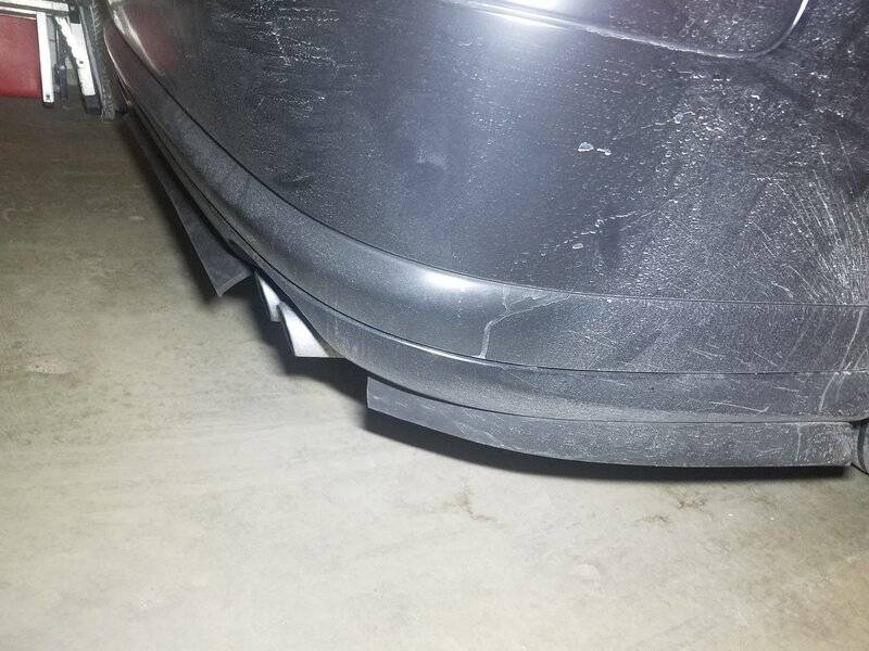

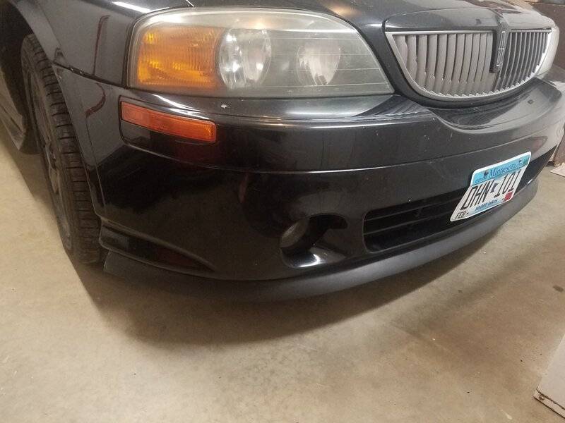

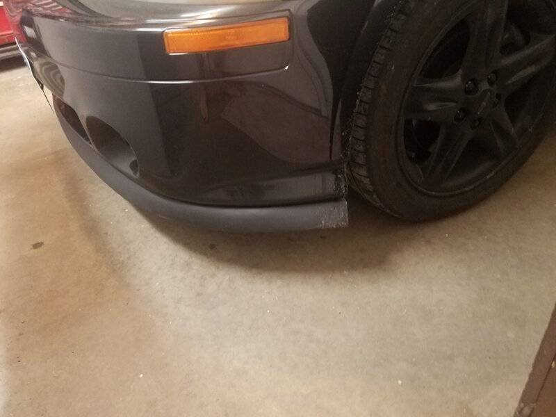

I've never been sold on cheap little add-ons when it comes to cars/trucks so before I purchased this product I was a bit skeptical to say the least ..I will post better pictures when I get more time and show what the stance looks like from a better angle/picture...I wanted some Eibachs but after hearing that the springs can do more harm than good on my LSEs suspension I'm going a different route ...I think this product gives the car a way more aggressive look without breaking the bank

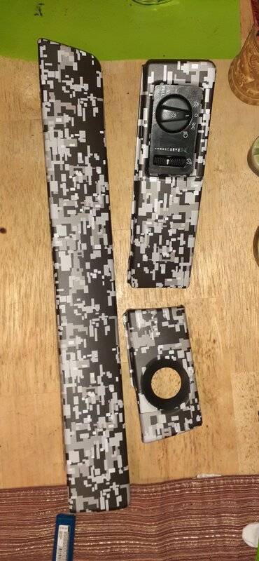

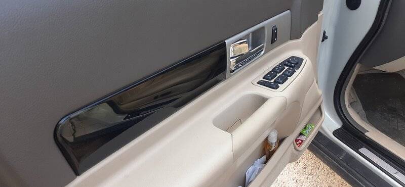

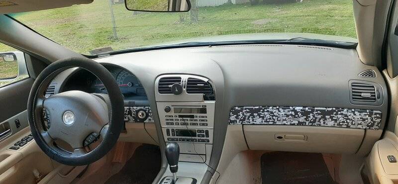

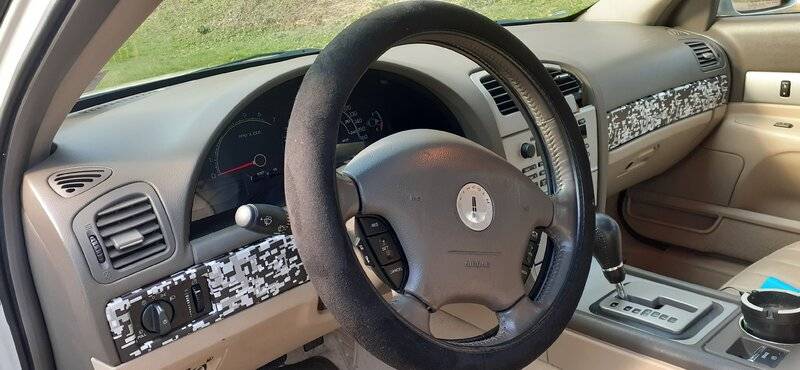

I started the wrap job on the 05 base model. Covering piano black with grey digital camo vinyl. Since the car is white, im trying to pull the various interior and exterior colors together with the wrap. I mean lets face it, the base model interior is a disaster with some grey, black, silver on the top half, and that aweful tan camel color that goes in all luxury cars for some reason on the seats lower portion.
The three sections on the dash just pop off as expected, but Ive read that the door trim is spot welded to the panels, so ill have to precut vinyl and lay those in-car :(

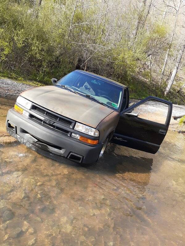

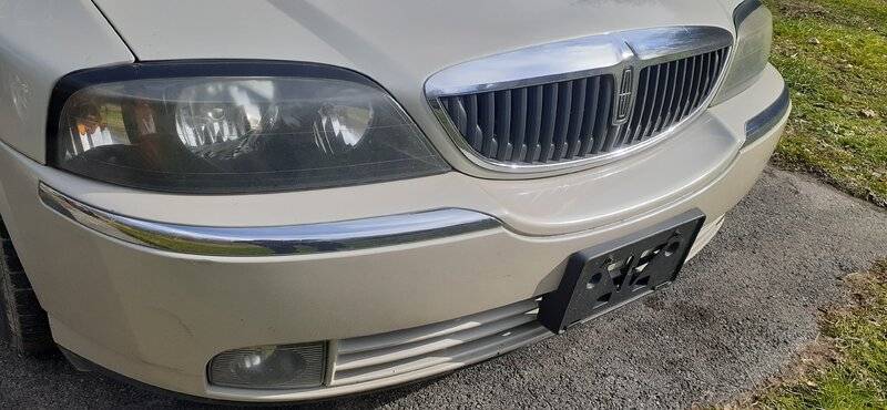

I've never been sold on cheap little add-ons when it comes to cars/trucks so before...

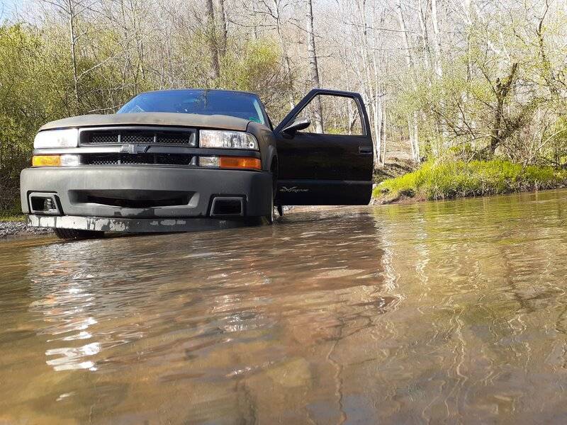

I have the same stuff on my xtreme s10 and its worked out really well. I like that its flexible because it doesnt scrape hard like the orginal one did when making transitions. Or when small animals jump out in front of you and fold the factory air dam under and break your fog lamp bulbs.
I think the brand was EZ Lip .. basically garage door gasket but more durable material. But for 20 bucks or so, i have no complaints whatever
I swapped to an SS front bumper cover but it was an inch or two higher than the factory xtreme skirts. I threw this lip on there to drop the front clearance about an inch lower than the skirts. Looks good now .. as far as that goes. Still needs a lot of tlc elsewhere. Havent finished fixing it all back up after deer damage cause its not really worth much and ive not had the extra money to sink into that project :(
Yeah I went down to my local Hardware store and bought some black bolts and black matching nuts ...I'm in MN with nasty winters so I didn't trust the 3M tape adhesive that these are supposed to keep them on ...the bolts aren't visible whatever the road and weather throws at them will lose lol
