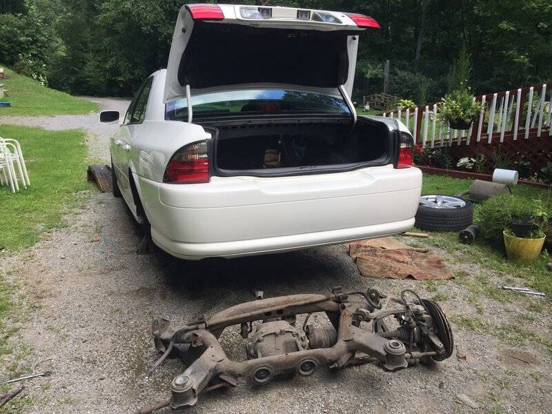

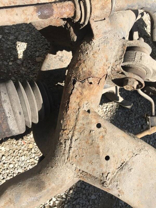

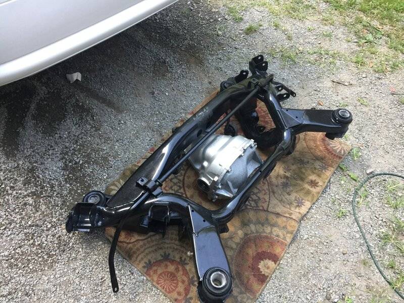

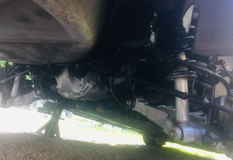

Swapped in a mint rear subframe along with a 80K mile 3:58 gear carrier after new seals and fluids. My old frame had two rot areas.
