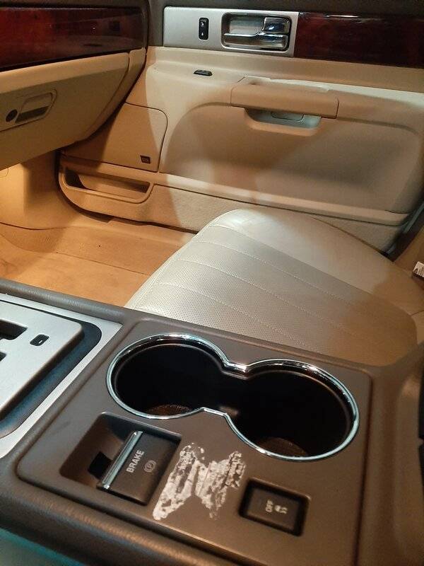

Mine came with a bunch of black screws and square plastic black washer type things. I also didnt trust the vhb adhesive alone. Neither did the manufacturer, apparently. The lips been on there a couple years and some change now and holding stong.

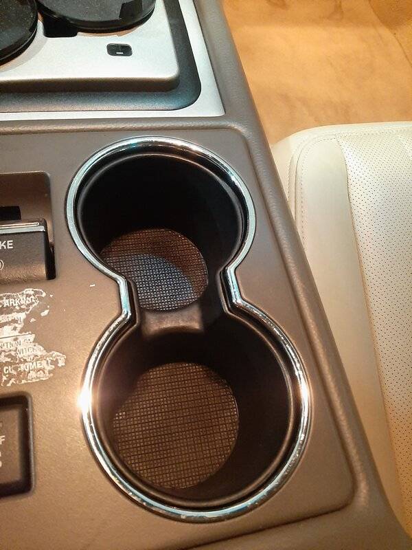

Got lucky and scored the nicer cup holder insert off ebay, idk why they didn't put this nicer insert in all the gen 2's it's much classier!

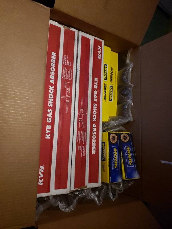

Got a delivery today, new links front and rear and only got two struts for now, gonna test them on the rear first cause my fronts seem in better shape, which doesn't really make sense to me. Tire shop recommended kybs except they wanted to charge me $255 bucks a piece for them, I got them off of RockAuto for 56 bucks each. ;)

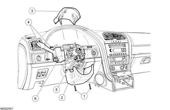

Ah, right on. Mine stops blinking if my steering wheel is in a certain position, not sure if it's giving a code, I'll have to check that, thanks.
Certain position as in up/down tilt and/or in/out telescope? If so, this would likely be an issue with the wiring to the connector to the multi-function switch or even might be that the connector isn't fully seated. Remove the two screws that face down from the bottom half of the column trim cover, then snap the two cover halves apart. Then you should be able to get to the connector and wiring.
Like when turning, if I turn the wheels to a specific spot it stops blinking, if I turn a little more it starts again.
Weird. I'd look for some of the wiring being misrouted and rubbing against the steering column shaft.
Edit: I guess that alternately it could be a badly worn multi-function switch that is failing. Of course, the 2003 switch is different than all the other years (AFAIK), and very hard to obtain anymore.
