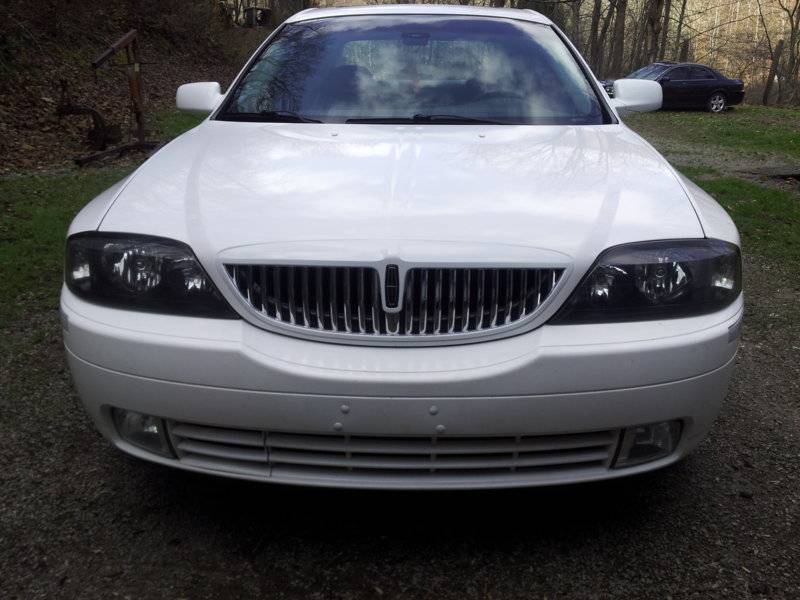

Yes, prep is key of course. That and applying thin coats. It dries really fast as well.
After the last clear coat I take a hair dryer to the part then let it sit a few hours, but overnight is best if it has to be handled a lot to install.
1999-2000 Lincoln LS M6640A Performance White Spray Paint Base/Clear Coat Kit | eBay
Thanks!! My 04 LS has the Ceramic White tri-coat. It looks awesome but not easy for a novice like me to do. I really want to color match but also want it to look good. How many cans to do the grille?
I did one mirror and the grille with one can base & clear

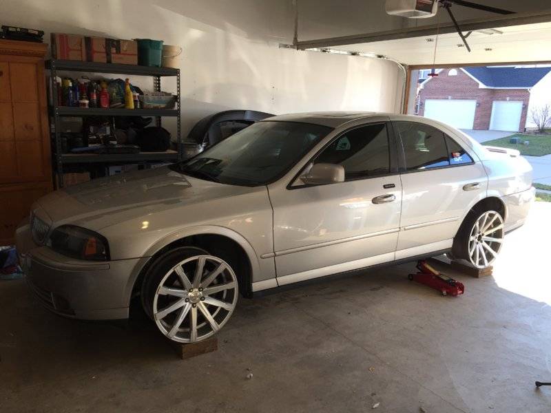

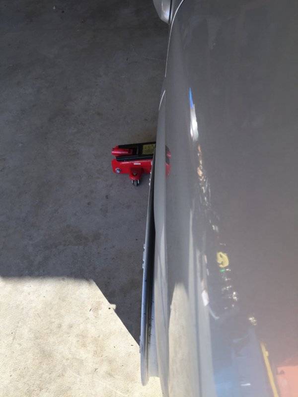

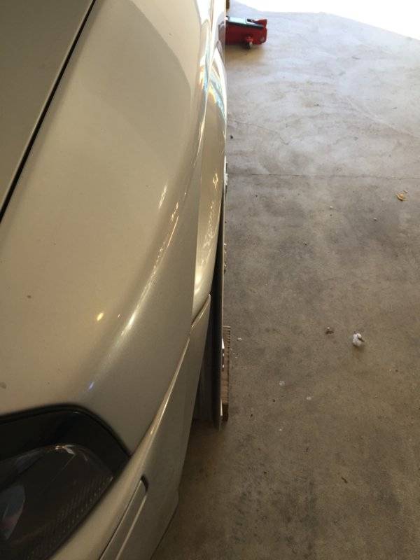

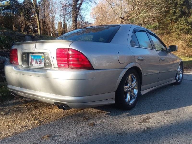

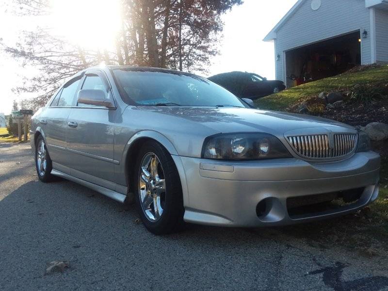

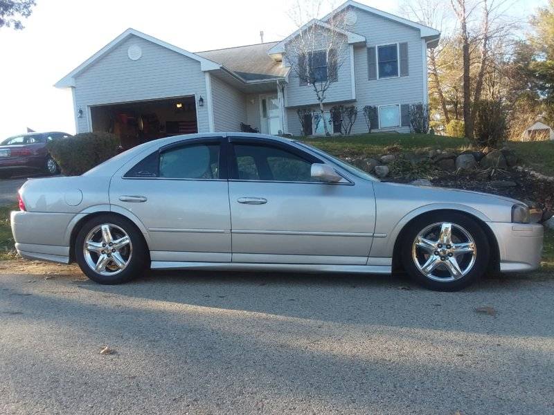

Installed Stance Coilovers and fixed my front bumper of some cracks.
Man that's beautiful. Is it lowered much? No issues with the Stance? I'm not sure anymore that I was shipped the correct Stance units. I've had to send the lower mounts back to be redrilled. Now I've had to send the upper shock units back to get a longer ones. These were too short to set the entire unit to the length of the OEM shock. The fronts have the wrong springs according to the spec. They should be 200mm long but mine are 250mm.
All that said though QC could use some work, support has been great.
Wow. I got these from a member on here. No issues at all. And thank you. I'm in love all over again.

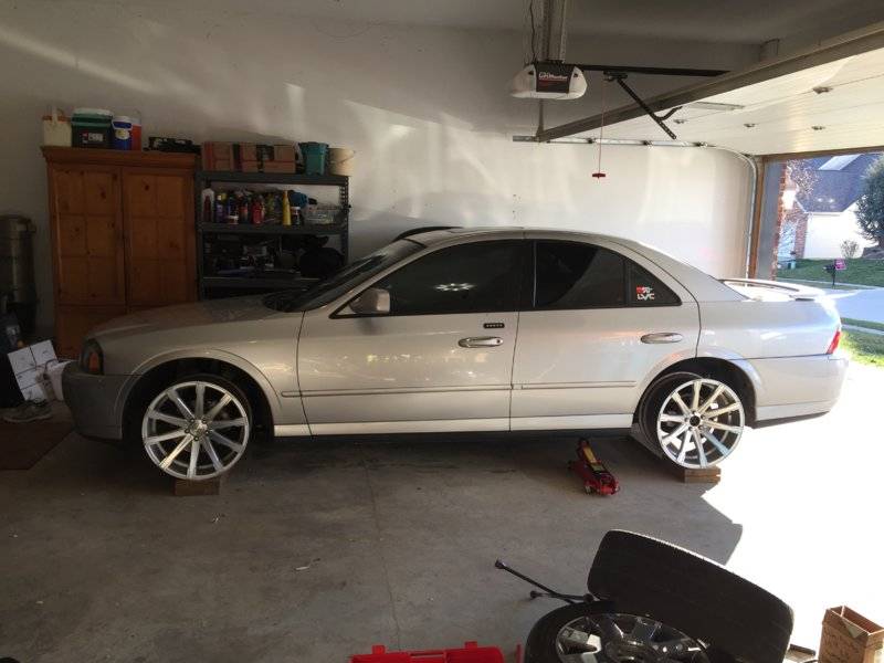

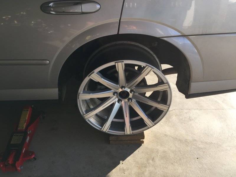

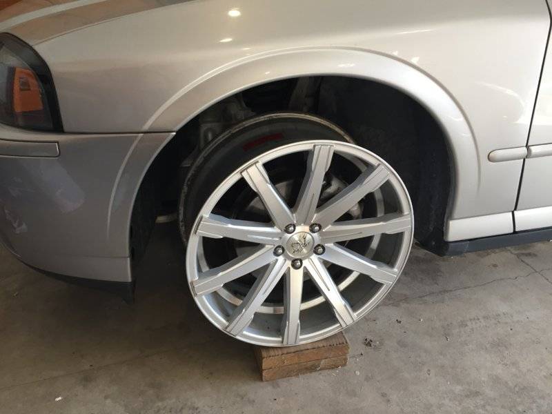

Little tease. Mocked up my staggered 20s. Can’t wait to get tires for them.

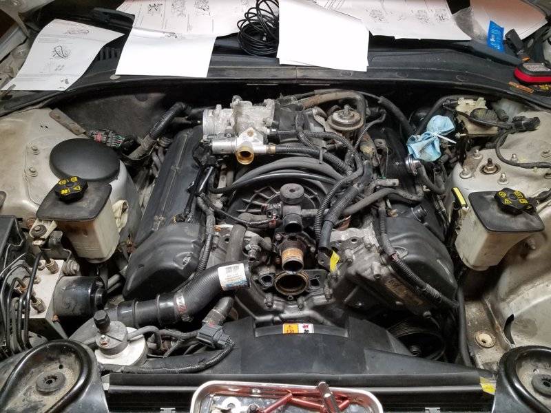

Just finished putting the valve covers back on. Replaced all of the chain tensioners and chains with the new ones. Few more things to put back together then start her up for the first time in about 3 years. I only took ownership a few months ago.
What year? If it’s a Gen 1 I encourage you to go with aluminum T-Stat Housing Ero part Jaguar S-Type
It is a 1st gen. I wasn't planning on it initially because the car hasn't run in so long and I wasn't the owner last time it ran so there is a bit of uncertainty there. I don't want to put a bunch of money into it before I've even started it....but I think you've talked me into it. It's a direct swap with the LS thermostat, correct?
Yes, absolutely... direct fit all the way ....I seen your picture and I thought I’d mention it, due to the fact you have the luxury of everything opened up which will make the replacement that much easier
