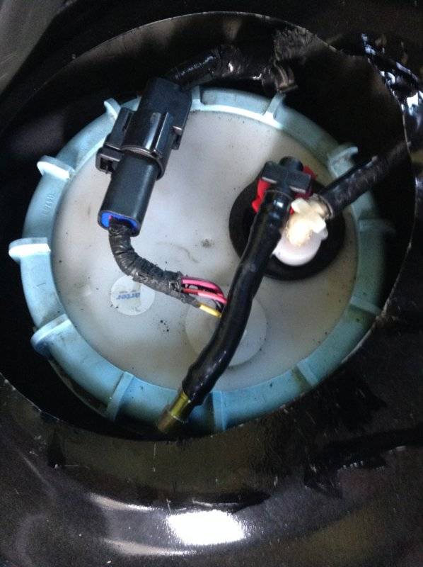

Replaced the makeshift connector I had inserted into the fuel pump assembly module with an OEM connector Heyjewel sent me in the mail...this couldn't have come at a better time ...car stalled on the way to work last friday and had to tow her home ...connected the OEM fitting on the fuel assembly and she popped right off been running strong ever since...Thanks to Heyjewel my car is back on the road....this forum has some really good people and I'm very grateful to All the people who have taught me so much about this beautiful Lincoln which is sometime my worst enemy but over all just a really fun car to own and drive...thanks again Heyjewel for the permanent fix...happy motoring
Glad to help and I was only able to do so because I had broken one of my black connectors and I replaced the entire 4 tube harness. So I had one black one left.

I have a full size in the trunk as well... The fuel pump stopped working today...left me stranded in a snow storm on the highway...thank God I was by a house and pulled into there driveway ...must have finally gave out due to running the makeshift connector for the last month...to much stress on the pump I suppose due to the dimension of the hole the fuel was going through....after looking at how small the hole was I'm surprised it lasted this long...new assembly on the way ....going to install the Spectra again ...shouldn't have bought that Carter brand but I got it on open box Amazon for $36.00 originally $116 ...the spectra I had in her before was a hundred times better ...hopefully this is the cure all...anyway sorry for the rabbit trail ...but back on the subject of the LS's trunk it has plenty of room for a '17 inch wheel
Thanks for the confirmation on the spare tire (not that I doubted you, joegr :)
Too bad about more troubles with the fuel pump. So u think the cause is not the black connector I sent you, but the previous rube goldberg one you had in there?

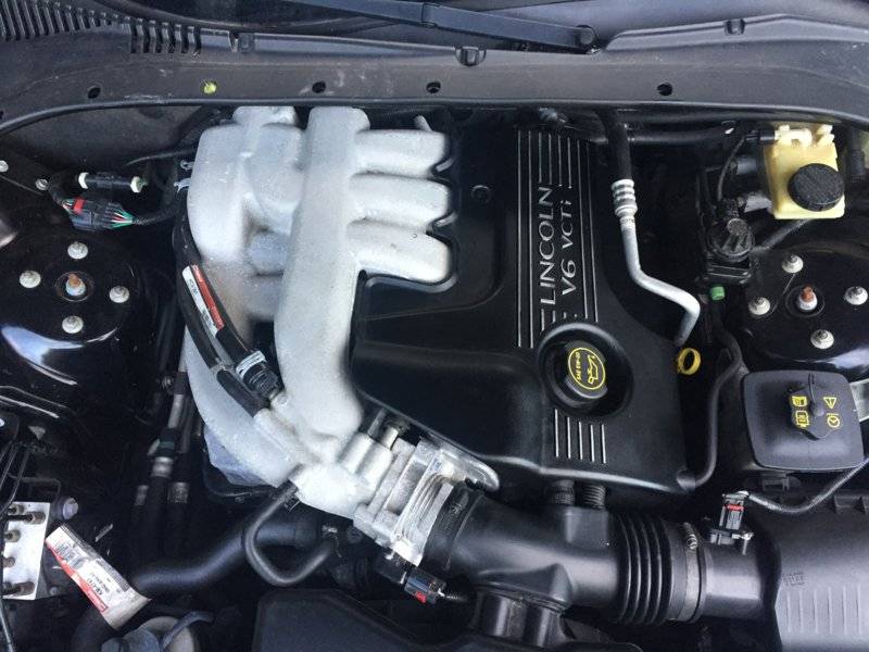

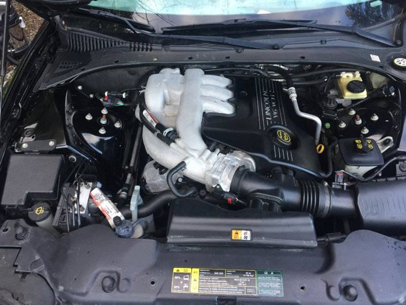

Finally starting to get some "nice" weather out here in Vancouver so I thought I would get a head start on the spring cleaning and get cracking on my engine bay. I used a all purpose cleaner and a dedicated brush to break up all the grime on a square foot area at a time, I then rinsed off the aggegated soap and grime and wiped up any excess water with a micro fiber towl. I then used some Meguiars Ultimate Polish with a applicator/light cutting pad. It brought some life back into my engine bay. Im still looking for ways to get rid of all the white dust on my intake manifold from having moisture under the hood over the winter.
I got a little bored tonight and started my paint correction a little early. What you see in the picture was just some Meguiars compound by hand, I will finish off the entire car by machine then polish and sealant.
Can’t install it yet, but received it in the mail the other day. Can’t wait till it’s back on the road to install it!
That's one beautiful engine!
And car starting to brighten up too. Meguiars is good!

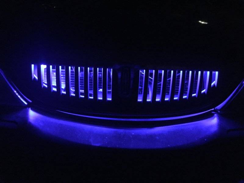

And I like the LED grille. Did you customize that yourself or is there some off-the-shelf product.
Thanks
