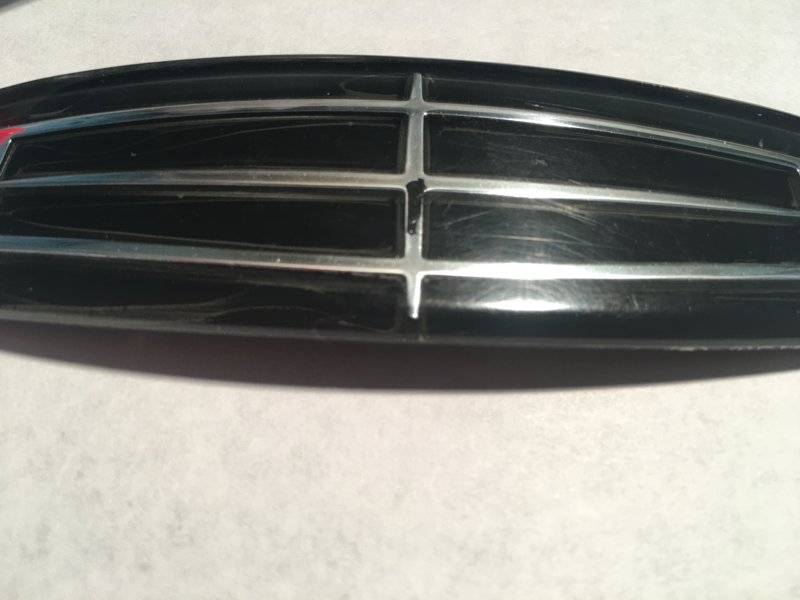

Thanks. I took off the rear emblem and managed to scratch some of the silver/chrome at part of the logo.
Any tips on fixing that? Hobby store chrome paint with a tiny brush?

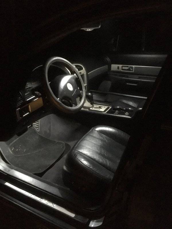

Redid my whole cooling system. New thermostat/housing, new water pump, new degas bottle also. The rest of the plumbing was good. Also did a tune up, new plugs and coils. Updated the interior lighting to a more modern vibe. To say I bought this 03 v8 from an old lady for a thousand bucks I've really given it a new life.

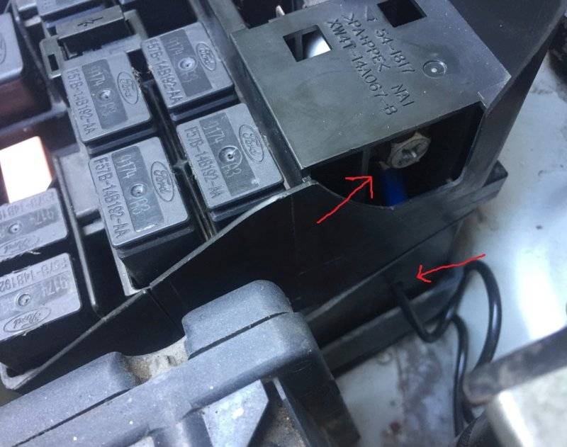

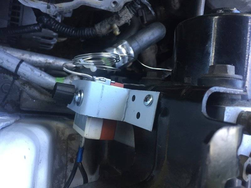

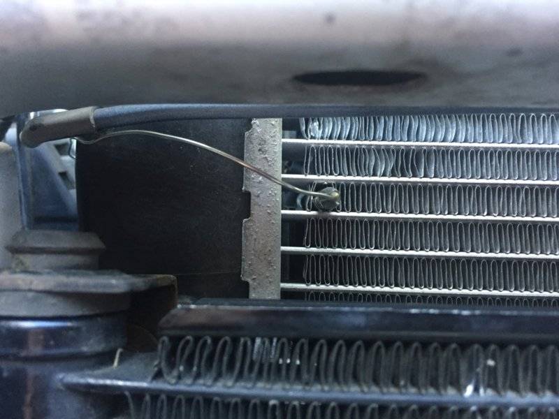

Got the adjustable flex-a-lite fan controller mounted and wiring done. It's controlling a V6 LS factory fan. Constant power for the fan I tapped in at the starter with an inline fuse. Power for the controller was tapped from the main feed line to the fuse box under the hood. Mounted the controller on the side of the ABS bracket. The temp probe is just over from the inlet tube area of the radiator. Haven't got to test yet as I'm still awaiting the upper coolant tube and a inch pound torque wrench for the cam bearing cap bolts. She is basically put together though.

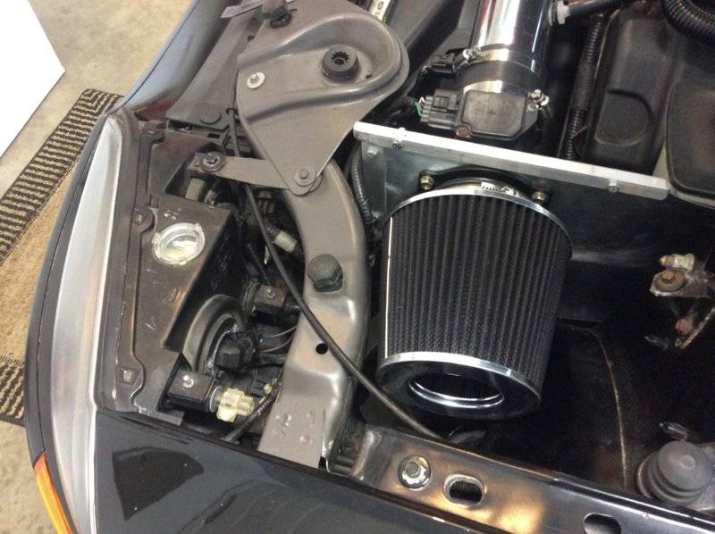

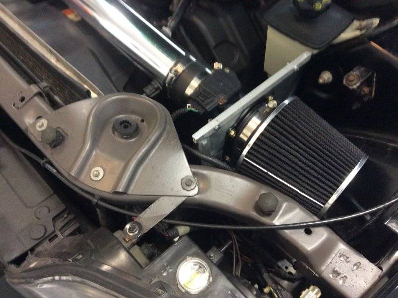

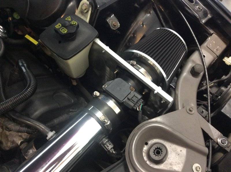

This weekends project was my own design and customization of a heat shield for my Cold air Intake System. I also plan on customizing a plastic pipe tube that will bring air from behind the front grill up into the air filter...I will show pictures of finished mod best part is this will eliminate the use of power from battery if I would’ve went with a cheesy fan turbo they’re trying to sell...instead this will be totally green and all I need is the wind from driving...

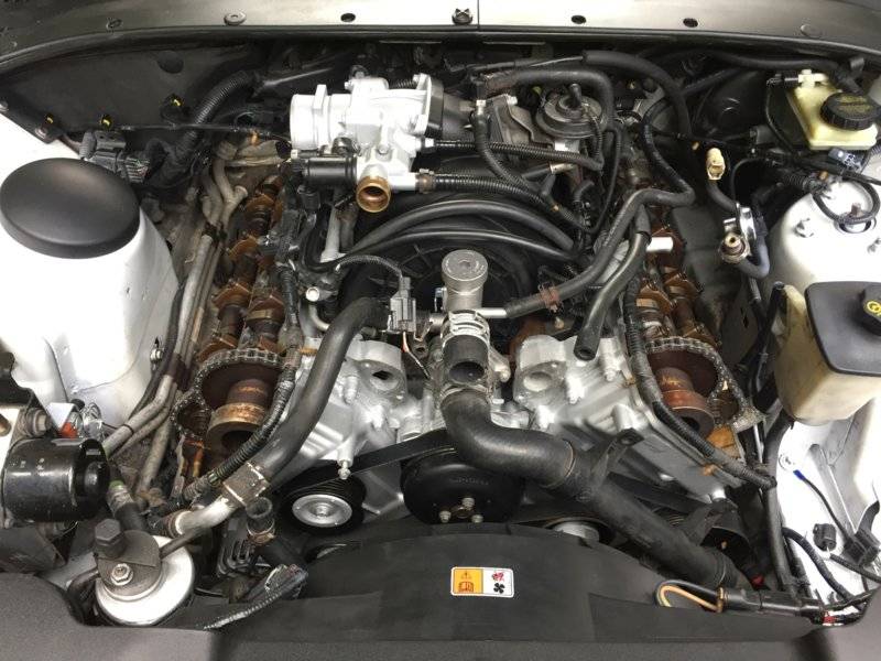

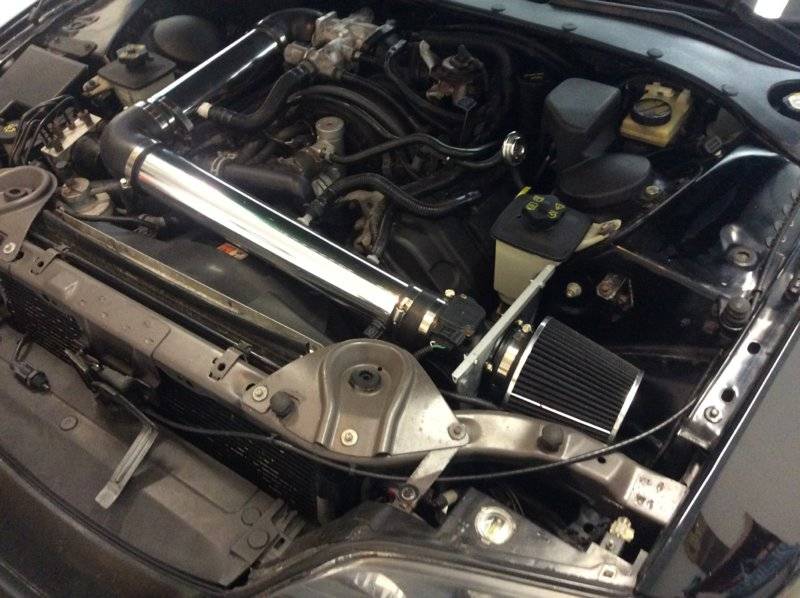

Engine finally assembled from a total timing chain upgrade and fan pump delete. Runs like a champ. Going for a more robust PWM fan controller than the one pictured earlier & she is ready for the road again.
Looks great! Yet it’s strange not seeing the Engine cooling fan fluid reservoir...the engine compartment looks like night and day from earlier pictures. Very clean indeed

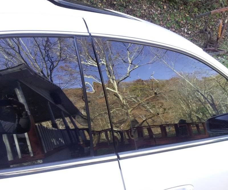

Added some clear park lamps and some glossy black door pillar post covers. This made a huge difference. These were not only faded badly but one side had small dents as if someone had punched it. Ultra glossy and reflective.

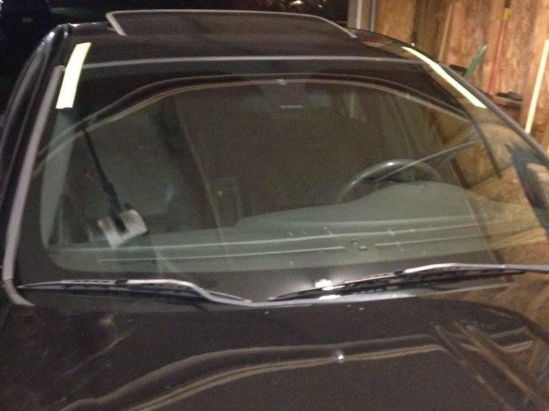

I had a new windshield installed today to replace the 15 year old glass.... Talk about night and day difference!!

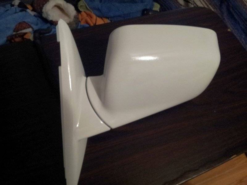

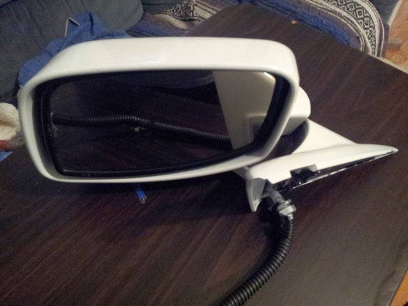

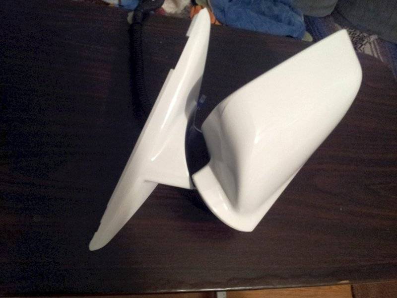

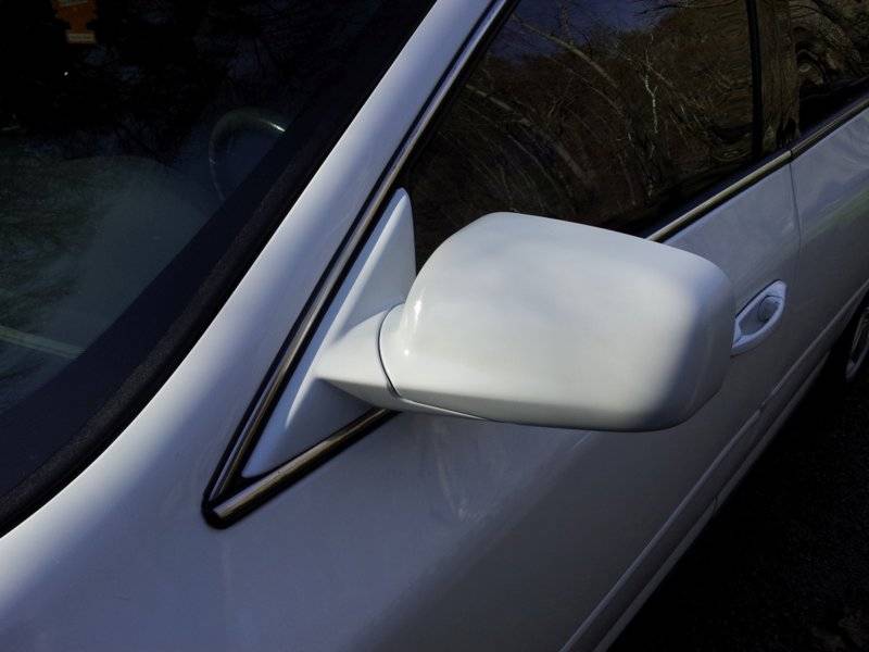

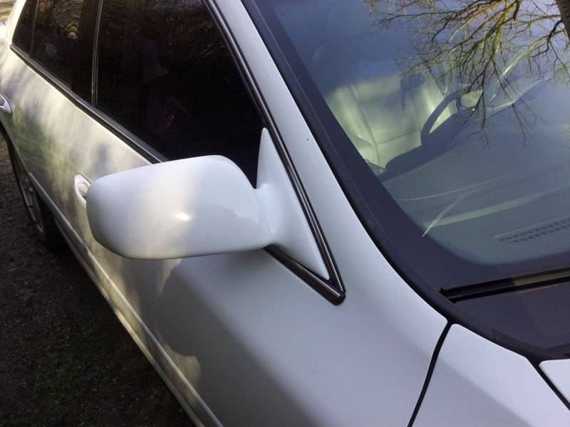

Found some folding mirrors on the cheap. Have one painted and cleared using 12oz rattle can base/clear that matches cars paint code. I used 4 coats base & 6 coats clear. 2006 grille on the way to get the same treatment.
I was interested in doing that mirror mod to my 04. Is it a plug and play? What year is your car?
Mine is a GEN 1 2000. They plug in but if I want the puddle lamps I'll need to jump a wire from the door lamps. All Gen 2 cars should be direct plug and play.
