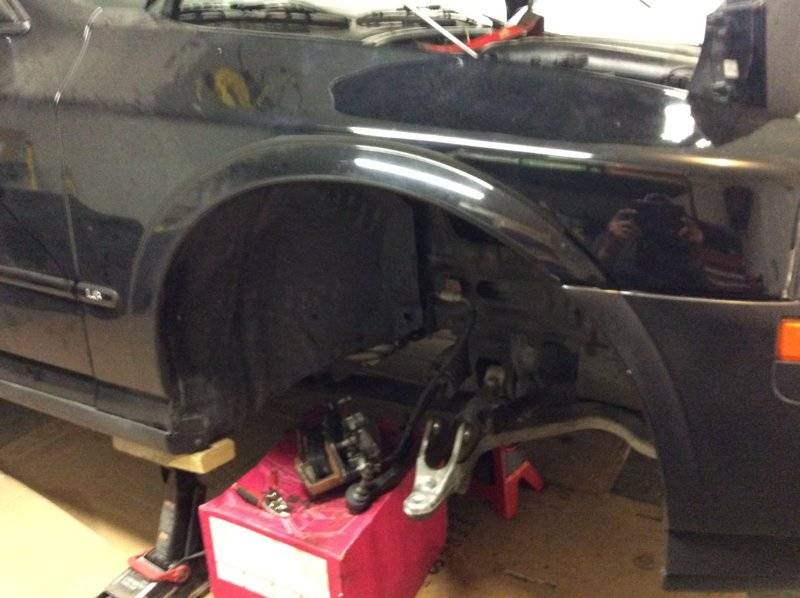

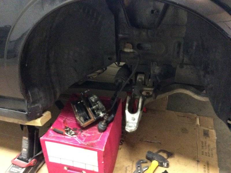

    Replacing upper control arms, front sway bars, replacing old ball joints with Moog problem solvers, and shock mount kit due to the fact I snapped a bolt taking shock out to get at the upper control arm bolts with more ease....Rigs told me this might happen and he was right ...

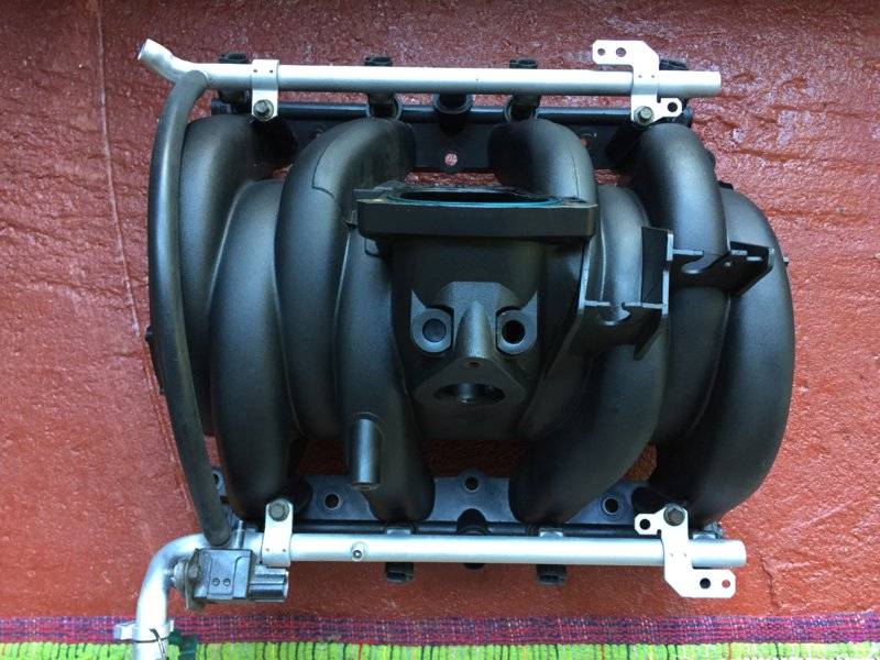

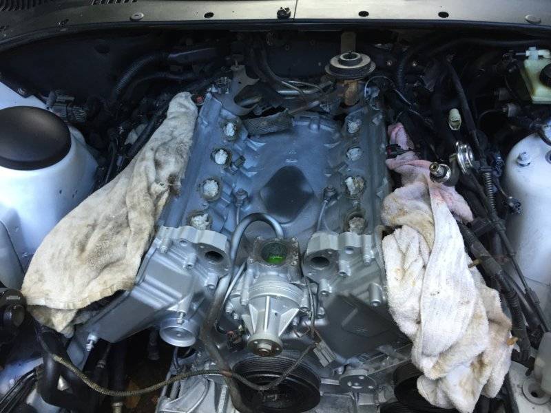

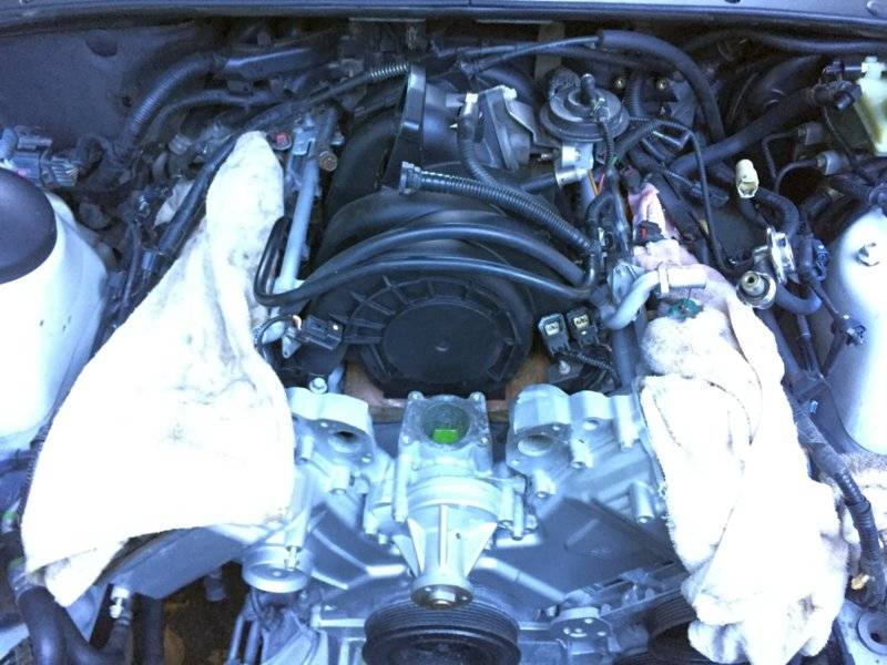

    While waiting on parts to swap the timing chain out, pulled the intake and thermostat housing. Replacing housing with the aluminum Jaguar version and spray dyed the intake, painted the fuel rail. and installed new Felpro intake seals. Also swapped out a cracked injector found during disassembly. It was the only one and most likely happened with some water in the gas during a very cold winter. Two years ago we got a -14 for 2 nights. Also painted the engine block and cover. Spray dye is only way to go restore the plastics.

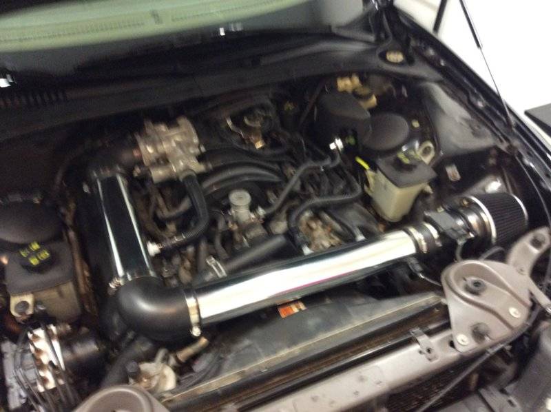

      IMG_2080.JPG IMG_2079.JPG IMG_2078.JPG IMG_2076.JPG Replaced Factory intake with a Short Ram Cold Intake system eBay special but at least my car can breathe. I'm still deciding if I want to customize the factory engine cover. Never really cared for engine covers though

        The paint looks great! I just did the S-Type T-Stat housing also it's so nice having less plastic on the cooling system ....you do very nice work my friend...

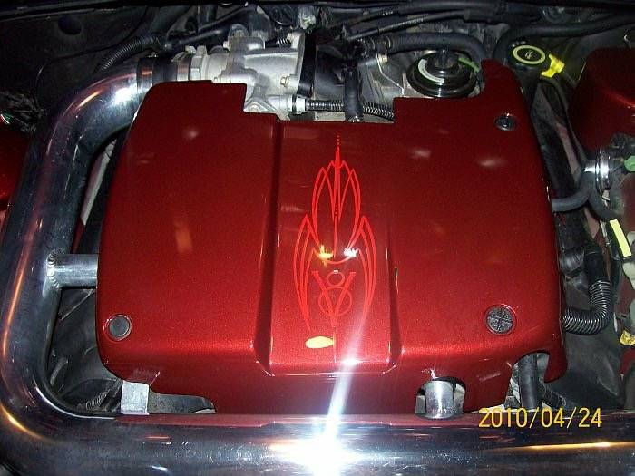

                Can you expound a bit more about the engine cover?What's the deal with this cover is this a modified factory or aftermarket? Very nice indeed!

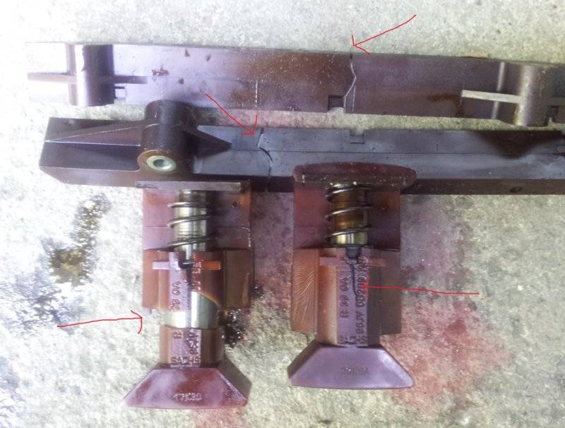

                  New chain kit on today. Check out the busted up tensioners and guides.

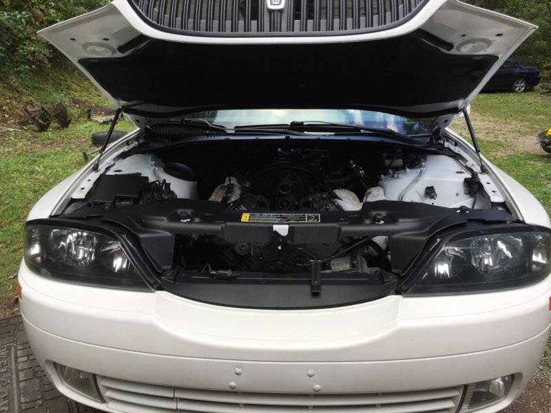

                  Camarillo, CA

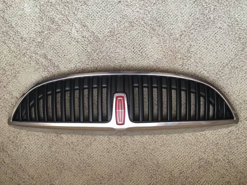

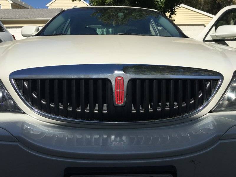

                  What type of paint did you use for the grille? What black dye did you use? I have a 2004 LS V8 in pearl white and want to paint the chrome grille to match the paint. I'd love to have a McLaren grill but what you did with the black really looks great!!!
                • Carl Smith
                  Carl Smith Active LVC Member
                  Messages:
                  104
                  Likes Received:
                  30
                  Joined:
                  Jul 17, 2017
                  Location:
                  USA
                  Can get it at Autozone. Flat black cap

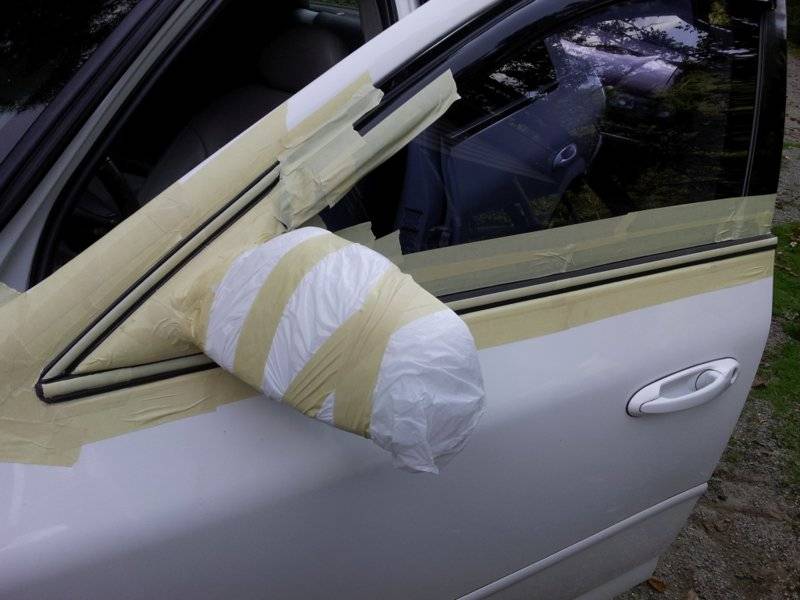

                  For the wipers...did you do them too? I would think one would want to remove the arms rather than try and paint them on the car, no?

                  Looks good. You plasti-dip the chrome trim around the windows. It would look great on your white LS.

                  I thought about dyeing those as well but like the subtly chrome. I may change my mind later esp if I pull the rain guards off.

                  Yes, I did the arms too. Just take them off..clean, and take some 400 grit wet sand, clean again, dry, hang, and spray.

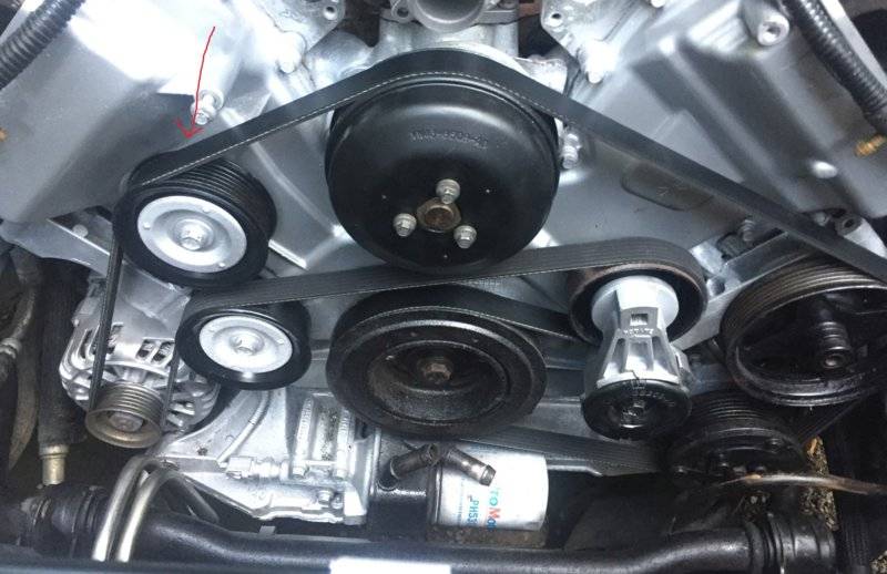

                  I eliminated the fan pump so needed a shortened belt. A 100 inch belt works fine. I used a Dayco 5061000 Replace the top smooth idler with a ribbed LS V6 idler, but retain the longer bolt from the 3.9 idler, and belt routing goes smoothly.

                    Really happy with how this came out...new badge color and painted grill. Thanks for the help!!!!
