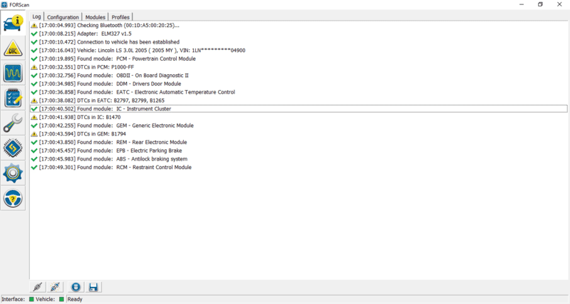

    Had a fellow LVC member come by with his forscan and ran my car for codes, had a few pop up.
  13. MysticMac
    MysticMac Well-Known LVC Member
    Messages:
    369
    Likes Received:
    48
    Joined:
    Aug 18, 2015
    Location:
    Vancouver British Columbia
    I haven't had ac since I purchased the car, so seeing the B2797, B2799, B1265 proves my DCCV is done. The other code that came up was - B1470 Lamp Headlamp Input Circuit Failure.
