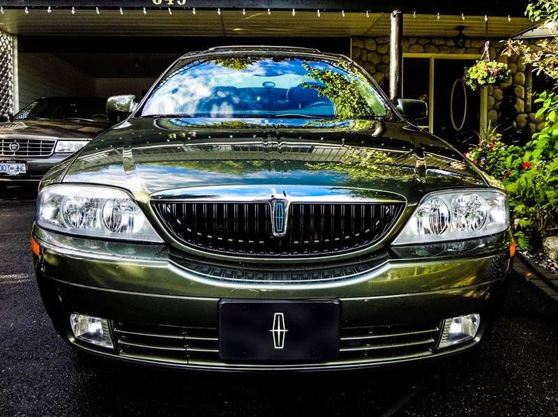

Doobie time LOL
That turned out really well for rattle can. I understood you hit it with some clear afterwards? Orange peel much? If so, wet sand clear coat once hardened for a for weeks and polish it back to shine with compound and buffer.
+1
Ps: Should have done the chrome grille and rear plate surround at the same time. It's need etch primer though.
Doobie time LOL
+1
actually no orange peel what so ever.. however... the doobie time before the spray actually made me miss some bondo that needed to be sanded down hahaha where the "chrome" trim would of been on the passenger side lol.. oh well im going to keep it on there for a month or so and then sand it down again and take it to my good buddies body shop and give him a case of beer and supply the paint.. I couldnt justify spending almost 300 for a gallon of ford ebony black and then having to build a make shift spray booth in my back yard for just my bumper so i hit up canadian tire and bought some paint and clear. its good enough for now and it looks mint at night haha
i found a diamond in the rough..
yesterday as soon as I left work my front passenger lower balljoint broke in half $80 for towing I went to autozone and got a balljoint for like $30 then all the machine shops said the usual press wont fit the arm and since I cant be without my car I went to the junk yard and got an arm with the joint $30 BUT while I was at the yard I found a LS bumper the one with the round foglights I wanted it so bad but it had a crack in it so that was a no but it did have the chrome grille in perfect condition other then missing the emblem so I got it that thing was $25!! its like $200 on ebay

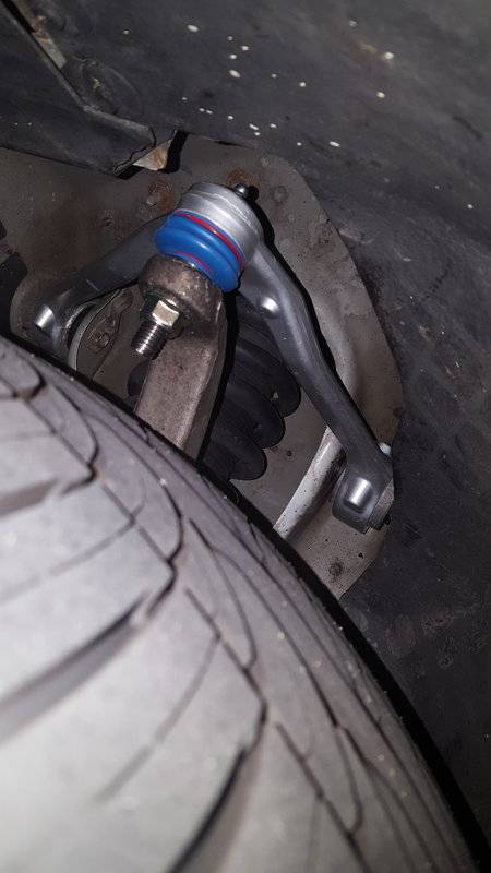

Front Upper control arms. No more creaking noises when turning and going over bumps. I was able to get the drivers side rear nut off by lifting the degas bottle and using a long, low profile ratchet.

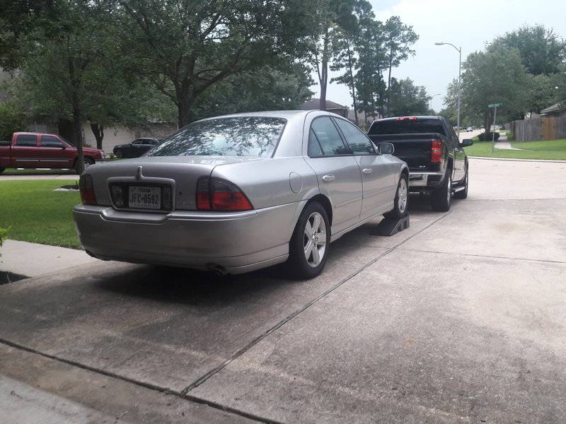

Not really what I did "to" but what I did "with" my LS. I drove it 60 miles from home and back and it is running really well. All of the wrenching is paying off , but I did pack lots of my tools, and some pre-mix coolant just in case.

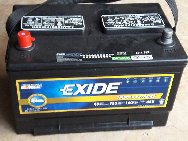

After a month long hiatus during the busy season at work and fixing the leak in my bank account caused by two kids in college, it's time to get back to giving the LS a little TLC! Over the course of the last two months I started to see why Rigs always keeps a spare battery on the charger! I picked up a new Exide battery at Home Depot for $109, which I thought was a great deal. Now up on the ramps to chase down a pesky oil leak.
You're kidding ... Home Depot in the USA sells car batteries? ... I must talk to our dope smoking Priminister. Can't get car batteries at HD here in CDN. See how deprived we are.
Wet sanded some scratches on hood, I finished my first rim that I'm blacking out...work work work work I should've just blasted them ....There coming along though....found out I need lower ball joints and all bushing to be replaced in the back but not bad for never being replaced until 180.000
that battery doesn't seem to have a vent tube.
I'd probably just have spent the extra $10 to get the correct battery from the dealer and not take an unnecessary risk.
Where is your oil leaking from? I'm asking because a while back I had a small leak thought it might need a new pan gasket I replaced the plug for $1.99 and low and behold the leak stopped.
That is very much the wrong battery. That is not showing the LS any love. In the long term, you cause corrosion in the trunk (and the electrical bus and electronics modules in the trunk). It is also very unsafe as you could have a hydrogen fueled fire/explosion in the trunk and cabin.
