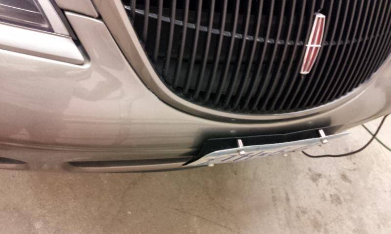

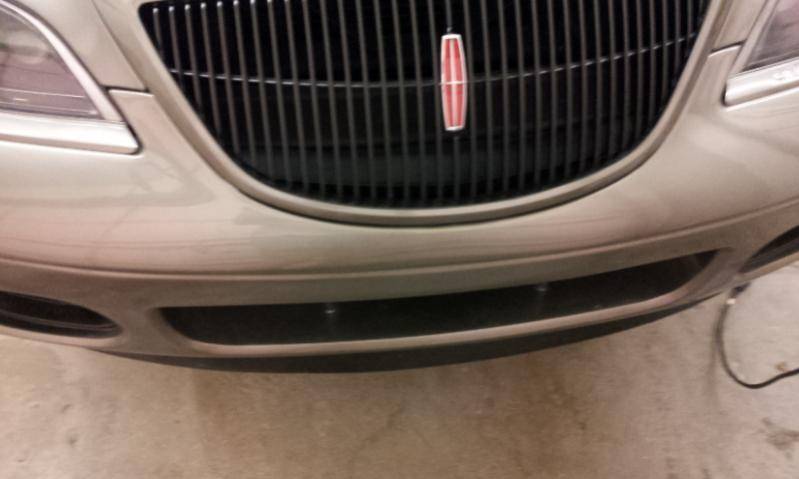

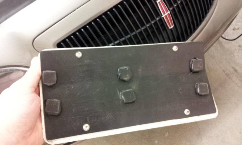

I realized I never posted pictures of my front plate mount.
I hate that mn requires a front plate and didn't want to drill holes in the bumper to mount it.
I mounted rare earth magnets to the backside of the bumper and made a plate to fit the front to hold the plate. The same magnets line up and hold the unit in place.
Each magnet has 40lbs of pull and I coated them in plastic dip to protect the finish.

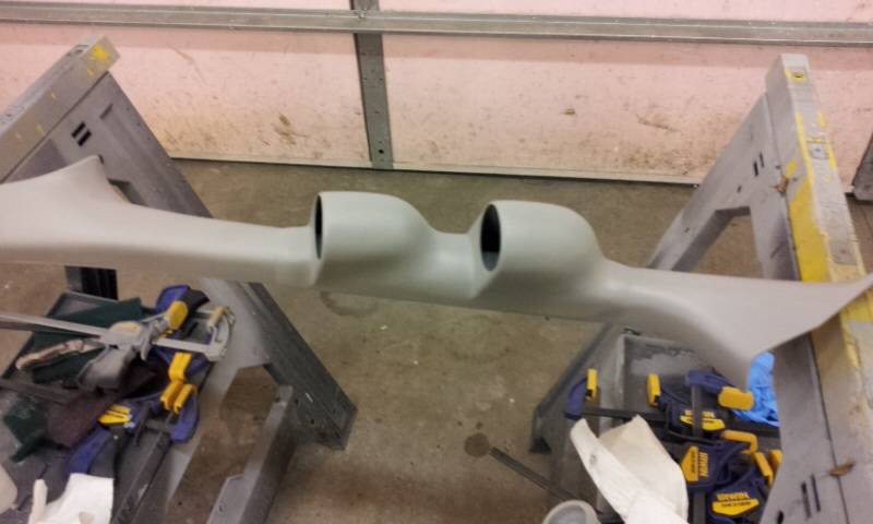

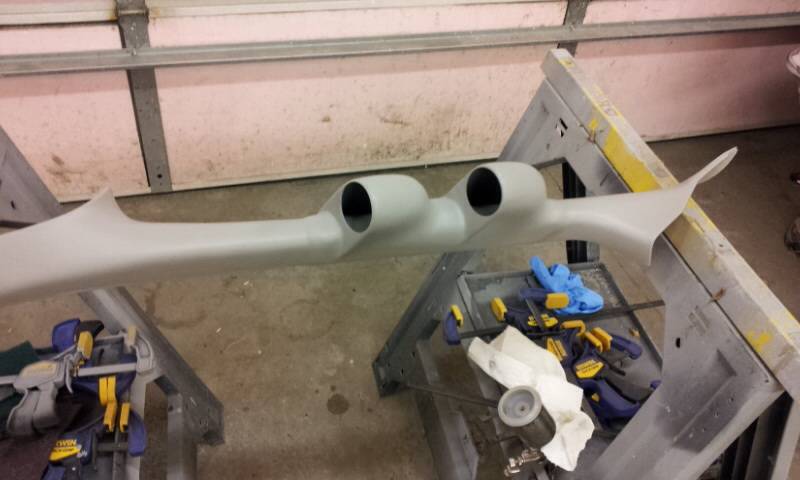

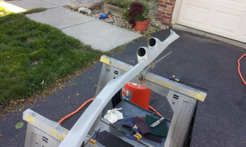

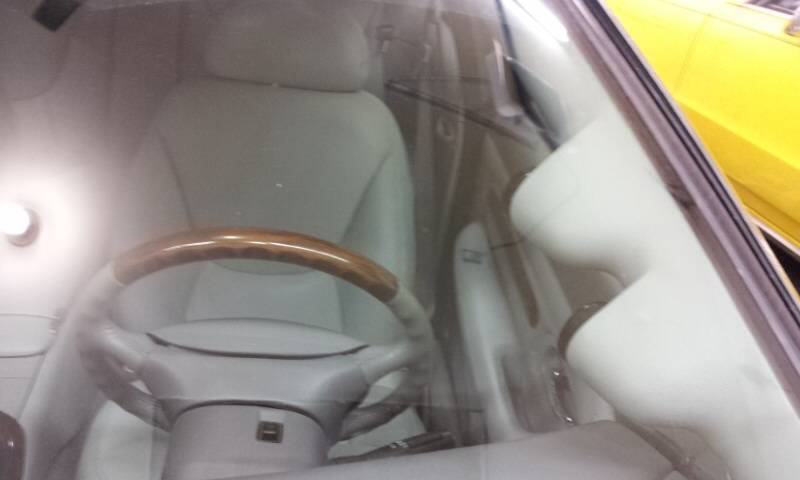

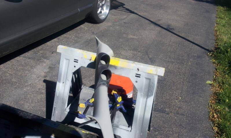

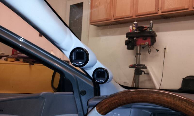

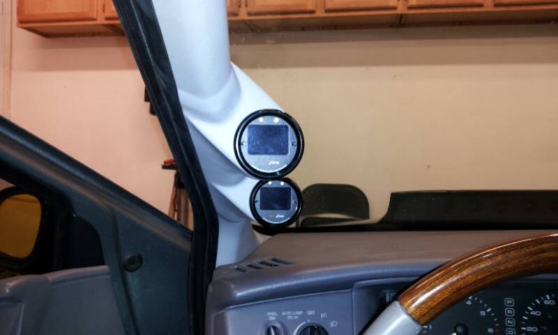

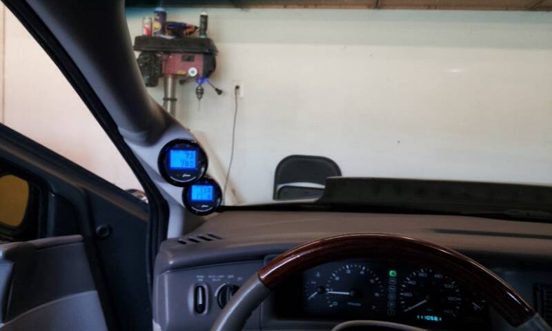

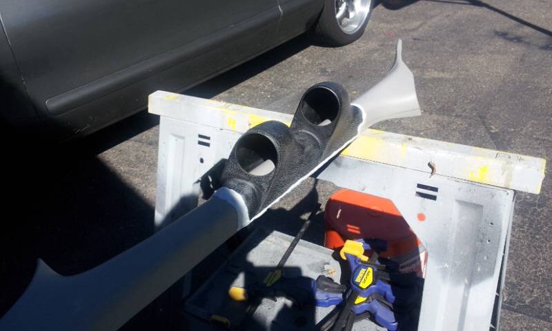

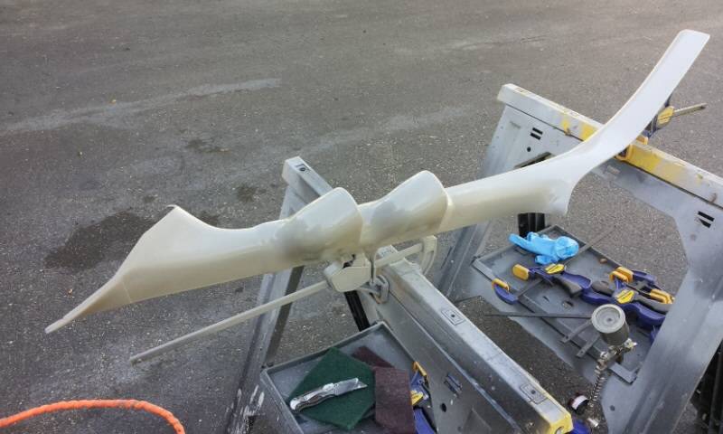

Had a few free hours last weekend, molded in a dual gauge pod and repainted the a-pillar with interior dye to match.
Loaded it with my dual gauge aeroforce set.
Here are some pics. I took a few while it was still wet when it was outside, ended up being a perfect match with the rest of the trim.
Awesome. those are sweet gauges. a lot of info off the OBDII.
