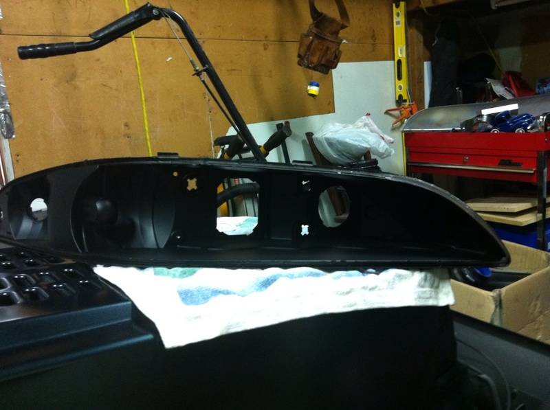

is that why you painted the inside black ? why not leave it mirrored?
I was going to paint the housings the body color but the factory had 3 variants in my paint code. It had to be painted or the vacuum mold for the projectors would have had to been chromed.
Could be done but im just not big on chrome plastic.

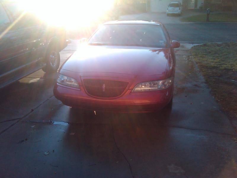

well i guess ill put a pitchur up of my work, although its fall less cool than the initial posters. a $20 3m kit, an afternoon later and waalaa:D

IMHO, chrome on plastic just doesn't last. The factory chrome on the housings is so thin if you rub it to hard with your finger it comes right off.
I cleaned every bit of it off the housings with soap/water and a scottch brite pad.
Like i said before, color match to the body would be a good option to the black. Silver paint maybe if you had to have it.

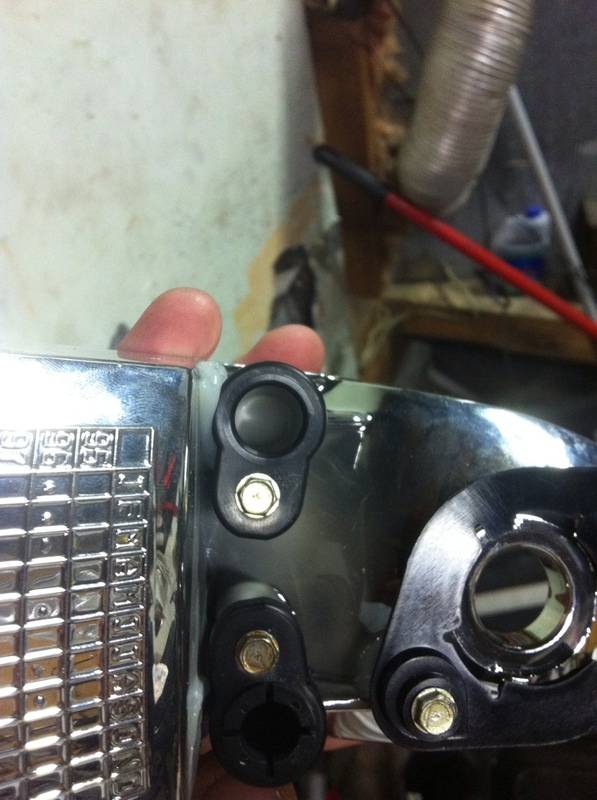

That's who I'm looking at using for mine. 97markJA how did you get the reflector back into the housing? I just painted he housing with the reflector out and tried to put it back in but the mounting point on the back of the reflector broke when I pushed the adjuster back into it. I'm not with the lights right now but if you need pics I'll get some tonite.
The adjusters only go on one way. One has 3 ears on the end and the other has two. If you had the rods swapped I think the shaft size is a little diff from one to the other. You push them part way in and fold the ears of the adjuster back over the rod then turn the rod a quarter turn. If you broke the adjuster off the back of the housing you might be able to epoxy it back on.
Pics would help.
But yes I pulled the reflector out of the housing.
r u talking about the orange reflector?
Here is what I've got so far this is way I broke trying to put the main reflector back in.
And yes I forgot to pull the diffuser over the turn signal, but it is now done.

unless your reusing the stock hid, you dont need the reflector even now that its painted black it has nothing to reflect off of.he used projectors. looks like youll have to epoxy if you plan on using it. the retrofit halogen to hid's dont use reflectors either, at least theonesi looked at.
those are the ball sockets that allow the reflector to pivot on the adjuster shaft. the shaft has 2 orings on it where it goes through the housing, when I did mine I put new orings on and put electrical grease on them.
you'll need to unbolt them and get new ones, maybe out of a junk housing. I dont think those can be fixed.
