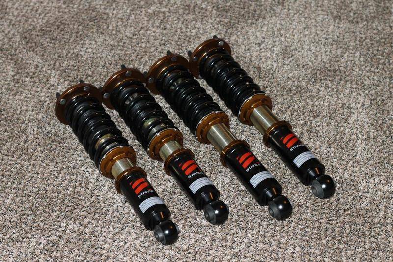

I picked up some new toys.
I've been playing around with the ride height and damping settings. I'm not going to be keeping it this low for practicality reasons. With them set to full stiffness you feel all the bumps but it corners really well. I also drove a bit with it on the softest setting, it feels like Eibachs or maybe a little softer.
