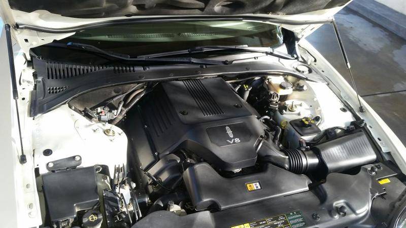

Dam your LS is clean under there. Nice work. Let's see lowered photos!
looking forward to some pics !

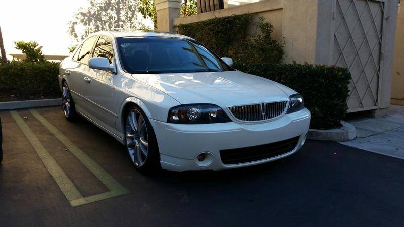

It's easy when winter consists of 3 days of rain in December!!!!! :p

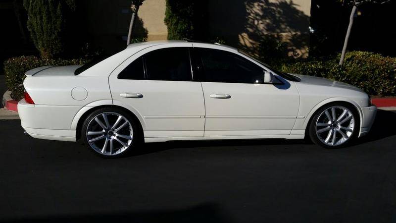

I actually raised her up from Eibach level - LOL - prob the only one who will do that! The Pics on prior page are essentially the current stance but I have removed the 1/2" rake.
It is easy to keep them clean in SoCal! Feels like it only rained a few days in the last year + but if we keep this up we are going to run out of water soon. If it comes to that, there will be no more car washes, and mine will be the dirtiest around:cool:

Had my Stance coilovers installed a few weeks ago and just went on a 900 mile road trip. I currently have them set on 1 in the front and zero in the back and would say at this setting the ride is slightly softer than on the Eibach's. Actually raised the car from prior Eibach level by about a 1/2" since I wanted the LS higher after buying the C7 as my sports car. There is a 1/2" rake on the car that I plan to remove after everything has settled. Also had the Senta knockoffs powder coated a slightly darker color from silver to silver gray. Very happy with the new ride as the coilovers control the 20" Senta's much better…felt rock solid at 70-90 mph in the AZ desert

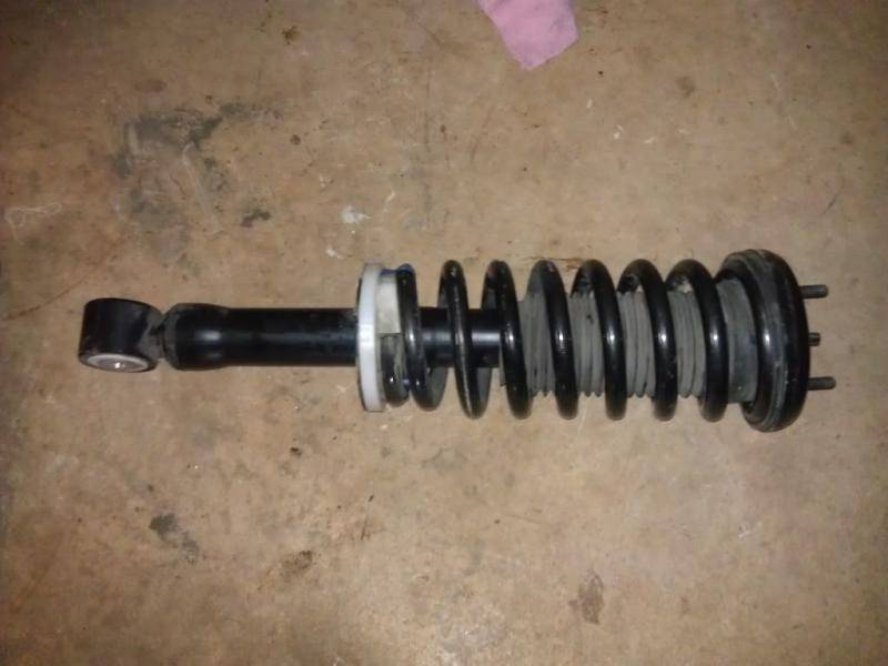

I just learned about the Stance coilovers, spoke with local distributor and can get a set of 4 drop-shipped to me for $1100. Yeah, that's less than retail but still a pretty penny. I've had issues with shocks for my LSes for a few years. Latest is when I replaced both front shocks on my 2000, I found the coil seat isolator - plastic white part - had disintegrated and no one seems to have a replacement. So I jury rigged with a piece of heater hose just to keep shock spring from banging on shock seat. Anyway the shocks I put in there were the sale ones ($12.95) at rockauto. Supposed to be OEM but I kinda doubt it. I would not recommend them. Yeah, I know, $12.95 vs $1100/4=$275 per is quite a diff. But I want to solve this problem once and for all.

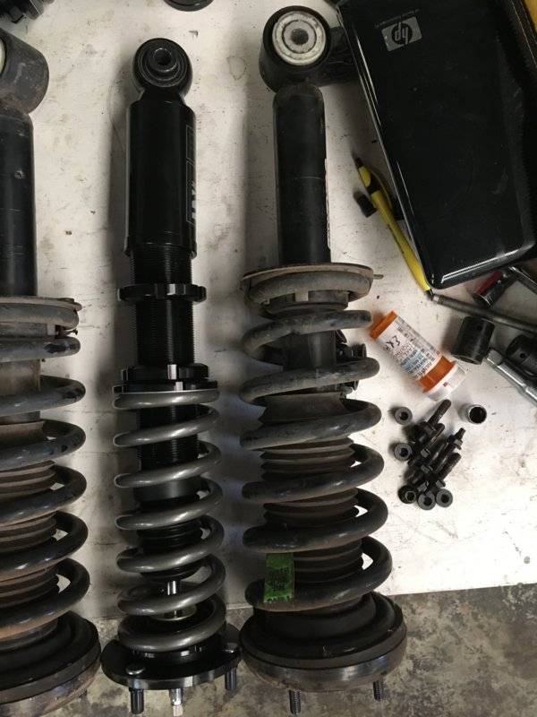

Dont know if there are any Stance users still out there. I hope there are. I've got a set and installed the fronts a few weeks back. No issues after I consulted Stance tech support on some questions.
Yesterday I went to in
stall the rears and ... BIG issue. The rear shocks are not long enough. See attached picture. Also they dont look nearly as 'beefy' as the OEMs. Gonna contact Stance on Monday but open to other ideas and suggestions before then.
The rears already had to go back for redrilling because the mounting hole was too narrow to pass the LS mounting bolt. Now this issue of being too short has me wondering if these were actually meant for a smaller vehicle? Oh - in the picture I've removed the lower part of the Stance so the whole thing might look the same length as the OEM but the lower part needs to screw at least an inch onto the shock part so it's at least that short.
