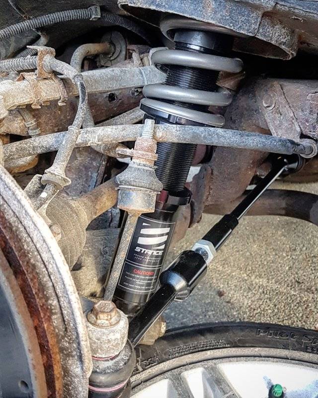

Yesterday I went to inView attachment 828567814 stall the rears and ... BIG issue. The rear shocks are not long enough. See attached picture. Also they dont look nearly as 'beefy' as the OEMs. Gonna contact Stance on Monday but open to other ideas and suggestions before then.
The rears already had to go back for redrilling because the mounting hole was too narrow to pass the LS mounting bolt. Now this issue of being too short has me wondering if these were actually meant for a smaller vehicle? Oh - in the picture I've removed the lower part of the Stance so the whole thing might look the same length as the OEM but the lower part needs to screw at least an inch onto the shock part so it's at least that short.
That must be the wrong coilover. Had zero fitament issues on front or rear. Also have never seen that color combo on a Stance set for an LS before (not saying that could not change) as all prior have Black springs, Gold threaded valve bodies, and Orange locking nuts. Not sure if he is still around but this guy was very helpful: John Kim "Sales Ambassador" 847-290-1568

The shorter shock allows for a lower than stock ride height before you begin fine tuning with the threaded collar. This also allows the shock to have more travel because you're not compressing a longer shock to get that lowered ride height. I know it doesn't sound logical that a shorter shock will have more travel but it does when you're talking in terms of a lower than stock ride height.
I suspect the shock bodies are of similar diameter and the "beefier" look of the OEM's is because of the larger spring diameter. Coilovers typically run about a 2.5" to 3" diameter spring but if you look it has the same number of coils or "winds" as the OEM and should have a spring rate stamped on them somewhere.

Well the first step in installing the shocks is to adjust the stance so that it is the same length as the OEM shock. That is impossible with the ones I have.
You could be right about the beefiness. I'm going to look for a spring rate ID on the unit. I'd like to know that anyway.

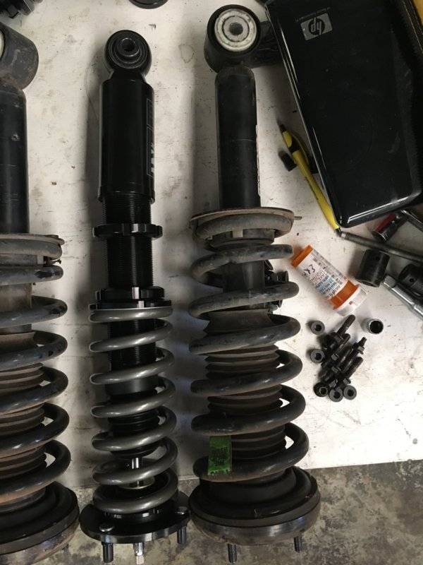

Meant to ask how the beefiness of your Stances compared to your OEMs? Anythin like the picture?

I dont really recall relative to the stock setup since I removed them years ago and had the Eibach Springs on at the time. What I do know is my Stance Front and Rears are essentially identical in dimensions other than the Rears are shorter in length. If I were to guess based on the pic alone I would say yours appear not only shorter but "less beefy" as well - but its just a guess. Also, I went to the Stance site and the XR1 listed for the LS application appears new (and the same colors as yours) vs. what I purchased years ago - new Part # ST-D98-XR1

Here they are, more pics to come. Bastards were supposed to send me a shirt too, didn't lol.
Did the rears today. Changed out the rear toe links with oem Ford too. These things feel awesome. They are much smaller than the stock shocks and fitment looked like it would be a concern, but they're much more firm so when the car sits they'e the same height.
I did this in a rush and am just looking for stock ride height now, I'll play with them over the next few weeks. Overall they feel great and so far so good. Highly recommend.
