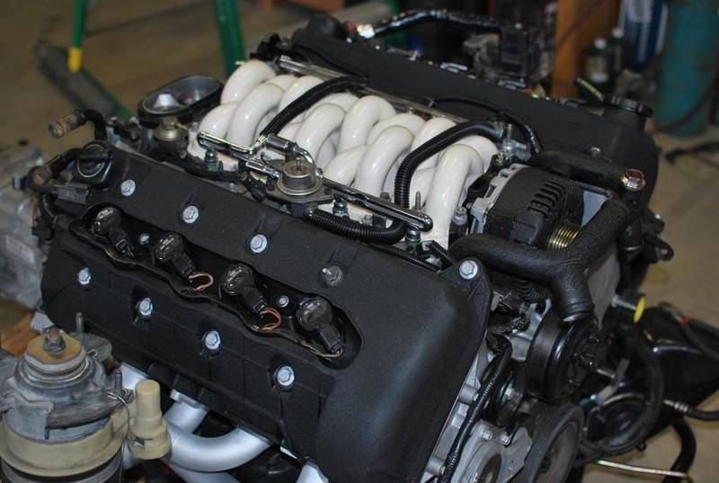

I like to put these pics up here so I have a frame by frame reference of a build. It also lets others see whats going on as well.

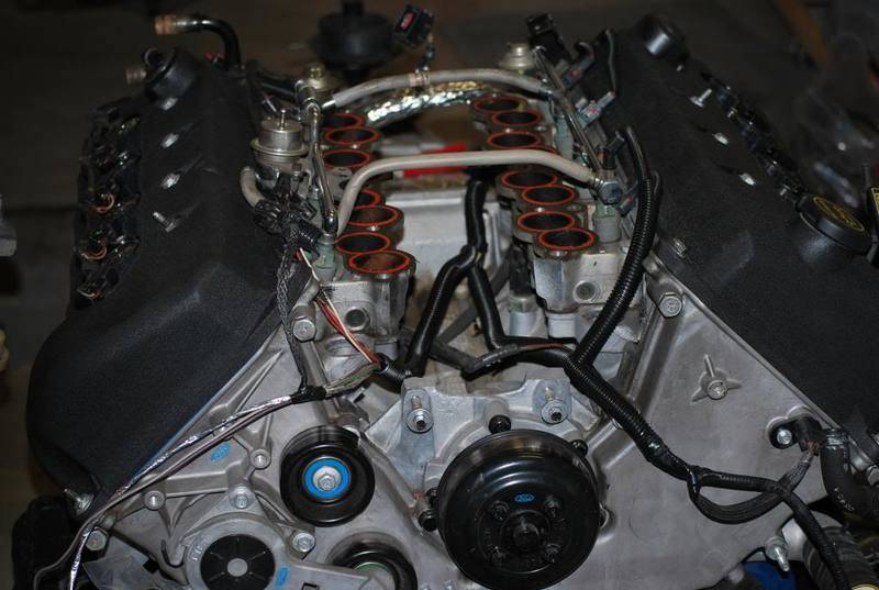

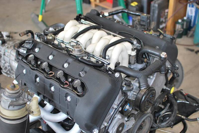

Small update, Started wrapping the harness tonight and getting it finished up so I can re-install the intake and get the damned thing installed in the car. (there is alot of work involved in re-running the harness)

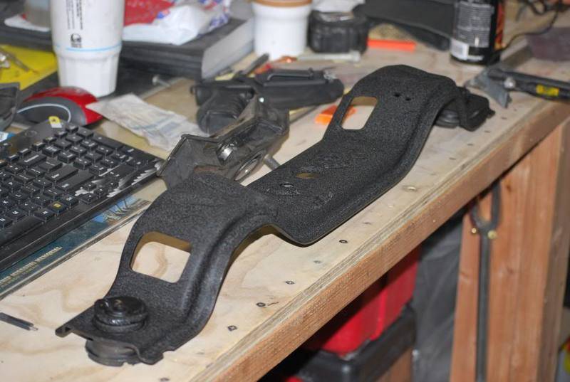

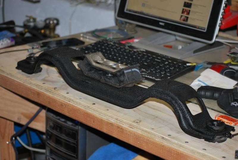

Trans cross member is done as well. (I went a bit different route than others have done by welding reinforcments in to stiffen/strengthen the X-member more than stock.) I can't say enough good about this VHT Wrinkle paint.... covers good, looks awesome, and seems to be pretty durable.
That's it till this weekend.

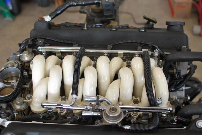

good progress mike, does the injector harness come out the front of the intake and loop around to the rear? just wondering why you didnt just come up from the back?

Even detailing the transmission crossmember, so is gonna be one of those care spinning over mirrors now :shifty:

Chicken, I'm hiding as much of the wiring as possible.
By routing it that way it keeps the loom size small.

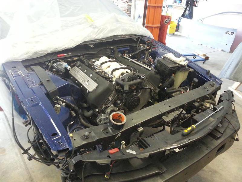

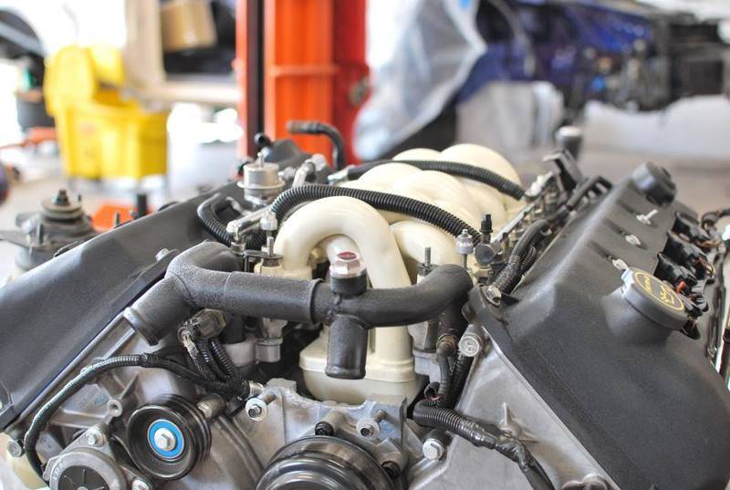

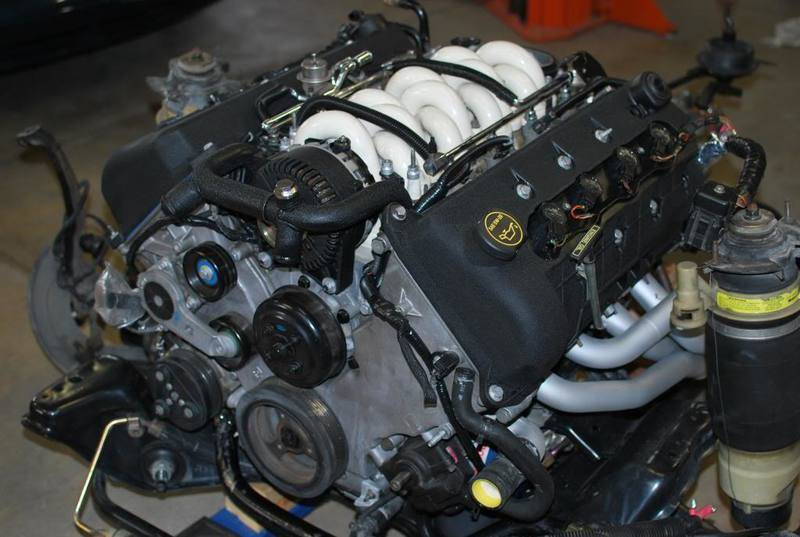

Wiring is done, and wrapped.
Also got the X-over tube and alternator done as well. I'm really happy with how the top end is coming out.
