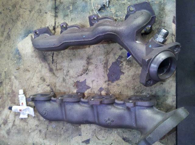

I have a pic of the manifolds I just bought on my facebook...

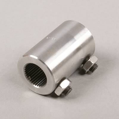

In the parts list in this thread, the coupler is listed as part 153-313434
It appears to only have a set screw on one end. That won't work, unless you weld the coupler to the shaft on one end and use the set screw to lock the coupler to the steering rack.
This part, FLA-FR1942 has two set screws...
Any thoughts from the guys that have done this?
Thanks!
I wouldn't think there's enough lateral travel to require 2 set screws??
The pictures are not correct, just generic.
The BRG-313434 or the Jeg's 153-313434 is the correct 2 set screw coupler.
Oh, and yeah, you definitely need one with two screws.
Thank you very much for that much needed info! I would not want any ability to have the shaft not locked, since the top of the steering shaft is a collapsible, that, IMO would allow the shaft to eventually wiggle out of the coupler.
I searched all over the interwebs and for the borgeson coupler, that is the exact picture they show on every site.
Thank you very much m_maker, that is exactly what I wanted to know!

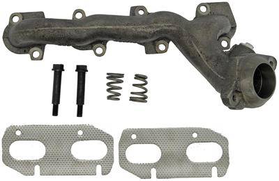

For whatever reason, original ford units don't use the springs and bolts. I called my local ford parts guy who can find or tell me anything said he just sees the studs like normal. Idk. I bought the dorman stud kit, and that's what I will be using.
