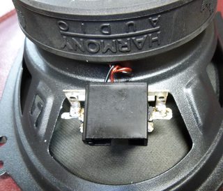

My 97 had a bad right rear 5x7 JBL so it was time for replacing all of them. I have the premium JBL syatem in the car that includes the upper door tweeters. I wasnt looking for a big up grade, just decent modern replacements that I found in HarmonyAudio.com . I replaced the 4 factory 5x7's with the HA-C68's and the 2 door tweeters with a pair of HA-C35's as suggested at the web page. The 5x7's are drop in and were pretty easy to convert to using the factory wire connector. I sniped the wires off on the old speaker connectors and un clipped them from the speaker frame. Then snip off the plastic frame guides under the connector for clearance on the new speaker as you just solder it in place. The polarity of the connector box will match the polarity of the Harmony speaker just as pictured.
On the 5x7's in case you need to know the polarity, the right front and right rear 5x7's match wire colors and are BK/LG is Poss while the Bn/Pk is Neg. The left side 5x7's are PK/LB =Neg while LG/W is Pos.
